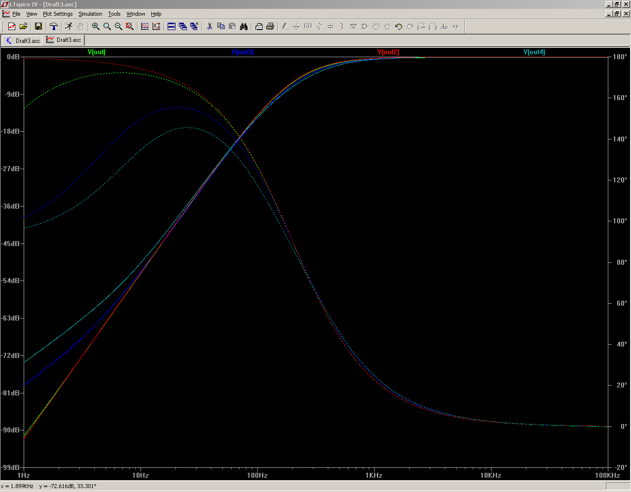

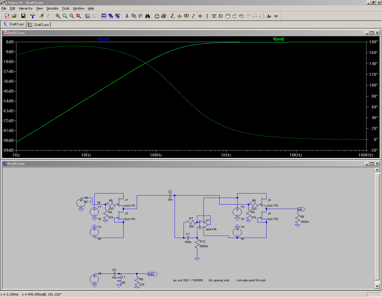

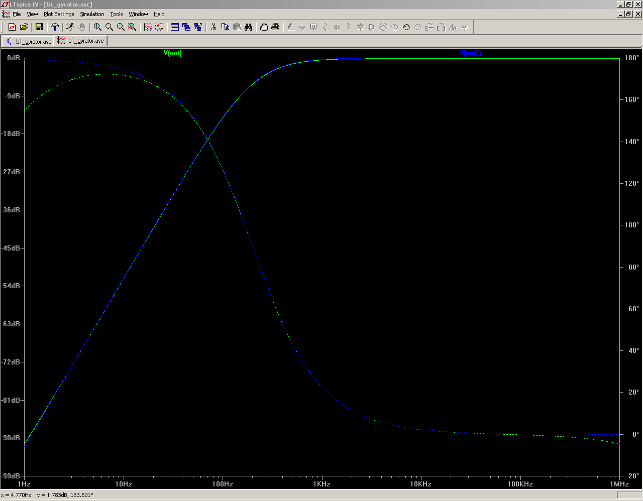

Well I've done a lot of reading, brushed up on my algebra, played with ltspice a lot, and finally modeled something that I think might be workable. My planned crossover freq is 200Hz. (which seems to be right as the curve is down just over 6db at 200Hz).
Screen shot of the results of comparing an opa134 based gyrator to a passive circuit with a capacitor and real inductor. both curves are almost identical so I think the circuit is working as intended ;) (note the phase droops at the low end due to the effective series resistance of 100 Ohms in the simulated coil, something that I added as a parameter to the "real" coil to get a like for like comparison)
Now I guess I just have to get round to actually building one!!! but at least this is some progress....
I've also attached the ltspice file of this model in case anyone is interested :)

did you say you added 100r as the resistance of the real inductor to make it match the gyrator?
Am I also correct in assuming that since this is a high pass 200Hz that the error that becomes measurable <8Hz will be completely inaudible?
Is it also correct to assume that since the 134 is in the simulated inductor path, it has virtually no audible effect on the passband signal?

Hi Andrew, I'm just learning so I can't answer with authority, but here goes:
yes I added 100 Ohms as the series resistance in the "real" coil's parameters in spice. Attached is an expanded plot with the "real" coil having a series resistance of 1 Ohm (which is probably lower than possible for a 35H coil!)
The error actually starts quite a bit earlier than 8 Hz but at 10Hz it is only about 3 degrees... at 20Hz it looks like about 1 degree, so I guess effectively yes the error should be inaudible :)
I've read a fair bit about FDNR (this gyrator is like one) circuits in the past, and whilst some claim that they aren't in the signal path, others disagree, but I suspect that the effect will be lesser than if the signal was actually passing through the opamp.

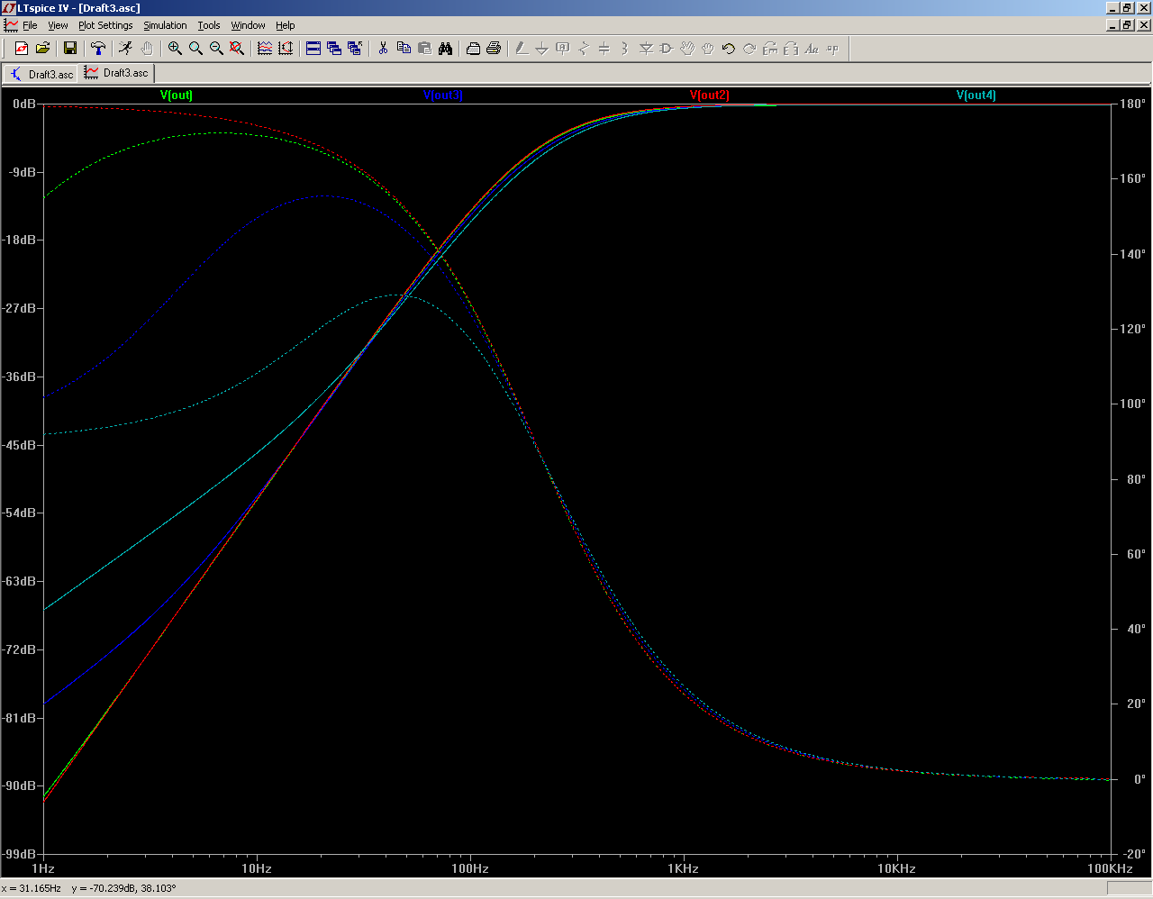

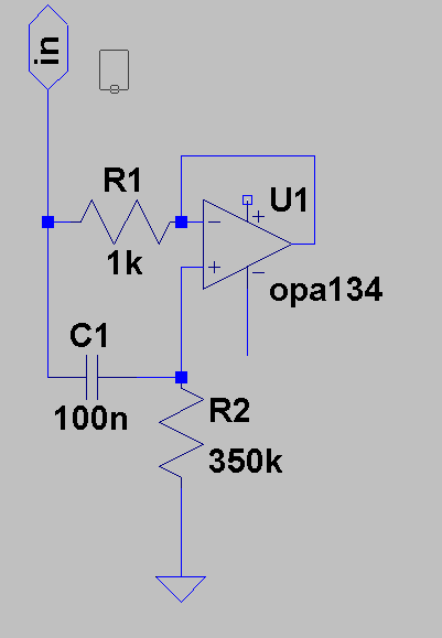

The simulated inductor cannot be made with high Q, since the value of R1 cannot be made low enough to allow a Q of more than about 10. This is due to the limitations of the opamp - a minimum value of 100 ohms is usually specified for R1, although lower values are sometimes used. This represents a series resistance (equivalent to wire resistance in a real inductor.
So I decided that if Spice thought it would work, it was worth having a crack at. I've attached an image of the difference with differing values of R1.
The red trace is an "ideal" inductor with series resistance of 0.1 ohms, which is effectively unobtainable for a 35H coil.
the green trace is with 100 ohms for R1
the blue trace is with 1K for R1
The turquoise trace is with 5k for R1
other values adjusted accordingly :)
changing the series resistance on the passive L in the simulation to match the value of R1 gives identical results to the active circuit.
So me being the performance tweaking type that I am I wanted to try and ring every last drop out of the circuit and decided to try for the 100Ohms..
the 1K R1 is very good with respect to the freq response tracking the ideal inductor (down to about 10Hz) but the phase is off quite a bit, so if I cook the opamp with 100R then 1K would probably be an ok compromise. The error introduced by the 5K I felt was unacceptable.
I also attached a pic of just the gyrator part of the circuit for anyone scratching their head saying what is R1 ;)

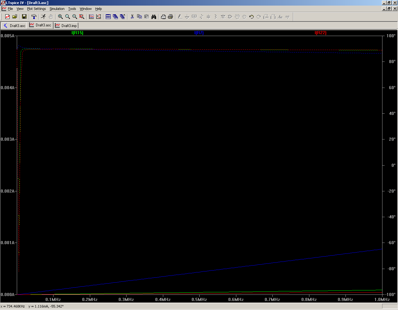

ok I've measured the current flowing through R1 in spice. Not sure if I've done it correctly though because it is VERY low.... It does go up with increasing freq much more with the 100R R1 but the max current is around 1 milliamp at 1mHz and 9ma at 10Mhz, I certainly hope I don't have any 10Mhz and even if I did I think the opamp will handle 9mA :)
Doing an fft on it gives me a very different result of 560 Kilo Amps, so I'm going to assume that it wasn't an appropriate measurement ;) I think I'll have to read up on what the fft is for!!

Tony,
Surely you know what you are doing! I am only a skeptical and critical guy and am very conservative. Until lately, I have never been able to get the opamp rails not resonate - the inductive output of line level regulators due to limited open loop gain, the wire inductance and the input capacitance of opamps usally cause ringing, adding high Q film local bypass capacitors introduces a whole new set of problems. I could only solve those problems with the help of an oscillioscope. Opamps do not have high PSSR at high frequencies. So I have seen a lot ripples from 2MHz to 25Mhz in reality. Although completely out of the audio band, they affect the sound significantly.
Bill
