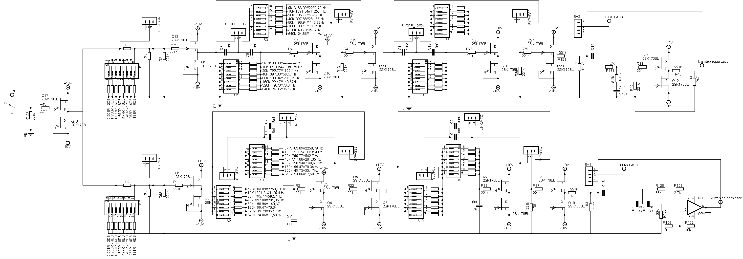

B1 crossover
A big !thank you! goes out to the Master Nelson Pass...
We can add a third way, plus Notch filter, plus Delay correction... with some help with opamps or a discrete opamp...
I've not skills to understand everything in your circuit but it seems to me that almost everything has been discussed here is in!
Is it your design or... is it by Nelson Pass?
...waiting for most wise comments than mine...
I really like the adjustability of this design. I too am curious if this is Nelson's B4 or your simply your own implementation of similar adjustability to the B1 design discussed so far.
Everything starts here: http://www.diyaudio.com/forums/pass-labs/153447-two-b1-crossover.html
plus B5 crossover, last 10 years listening to open baffle plus Pass amplifiers... and based on B4 manuals and Linkwitz site there is nothing else need it! (Elliott diy also)

I'm sure that you have thought of this, but a 6dB followed by two 12 dB XO with options to by-pass ala the B4 could yield 6/12/18/24 XO and make everyone happy. I also really like the switched level control for attenuating either the high or low pass signals as implemented in the B4 as it is true you only need to attenuate one of the two, but may not know apriori which one. Of course, the resistor switching for frequency adjust is pretty neat too.
So the real question is how long before we see a group buy for boards?
Joined 2006
That's the thing. I am not settled we are there yet.
One board that has all those items and (three types in a row).
I am not certain Prooptki stuff is tested or if the source goes against any of Papas classified work. But either way, I think easy DB and xrossover frequency switches are a good way to go. If you are uncertain, play with then, and if your hard against them, fine to tune then remove and put in a hard resistor.
This board will need to be prototyped first by me and someone else who builds fast. It's not a simple circuit, but eagle eyes and a well known understanding of the design can avoid problems.
Buffers and Power supply duties will need to use existing Salas boards.
