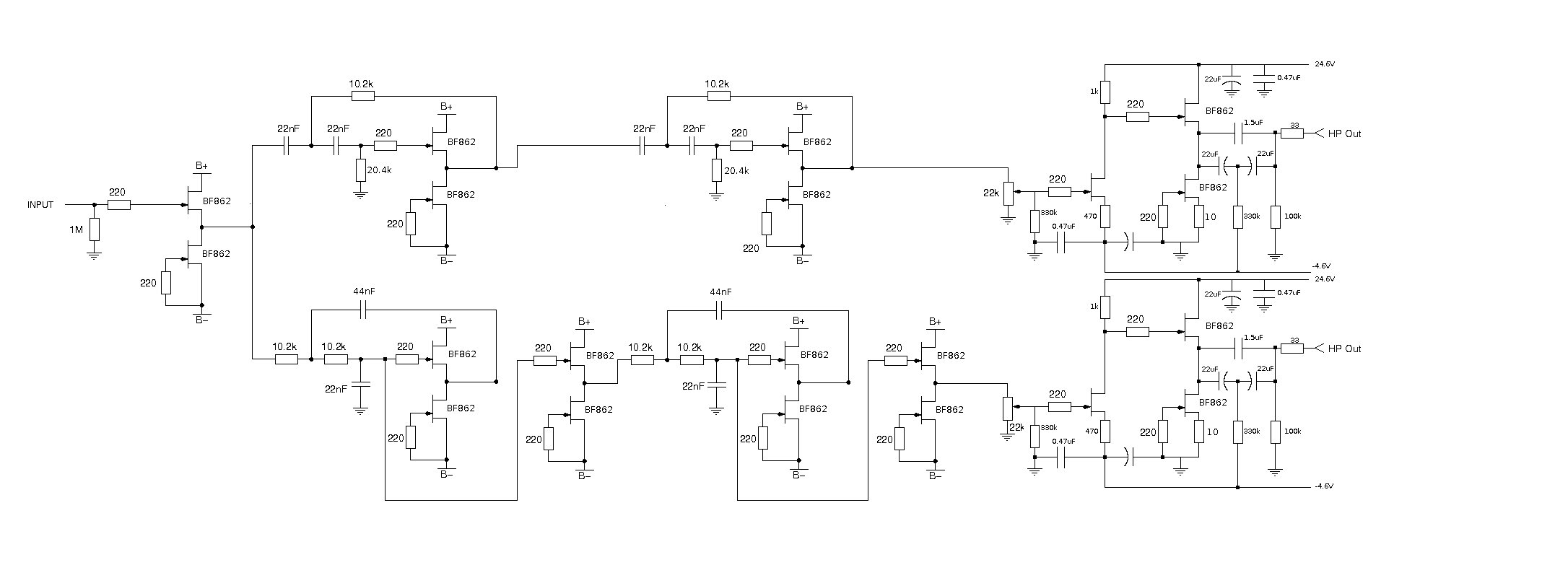

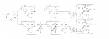

Hi Everyone,
So here's the schematic with (I hope) the corrections Jacques and juma mentioned above. If anyone spots anything else wrong please let me know.
I have some technical questions (again). The buffer circuit I've put in is (I think) the one juma suggested, derived from the one he posted in post #69. I've been scratching my head over some stuff related to this, and I'd be grateful if someone could tell me if I've understood correctly 😕:
(juma: I hope I've learned something since the last time you helped me with this stuff!)
1. If Vds, Vgs and Vp are the drain-source, gate-source and pinch-off voltages respectively, then as long as Vds > Vgs -Vp the jfets will be in saturation mode. Looking at the lower BF862 in juma's circuit in post #69, Vp is around 0.8V and max current is Id=40mA, so if we suppose the trimpot is set at 10R (and current entering the gate is zero) then Vgs = 10*Id is no more than 0.4V and Vds =10- Vgs, which is close to 10. So it's in saturation mode, and we can calculate Id by Id=Idss*(1-Vgs/Vp)^2. Taking Idss=13mA (which seems to be typical), I get something like 10mA.
2. This means the upper jfet is passing the same current. (Or nearly so, right?)
3. So each jfet has to dissipate around 100mW. (Approx. 10V * 10mA)
4. If we do the same calculation in the buffer circuit I've posted, where there are no source resistors, we have Vgs = 0 , and we should get Id=Idss, so about 13mA. Up above Jacques suggested +/-9V for B+ and B-, so we would get about 9*0.013 = 0.097W to dissipate, in other words about the same.
So, taking into account that we now have a total of 20 BF862 devices in the circuit, this is a total of 2W to dissipate, which should be OK as long as the jfets aren't all crammed in to too small a PCB. Now, on juma's preamp thread he uses adaptor boards which don't seem to have more than about 1/2 sq. cm of copper on the gates, whereas on the mini-aleph-J amp he helped me on (http://www.diyaudio.com/forums/pass-labs/152379-mini-aleph-using-bf862-possible.html) each jfet was producing about 190mW, and trial and error (!!) showed that a fair bit more was needed (and they still get pretty hot). If I allow about 2 sq cm of copper on the boards for each jfet, does that sound like enough? My best guess is yes, it should be OK, but I'd like to hear opinions, since it's much easier to design this on to the boards than to fit something in later...
Thanks in advance for any help.

do you really need the 22k pot in the upper (high Pass) filter? It loads the previous stage.
You do not need the the biased electrolytics in the output of the HP stage.
The bass (low pass) looks OK.
Does the second last FET set the correct DC voltage for the single supply last FET?
The four 22nF in the HP should just about fit an 8pin dip header.
The six 22nF in the LP could be fitted to a 14pin dip header or to a pair of 8pin dip headers.
They it's easy to swap 15nF, 18nF, 22nF, 27nF for coarse frequency selection.
Hi Guys,
With regard to the 22k pot in the HP filter, I can see AndrewT's point, but let me ask (as a practical question rather than a theoretical one) if you put the trimpot in the LP section and not in the HP section, and then find the HP section is too loud (say because you have much more efficient tweeters), then how do you compensate? You could always deal with the problem by choosing a stronger power amp for the LP, and turn everything down, I suppose, but that seems inefficient, and how would that compare to (say) putting a fixed 10k resistor in the HP section, so that the LP section can be adjusted up or down relative to it? At least putting a fixed resistor in the HP should be better for distortion than a trimpot (which R-K Rønningstad mentioned), but (of course) it would load the filter in the same way, I suppose. Is there some standard solution I'm not seeing?
I'm sorry, Andrew, I don't understand the question.... The last buffers (after the trimpots) are copies of juma's preamp schematic. I'm treating these things like lego blocks and trying to understand things as I go along. Maybe you could rephrase?
I'm not sure I understand what the biased electrolytics are supposed to do, so I don't know quite how to judge your suggestion to take them out. If I do,
do I replace them with direct connections, or take out the 220k to the negative rail also? (I guess the second...)
I like your ideas about the dip sockets and headers, but I am going to try and standardise on one size... Still some thinking to be done there.
No-one pointed out any errors in my calculations for the lower jfets in the buffer - does that mean understood correctly? - Anyone willing to risk a guess as to whether the cooling I suggested is enough?
Well, as always, thanks for any comments
Nigel
...Does the second last FET set the correct DC voltage for the single supply last FET?...
No one can claim he does, but let me try to guess.
We are speaking about the preamp (three most-right JFETs in your sch.). The first one is the voltage amplifier (we'll call it Q1) and Q1's Drain is on the +12 to +14V potential (roughly half of the +V=24V). Q1's drain is connected to the Gate of the Source Follower JFET (we'll call it Q2). That's the right voltage to allow maximum voltage swing of the preamp (see B1 - it also has it's Source Follower's Gate sitting on the half of the +Vc).
If this doesn't answer the question, please mark the parts in you sch. Q1 - Qn, ... R1 - Rn ... C1-Cn etc.. and let Andrew rephrase the question more precisely.
Biased ELKOs are two ELKOs on the preamps output which are polarised to -4.6V. I do it because I find that if used that way, ELKO's leave minimal sonic imprint when used as coupling capacitors. Of course, single 10uF teflon film cap is a better solution (if you can afford it) and the capacity of that cap depends on the next stage's Zin - for HP output it can be very small - you are making a filter after all, right? 😉

Noone can claim he does, but let me try to guess.
Your explanation makes sense to me, but in any event, I will post schematic with labelling on everything, although it's a little late tonight.
I understand the value needn't be large on the HP part - I presume a 10uF (or whatever size) would just substitute the 1.5uF shown, right?
So did my post #82 make sense? (I scratched my head over it so long I'd really like it if someone would tell me if it's wrong... 😕)

Of course, single 10uF teflon film cap is a better solution (if you can afford it) ...
A Hovland might make a somewhat more economical choice here, too. Something of a middle ground solution 🙂. By al means size them sensible based upon the
That buffer you added to the LP section was what I meant. I'll take a closer look at the last schematic you posted and comment. I just didn't get a chance today.
WRT the earlier comments about which pots, etc., you may or may not need -- if you are laying out a PCB may I suggest that you leave them in. That will provide the maximum flexibility for any future systems you may wish to use the board in. You can easily leave any unneeded components unpopulated and use jumpers to make the connections. Likewise, once you have arrived at the final attenuation figures you could replace any remaining level setting pots by a fixed resistor divider.
I understand the value needn't be large on the HP part - I presume a 10uF (or whatever size) would just substitute the 1.5uF shown, right?..
The value of coupling cap on the output of the HP part depends solely on the next stage's Zin. If your next stage is F5 (with 101k Zin) 1uF will do.
That 1u5 cap is a bypass over the polarized ELKOs (I use Siemens stacked foil).
Coupling caps are subject of many debates. Everyone has his favourite solution, this is mine. Feel free to experiment.
Juma's explanation of how DC is handled is OK.
The HP filter with the existing 22uF+22uF//1u5F gives an equivalent 12.5uF and that has a f-3dB of 1.3Hz into a 10k Rin amplifier.
That is good for a true sub-bass amp. Probably too low for a bass/mid amp and plain unnecessary for a mid/treble or treble amp.
The 1u5F alone has F-3dB of 11Hz and allows all frequencies above 100Hz to pass. This would do for a mid driver.
470nF (F-3dB=33Hz) would do for a treble driver that rolls off >=350Hz.
The two back to back electrolytics with the biasing resistor from -ve, are only needed for low bass or sub-bass drivers/amplifiers.
The treble driver and the bass/mid driver and the low bass driver all have different requirements for Vpk and Ipk. Each amplifier should be selected or designed to meet that Vpk & Ipk requirement to deliver the required SPL at the listening position. This demands different amplifiers with different voltages and different currents and can easily have different gains selected to suit the different drivers. An attenuator adjustment on the treble filter is simply a waste.
BTW,
Rin=100k will lower the coupling cap frequency a full decade compared to the example figures quoted above.
Yes, a 22nF coupling cap and 100k for Rin allows 750Hz to pass unhindered.
