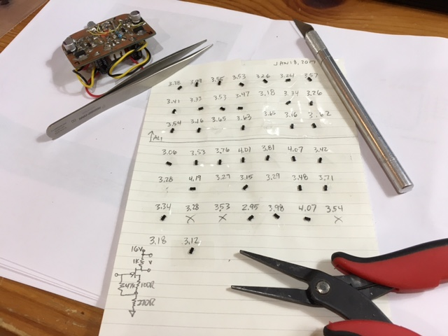

The BF862 can take 300mW and up to 20v. I find that SMT parts dissipate heat better as they are in contact with the board. The legs themselves actually conduct quite a bit away onto the PCB. I have exchanged BF862 and 2SK170's on several projects with great results. Basically interchangeable for all intents and purposes. And you can buy a reel of 100 for not much money.
Here are a bunch matched using jig that represents tbe actual circuit it will be used in. Or in-situ matching for Idss.

As for matching, normally I would use several times published simple circuit, both by Mr Pass and Mr. Borberly, but very good idea to use actuall circuit!

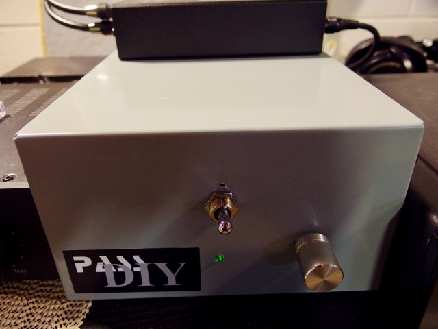

just finished B1
Finally got a break and completed my DIY Pass B1 as my 4th diy electronics project.
I used the smallest Hammond enclosure that would accept the power caps height ,which made it a little bigger than I would have preferred. The long chassis sides seemed a little thin for the input and output jacks so I used the shorter depth side for mounting . The downside is I had to make the wiring a little longer to facilitate the top getting attached.
On my last project , the Folsom chip amp, I used stranded hookup wire, but this time I used solid copper insulated bell wire from Home Depot and soldering was better for me. Reading Nelson Pass's blog page on soldering helped me too.
The input caps were a bit large for the board so I mounted them on separate boards to anchor them. The switch selects either channel one or channel 2 input, but no off position so I may have not ordered the correct switch from digi-key . The unit is in the basement exercise area so it is always shut down at the power supply when not in use anyway . I included a CD to show scale .
DACT knob is salvaged from a DOA tank like Toshiba cassette deck someone gave me.
So far I'm very pleased with the "sound" performance of the B1 in the setup and already decided it would be a good thing to build the next Mesmerize version for my main listening room.

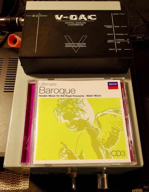

Source is either a TASCAM CDPlayer-200 or Mac Mini > to Schitt Uber Bifrost DAC feeding either a Jolida 202 tube amp or a Nuera Class A SET amp .
In the basement it is a Sony CD/DVP-S360 player to a Musical Fidelity V-DAC ver. I feeding a Audio Source Amp 100 ( upgraded with better components by Tyger )
