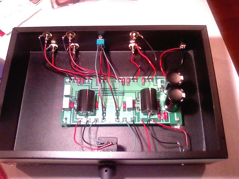

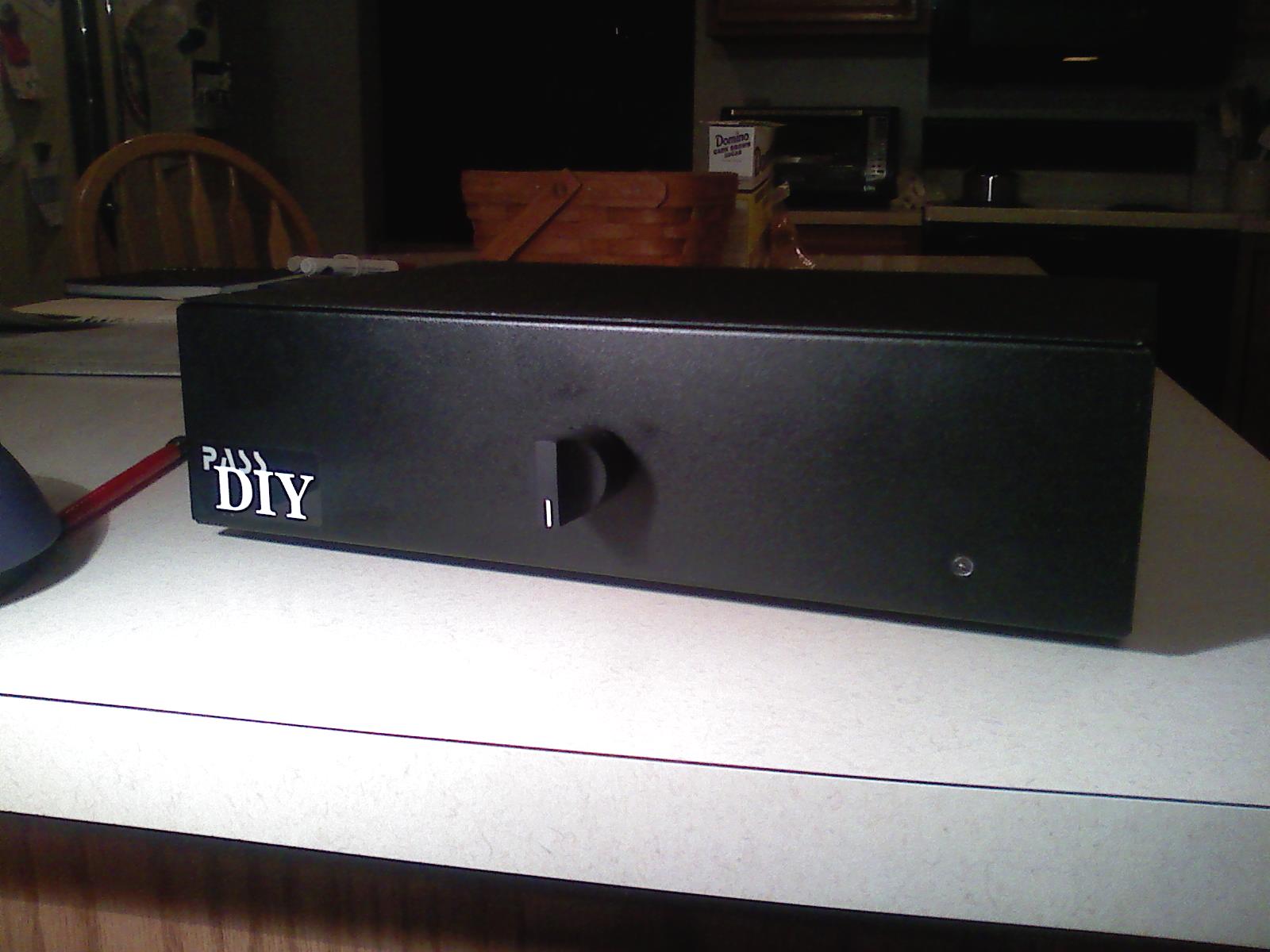

Completed the B1 last night. Hooked it up and enjoyed the music. My VA super pass is on the market as well as a few other diy pre's. Paired up with a chipamp clone from BB. Of course jamming at 11:30pm did not make my wife very happy. Pictures to follow later today.
It looks great. I am guessing something like a Hammond enclosure with some black BBQ paint.

Hmmm, what kind of box is that?? I would use one of them.
To me it looked like a fiber optic termination / patch panel box used in telco.
But I may be wrong.
