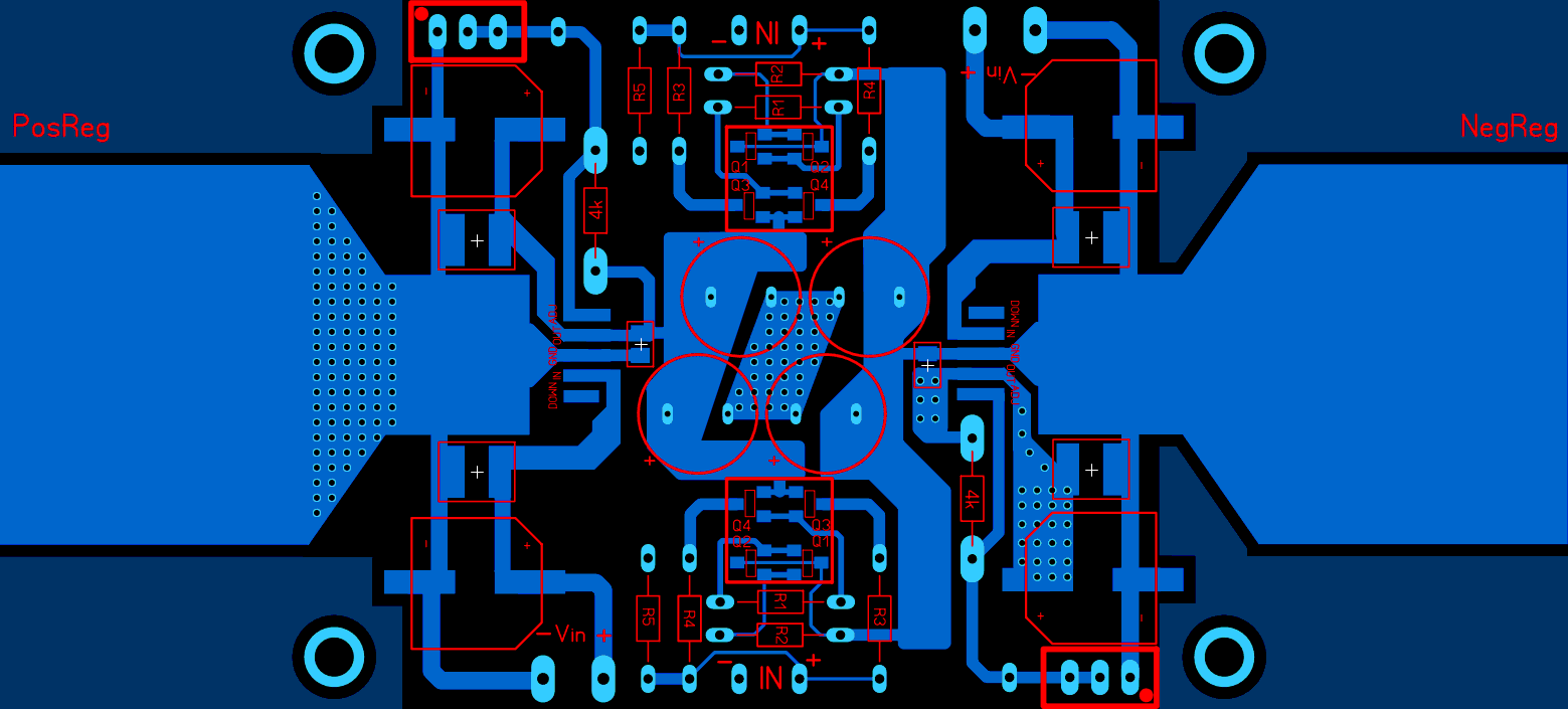

I've always wanted to try this buffer. I dont know why it hasnt picked up more traction but there's a sale at the pcb house and a customer wants a buffer. Sounds like a good time to see what I've been missing.
The board is 132mmx59mm. It stacks on top of my attenuator boards and therefore the size and a few restrictions.
I am posting my first shot at laying this out and already there is a change not shown in the pic. Patrick suggested to use 0805 200R gate stoppers and I was using 1/4w leaded resistors as I love the sound of RNC55 and RLR07 from Vishay/Dale. So I will have to adapt to the 0805. A bit of moving around from what I've got so far. If youre looking for outputs, theyre not there yet.

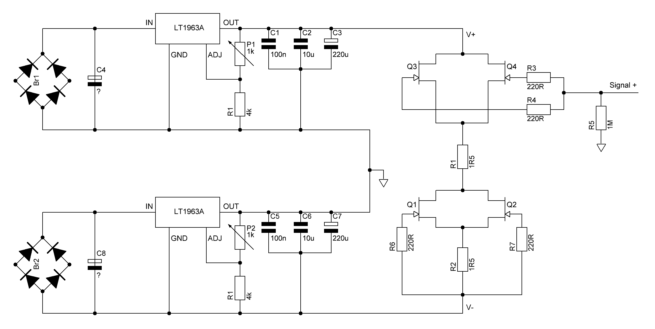

I'm using LT1963A as positive and negative regs as output voltage from a dual secondary transformer fed supply. Transformer, rectification and a few smoothing caps are off board. I am using the regs in adjustable mode as I saw there were a few comments in the thread regarding voltage maybe causing changes in THD and oscillations a member was having. The board is only labeled for me so many of the components arent labeled. If you're interested in the supply the large SMT caps are 220uf 20V Oscons, large ceramics are X7R 10uf and then at the output to ground pins of the regs there is a .1uf that seems more necessary than I had suspected. The 4 caps in the center are 1000uf 25V Nichicon KW. JFETS and resistors in the buffer circuit in the center are labeled according to Patrick's schematic with the addition of R5 to ground which will probably be 200k to 1M. R5 is shown but you cant see it connect to ground as I have the ground layer turned off so you can see the rest of the circuit. Anywhere you see a bunch of tiny holes, thats a connection from the top plane to the ground plane. I might show the whole schematic later but its not on paper yet. Well, here is the board:
If you could place inputs together at one side and do the same for the outputs wiring will be less messy and input/output and power supply wires won't cross. If you add pads for rectifier diodes you can reuse the design another time as it will be more versatile. Just leave the parts you won't use unpopulated for this particular customer. On the risk of being called a "repeatist": I would definitely use a very tiny muting relay that shorts the output to GND at power up for a few seconds as you know what customers do... just a day after you told them not to do so they first switch on the power amp and then the preamp/buffer... This circuit does give a plop when powered on. Not a good combination with a hefty power amp (probably/likely with no volume control at its inputs). You can use the tiniest of micro relays for this task and they only use a few tens of mA. Small and cheap addition that can save the customers woofers.
It won't hurt to use CLC or CRC filtering before the regs.

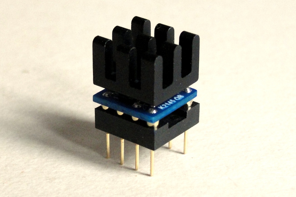

Dual JFET Follower Buffer on DIP8
A few months ago in November, we did a modular active crossover for various speakers.
https://www.diyaudio.com/forums/ana...ve-crossover-filter-solution.html#post5591077
This renews the need for a discrete JFET Follower buffer, but this time 2 channels on a DIP8 footprint.
In October 2018, we also compared the distortion of NJFET followers using different devices.
https://www.diyaudio.com/forums/pas...source-follower-applications.html#post5583280
This leads us to design and build a new module using 4 pairs of matched Toshiba SMD N-JFETs.
Total current consumption is 15mA.
The heatsink is not strictly necessary, but it helps with thermal tracking.
DC offsets can be trimmed with source resistors.
The prototype shown here has offsets 0f 0.9mV and 1.3mV, and are stable over time.
So no need to use opamps in unity gain in those active crossovers.
