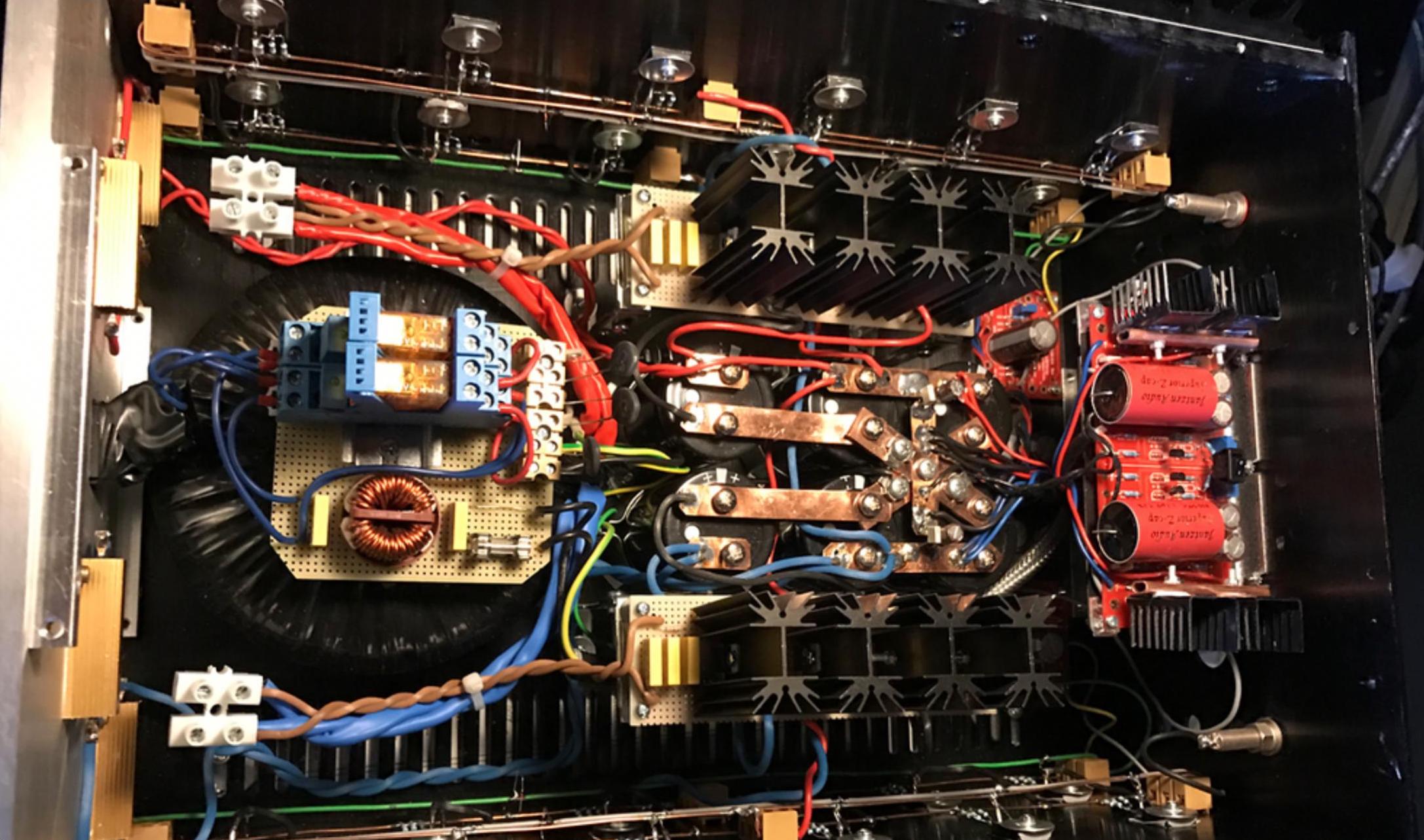

I did build the Single Ended BA3; 6 deep output stage biased at 4.5 Amps.
2x22.5 Volts. 3x 47 mF per rail, 1200 VA transformer (see pic)
Very stable, sounds great and 55 C on top of fins.
Switchable to run 2x25 W or bridged/balanced 100 W mono block
(using BBA3 FE)
/Mats

Thanks Jeff.
Well, perhaps not the most beautiful way, but allowed me to spread the heat evenly (and there is lots of heat) over the full ~20 inches of the sink.
Using tightly stretched 1.5 mm2 solid copper wire (approx AWG 16) as a "drain line" and "source line" and a thinner "gate line" from where a total of 24 gate resistors are dropped to each IRFP240.

Dunno mate, looks a heck of a lot better than most of my efforts do!
Nice work.
