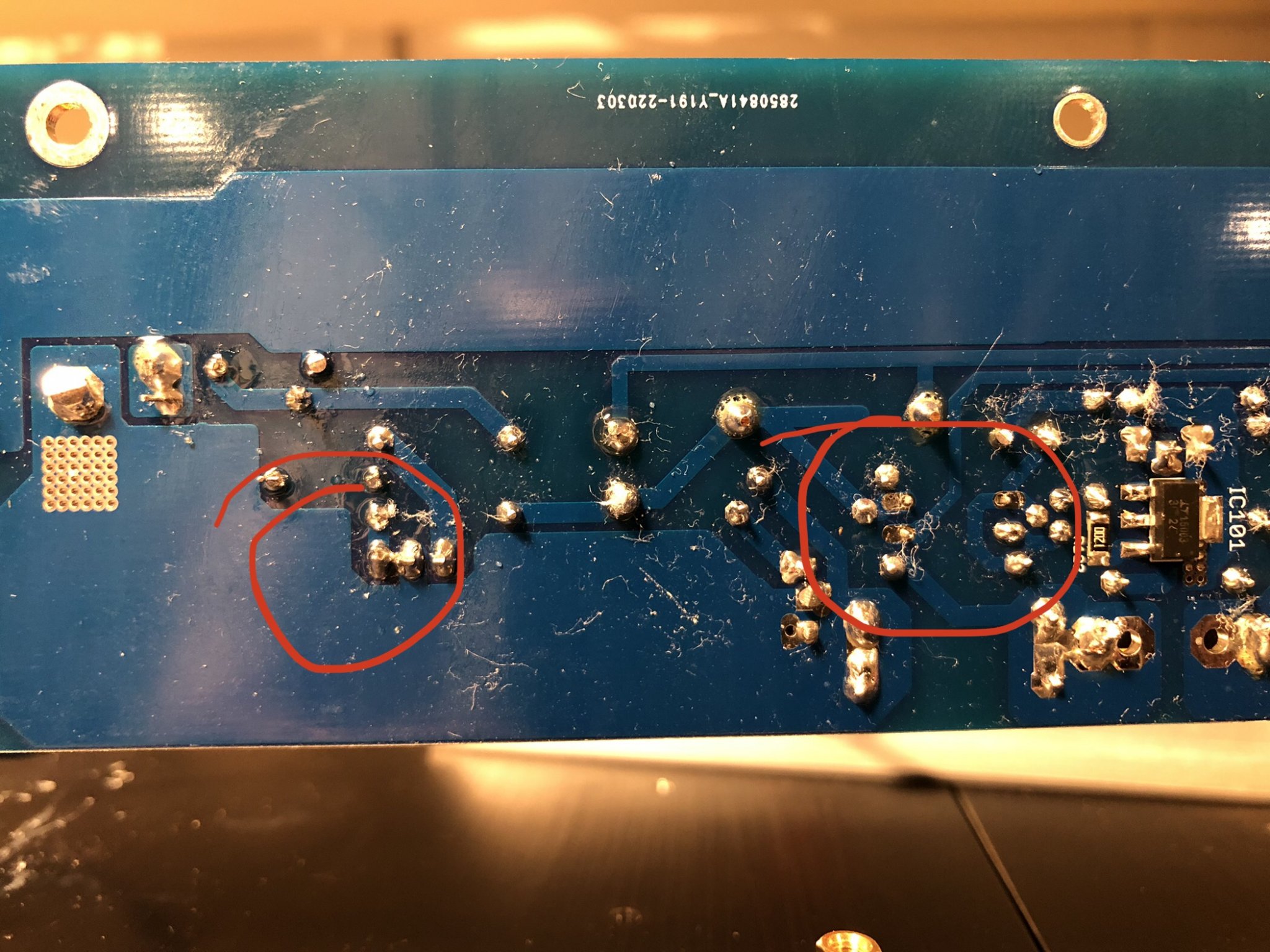

Issues Found and Fixed: After a nights wrestles sleep, I took everything apart and found that there was a solder bridge across the gate and drain on M101. And I found 3 pins on OK101 weren’t soldered to the board.

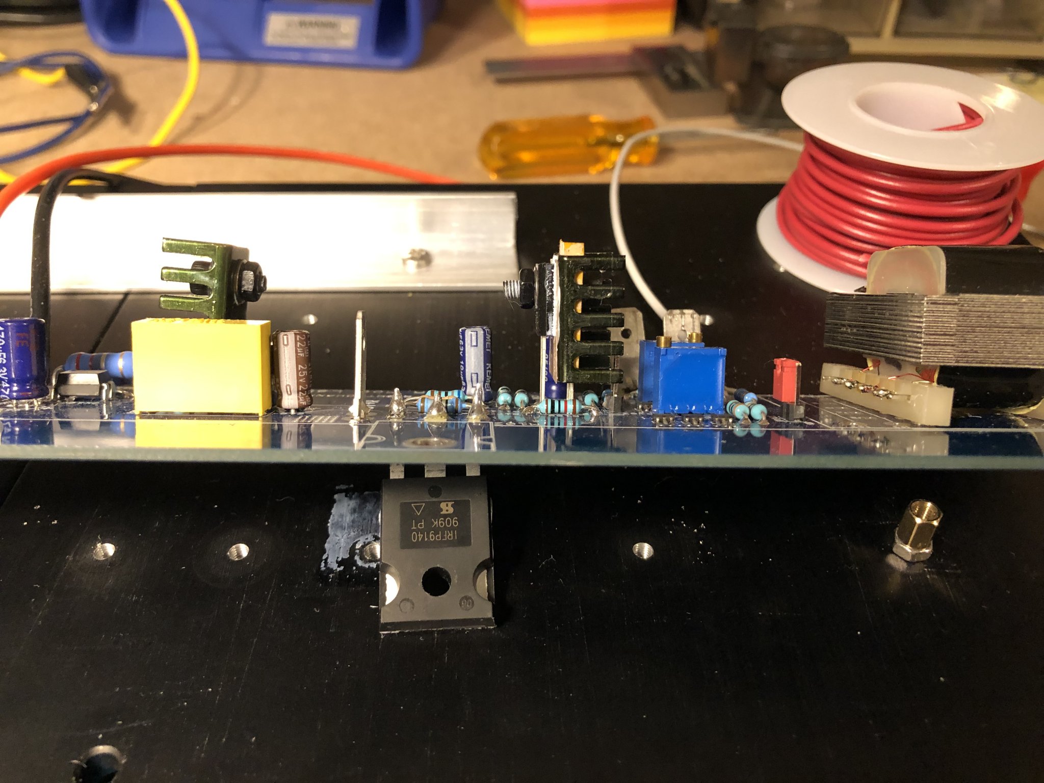

Could either of these issues have caused the 9140 to fry? Do I have it mounted correctly? I’m concerned there might be something else looming. I did a fairly thorough check of the other comments on the board, and it seems the 9140 was the only component to take a hit.

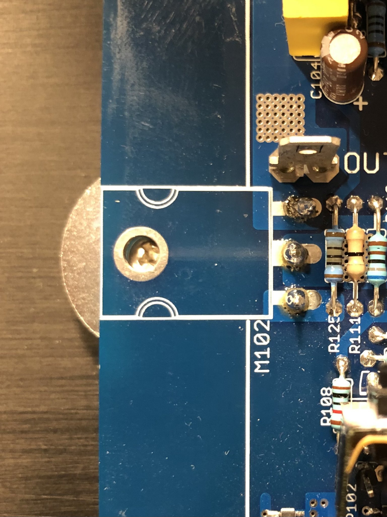

there is clear as whistle how to mount M101 on pcb, white overlay is showing which side is back-tab of mosfet

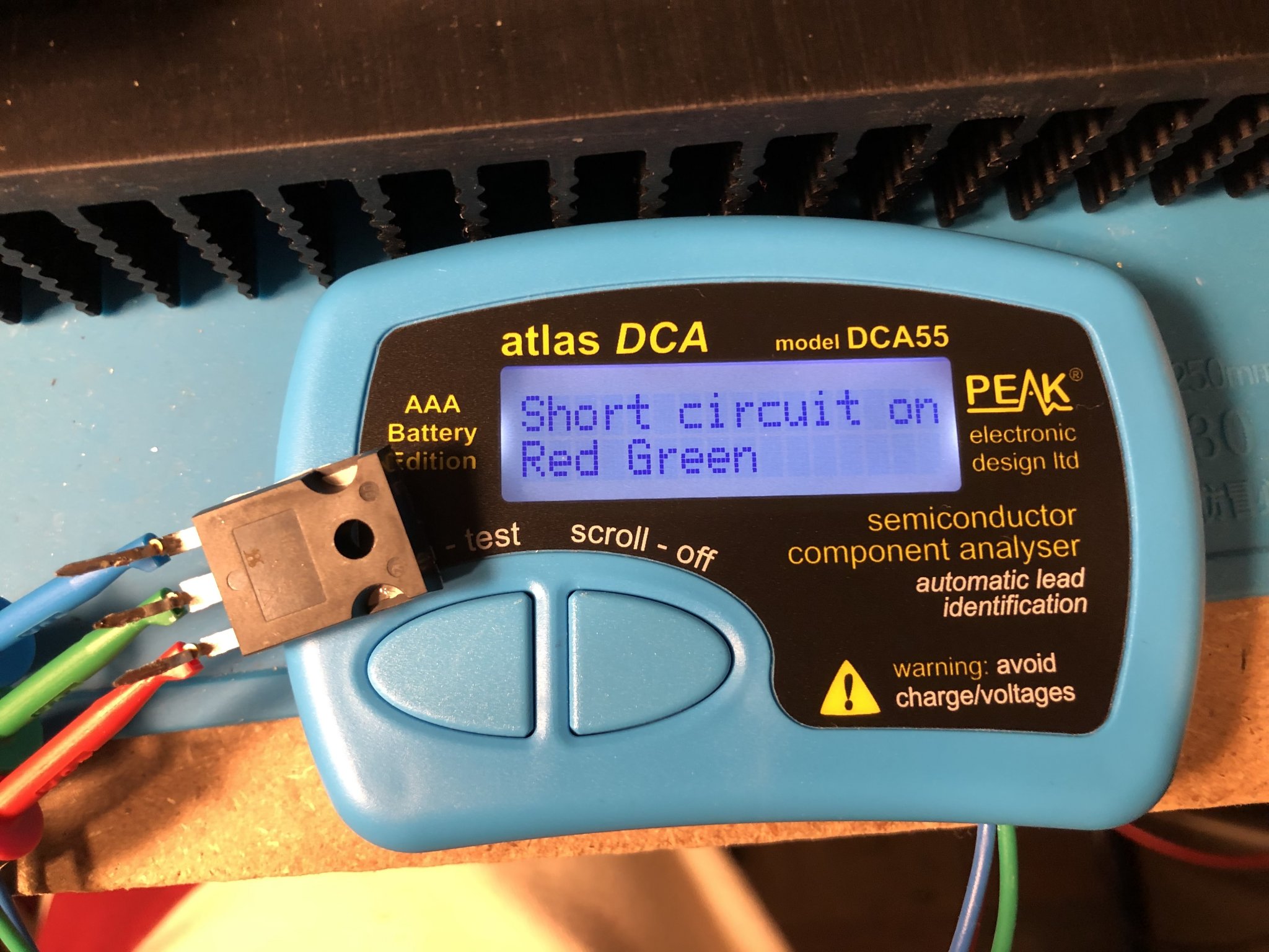

I mounted M101 correctly, I just had a solder bridge between the 2 pins. The part checked out ok in my tester. For M102, I asked as a sanity check - the metal back goes on the heat sink side.

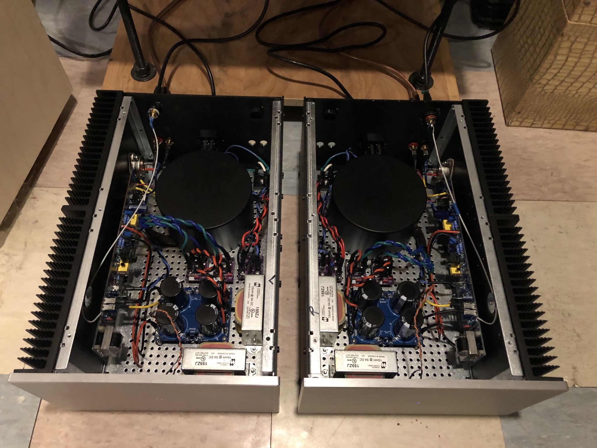

I used two Antek AS-3218 300VA 18v Transformers with covers from Antek.what toroid use ?
Glen, I am building the exact same configuration...mono block, 3218 toroid, Thatcher CL60/snubber and rectifier boards, 159ZJ iron, and Zen's cap multiplier board. Are you happy with the layout of everything and would you change anything now that you've finished? Thx

Hi cwlo - I tried to pay attention to current paths, magnetic fields and other factors around EMI. That diligence and the chokes make this a very quiet amplifier. I wouldn’t change anything.Glen, I am building the exact same configuration...mono block, 3218 toroid, Thatcher CL60/snubber and rectifier boards, 159ZJ iron, and Zen's cap multiplier board. Are you happy with the layout of everything and would you change anything now that you've finished? Thx

I read that self-shielding by twisting pairs with equal and opposite current reduces mutual inductance by 40dB. And they do look good! 👍Love the look of twisted wires.![]()
is right that twisted only the Ac but the DC only parrallel ?'I read that self-shielding by twisting pairs with equal and opposite current reduces mutual inductance by 40dB. And they do look good! 👍
I didn’t twist the black (-) and red (+) together because they both return to ground, not to each other. I thought that would mean their currents are not equal and opposite making the twist aesthetically pleasing but irrelevant to shielding. Maybe someone with a greater understanding of mutual inductance can weigh in on my thinking…is right that twisted only the Ac but the DC only parrallel ?'
