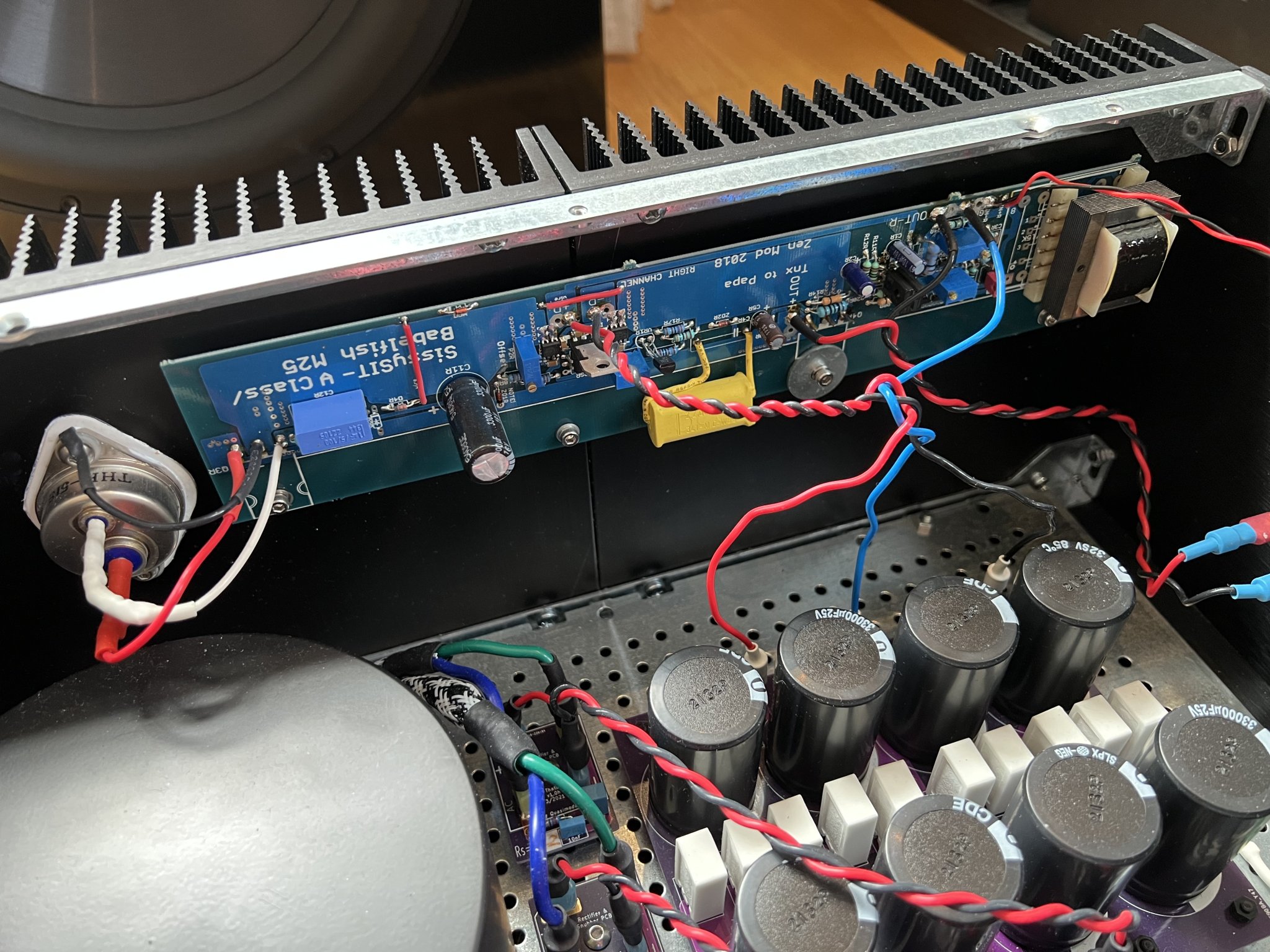

Still getting better and will need to sleep soon. Will probably need to run in some more. Compared to premium ACA first impression somehow softer, less harsh (because of zero feedback?) more dark background. I am struggling a bit here, have some weird tinnitus symptoms since a few days, hope they will pass.

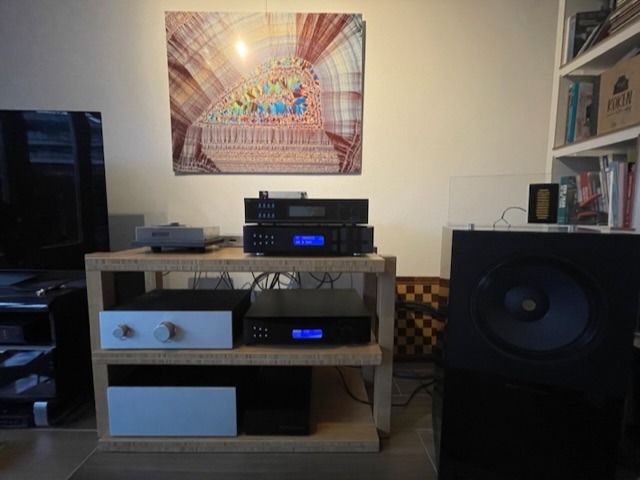

Getting more dynamic, keep turning the volume further down, now getting better idea of IP signal energy preservation that you mentioned which is much more apparent with this amp (more iron, duh). I have Cinemags in. Using 6V output of DAC so IP can be on moderate gain.

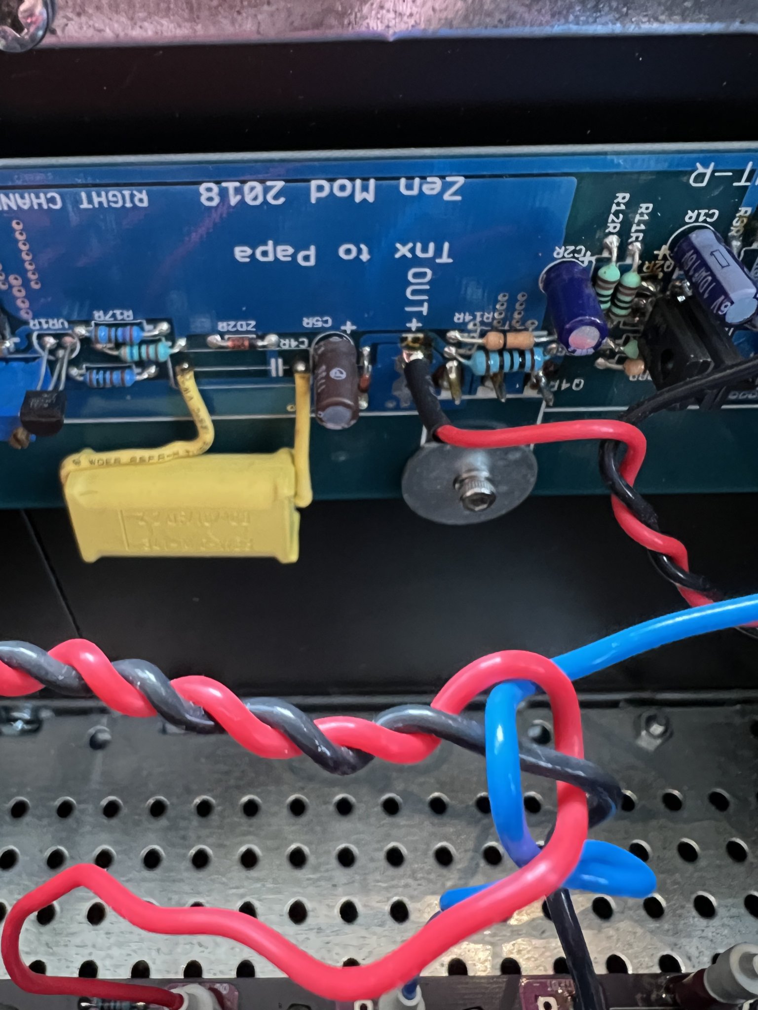

I just completed mono block Sissy's R.3. They sound great! I do have one question/issue, in that one of them has a turn-off noise. Not a thump but a "Ziiiip" sound. Bias and offset are dialed in nicely. I swapped out the cap bank for another one and the sound persisted on turn-off. Any direction on what else to check? Thx, Chris
Unfortunately - not

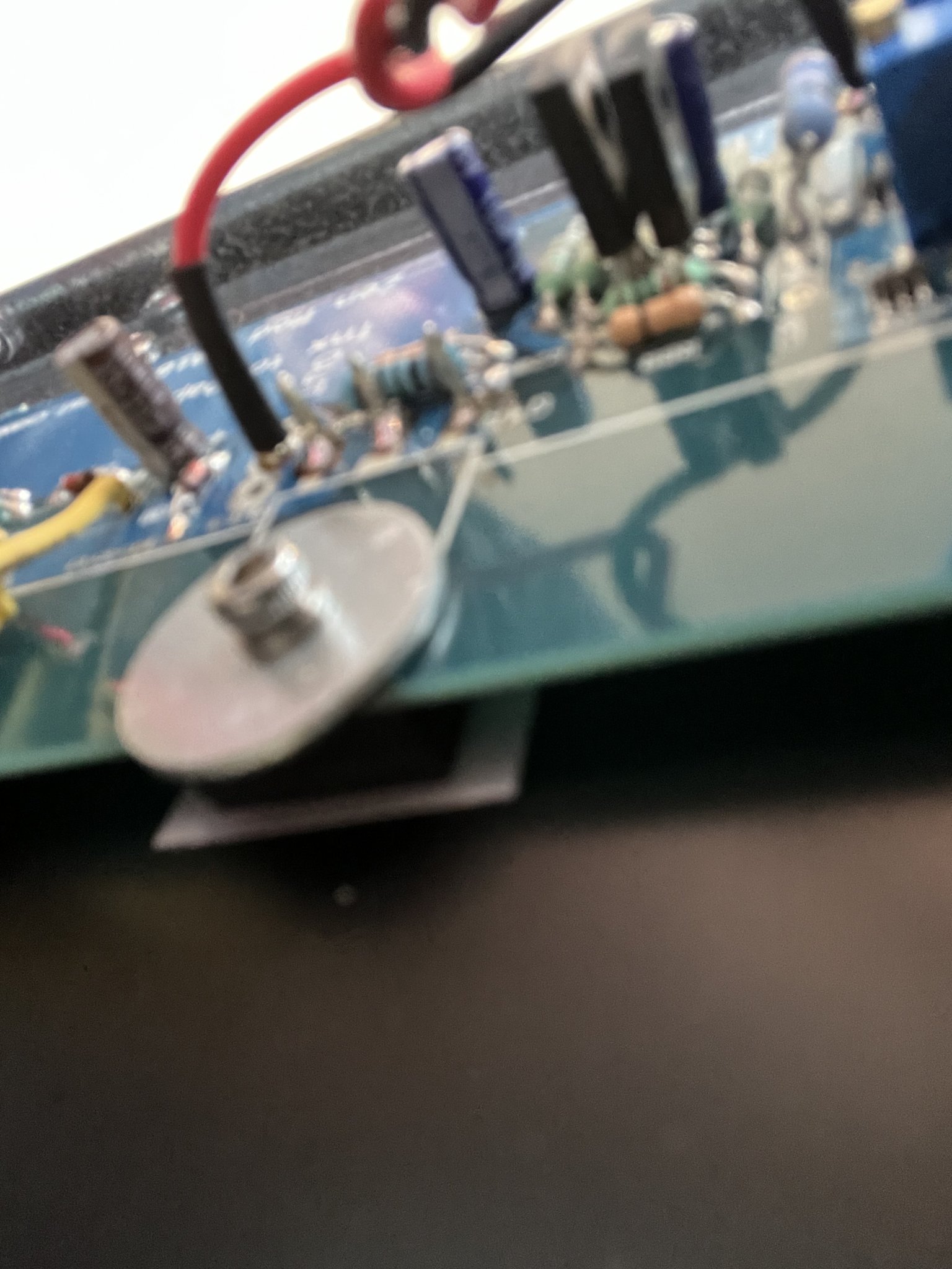

Have a DC problem with my Sissysit. Was listening last night and just by dumb luck I put my hand on the sissysit. The left rear heatsink was cold, everything else warm as usual which I thought was odd. Decided to measure the speaker terminals and I have got readings of 11 to 13 V dc 😳
yes, all proper - if what I see is Keratherm 86/82, under the mosfet
first diode-test mosfet (that will cover shorts, even if with positive offset that's unlikely) and presence of 5V at 7805
be careful with probe while testing that
see in 7805 datasheet for pinout - numbers to you, pins down , left in, mid gnd, right out

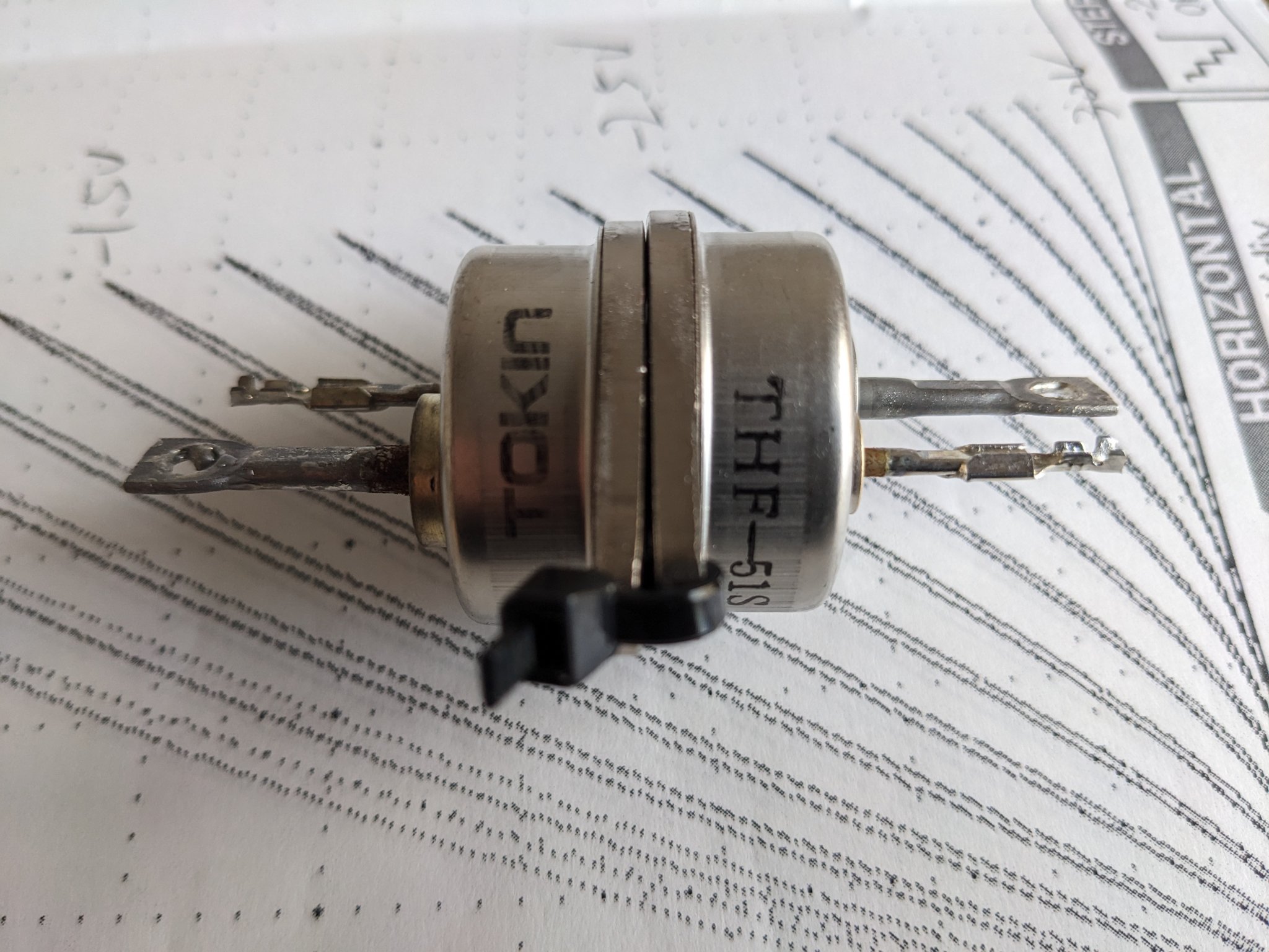

After too much time sitting in ziplock bags in my parts box, I'm just starting to build my SissySIT with the original PCBs. I ordered a set of high-nickel Cinemags that should arrive in the second week of July and have a pair of 200mm x 400mm sinks with 40mm tall fins. Bummer that Antek is out of 300VA 18v transformers, but I suspect they'll be back in stock shortly.

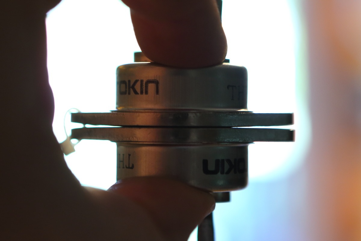

Before I begin, I have a question about the Tokin devices (sourced from Pras). The mounting surfaces seem to be a bit convex. Is there any value to wet sanding the mounting surfaces with some fine grit paper to flatten them out a bit? The gap at the mounting ears is about 0.2mm.
