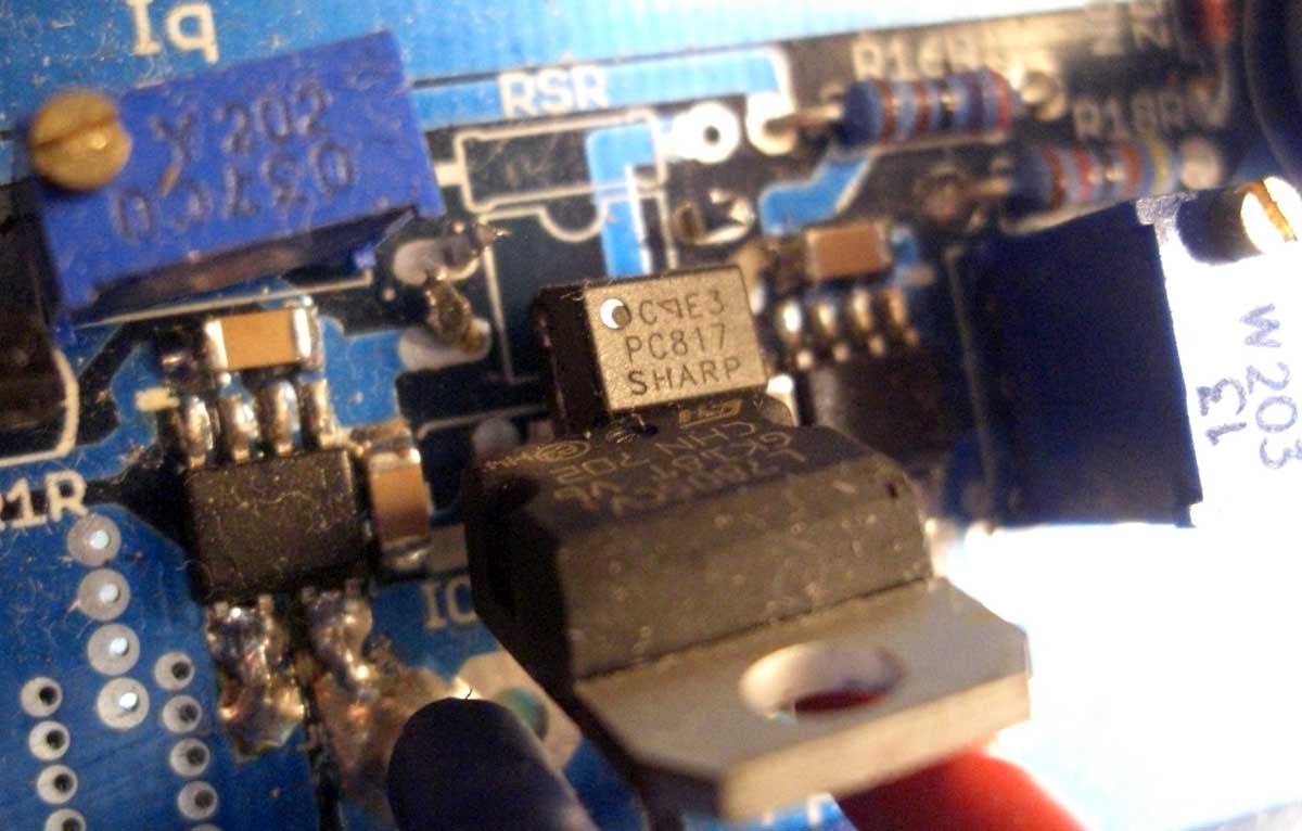

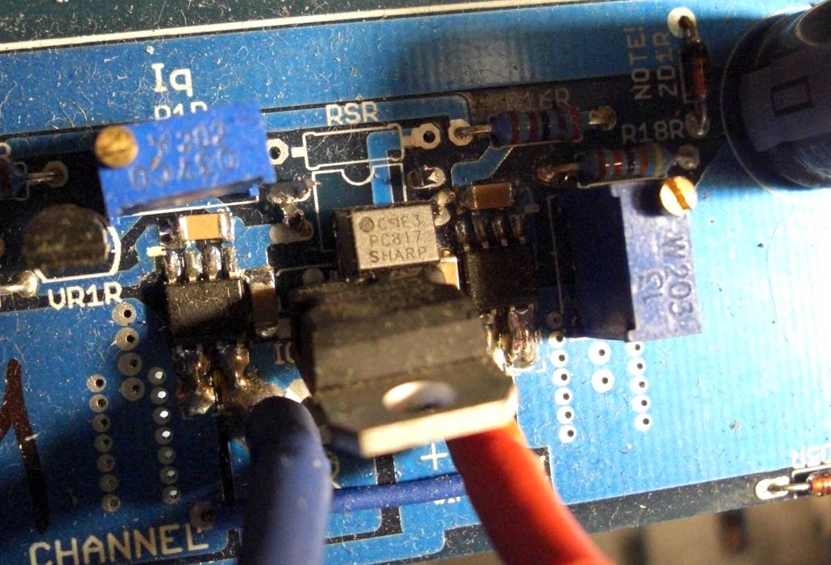

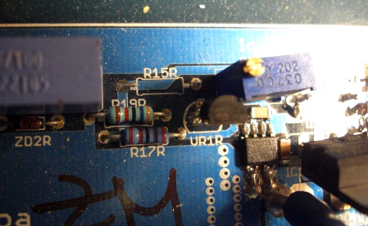

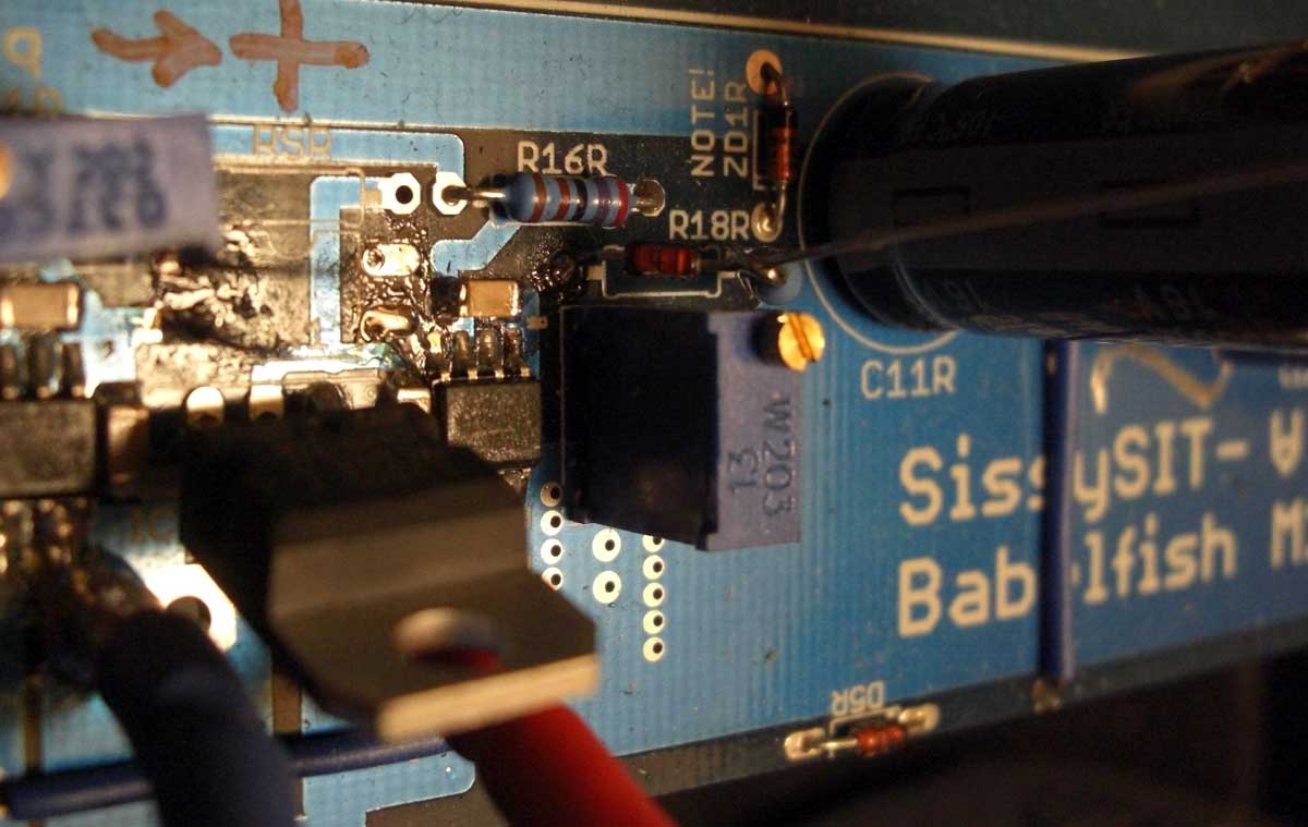

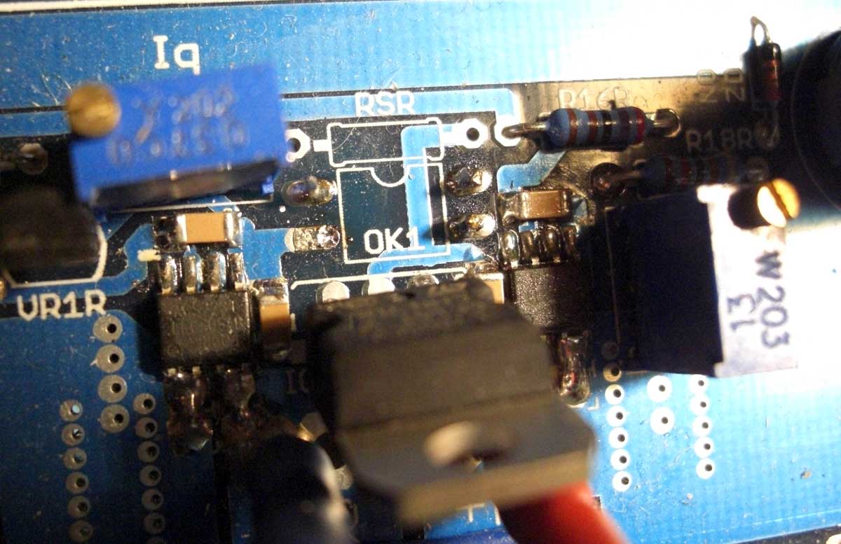

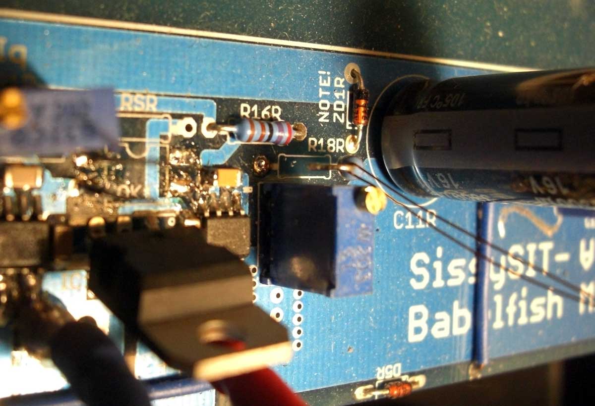

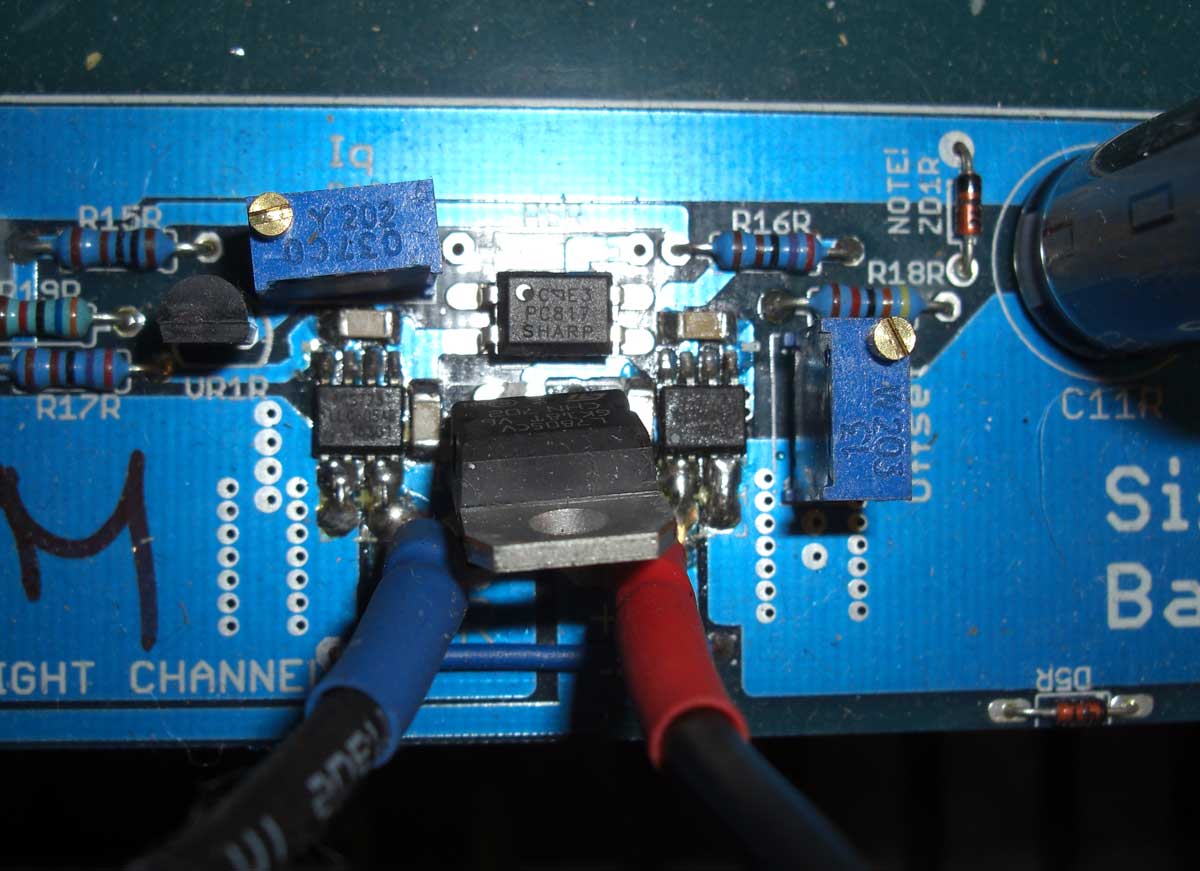

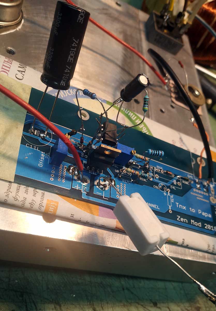

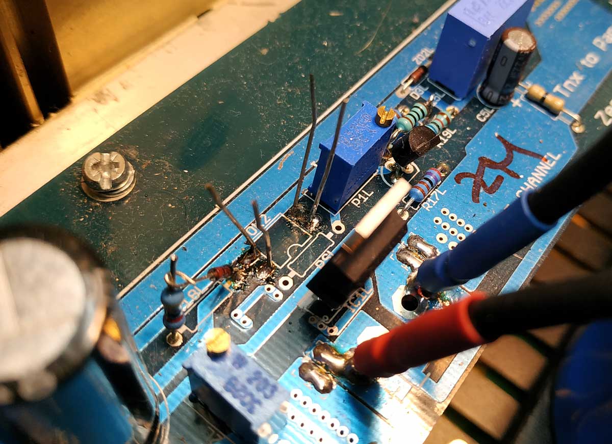

Let start with right channel , as written on pcb
cutting pliers - cut opto pins close to body, toss opto to bin , R15 - cut pins close to body , toss it
de-solder redundant pins from pcb and remove them with tweezers
add little solder on each pad - easier to manage later

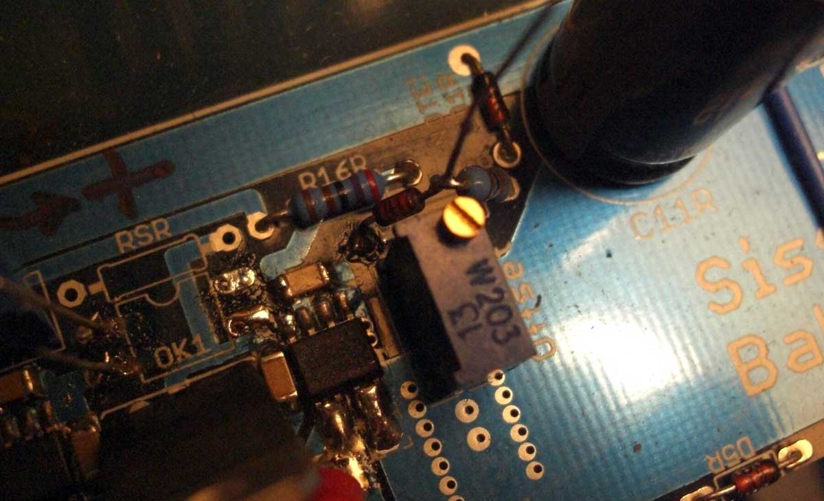

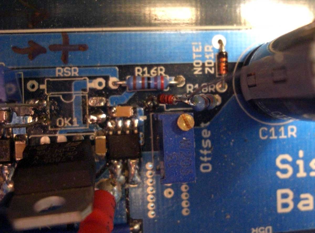

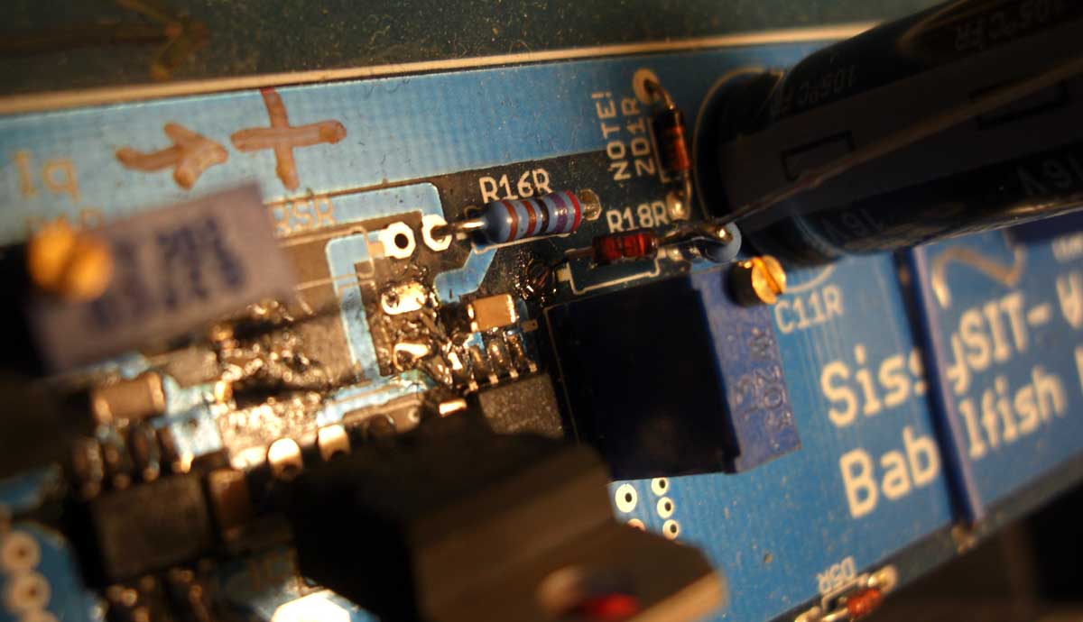

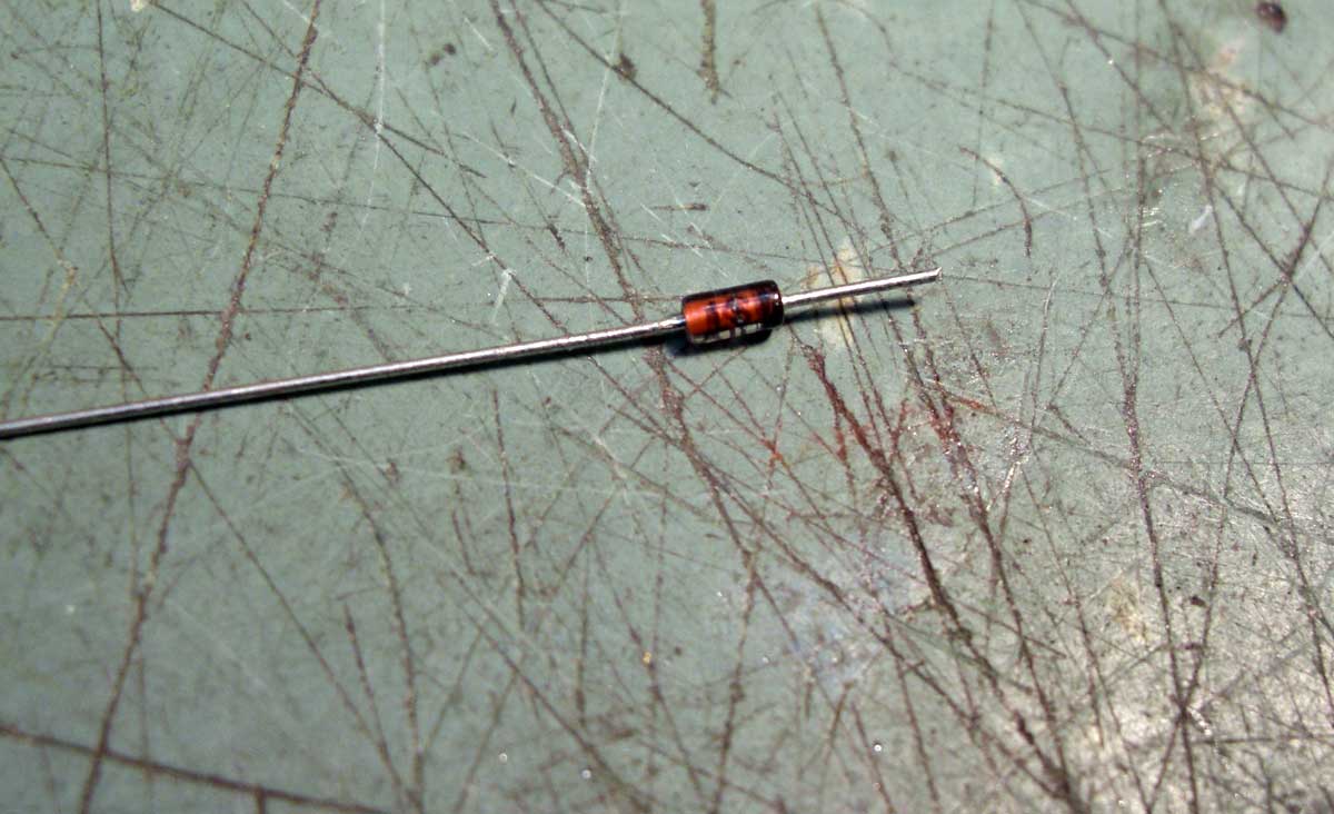

time to deal with R18 - we need to lift left pin - closer to opto , and to insert additional 1N4148 diode
considering space and approach only from top , for me was easiest to use thin (0.2mm) CuL wire as hook , to pull pin while heating with solder ; again add some solder to pad
when you're done , prepare 1N4148 ( observe where Cathode stripe goes), gently heat solder on pad , push diode pin in hole ; if needed , redo solder point to look fine
tie and solder free ends of 1N4148 and R18 , leave one end long

prepare 100R MF - bend legs and cut them short , solder them in R15 position
easiest to heat pad and push pin in hole , same for both pins ; redo to look fine
now you already have some leftover wire from resistor and diode pins - take 4 pcs (from trash if needed
) and solder them as Mustaches in all 4 opto pads
20mm will do , we will trim them later
![rolllaugh :rofl: :rofl:](https://files.diyaudio.com/forums/images/smilies/rolllaugh.gif)

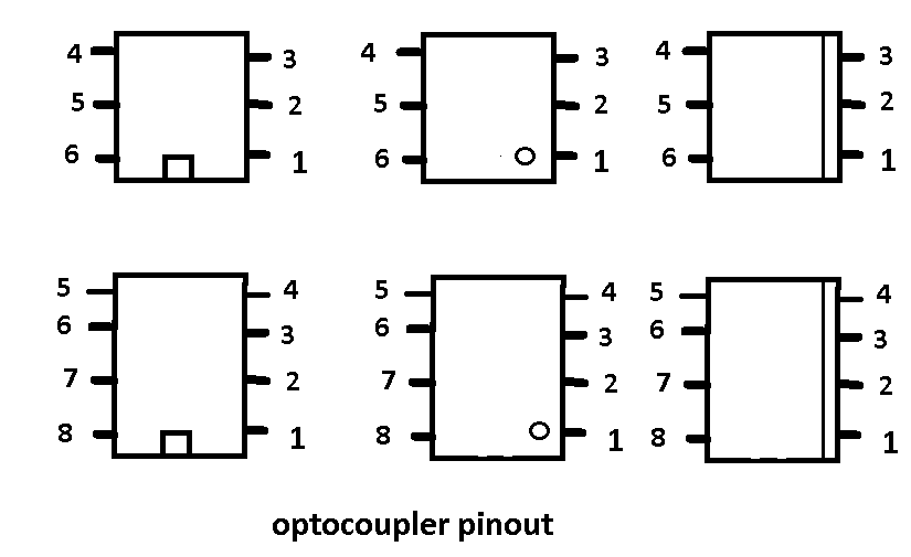

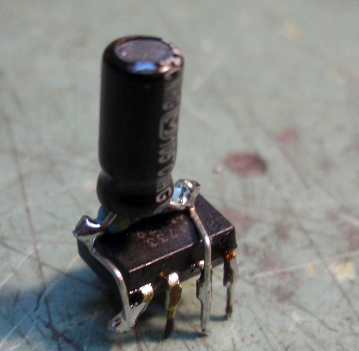

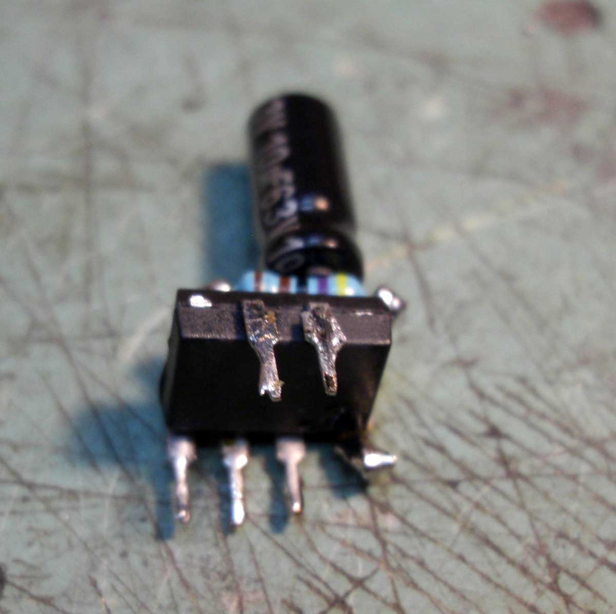

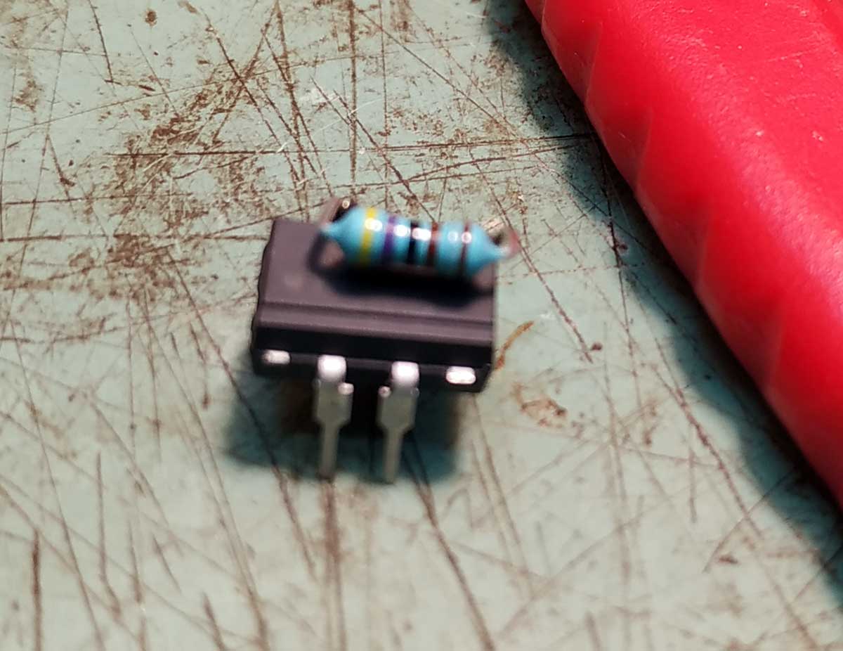

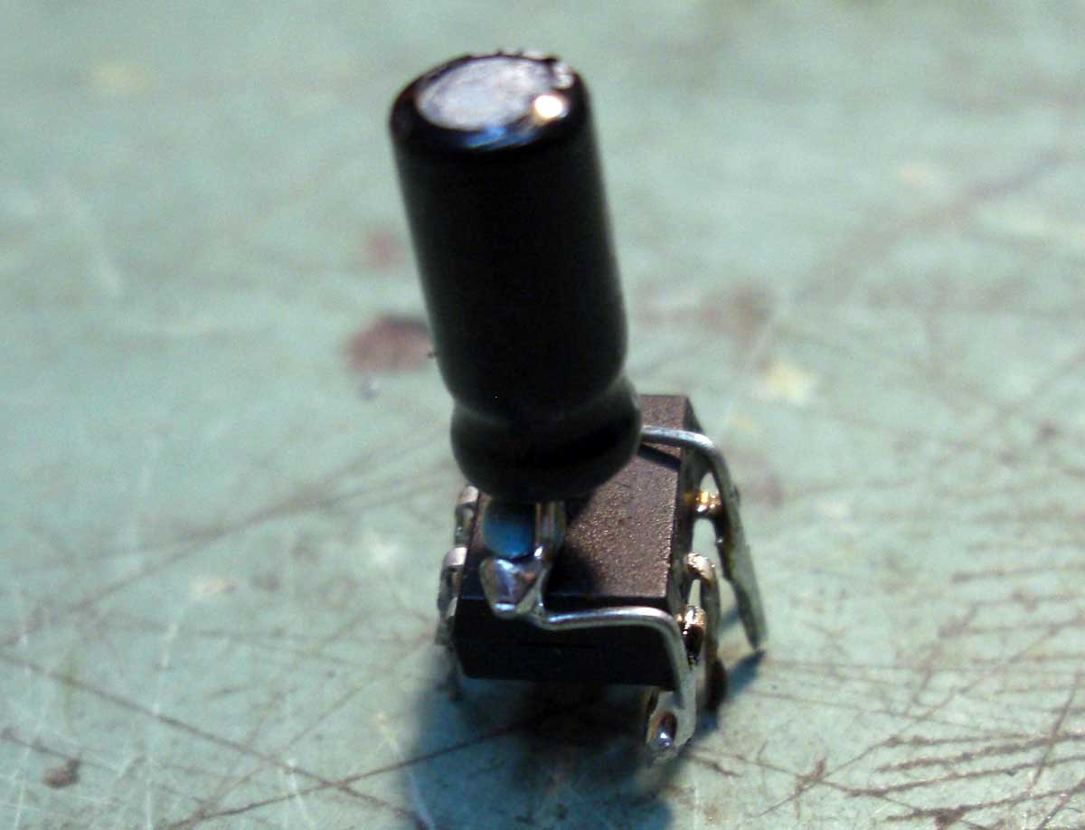

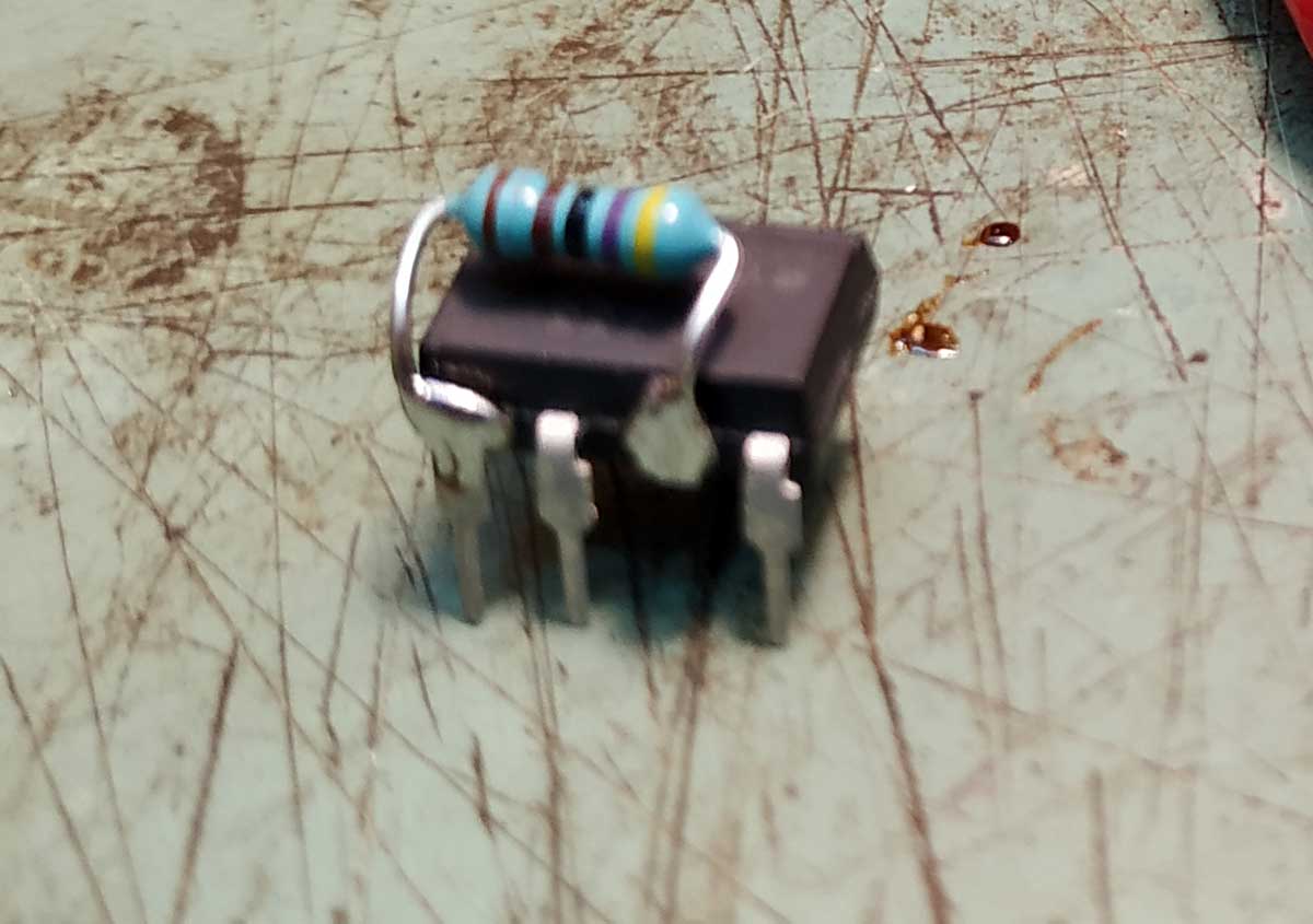

6N139 preparing
cut pins 1 and 4
observe trice , cut once

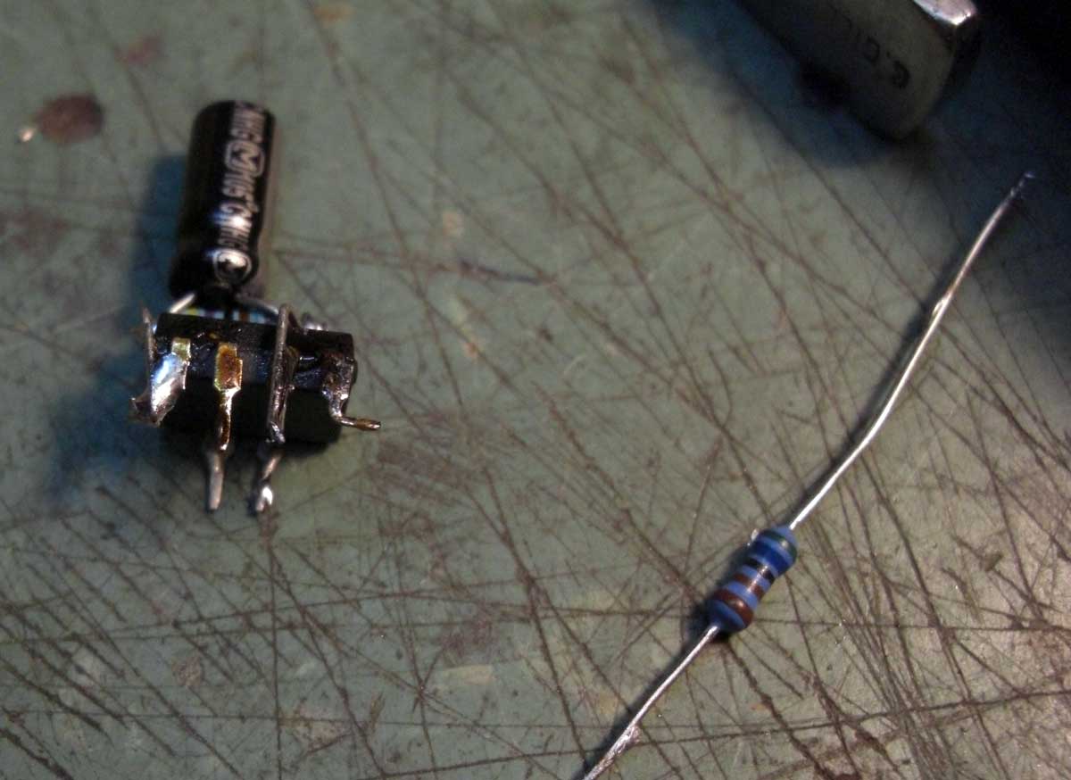

take 4K7 MF resistor ( even tiniest size will do) and 10uF elco (even 6V3 will do , but normal is 16V)
form resistor legs as per pics and solder to pins 5 and 7 on opto
solder elco on top of resistor , positive to pin 7 ( not!! like I got it on pics
take 5K6 MF resistor ( even tiniest size will do ) and solder to pin 8 - do not bend it as on pic , leave it pointing up and bend it later where needs to be bent
cut pins 1 and 4

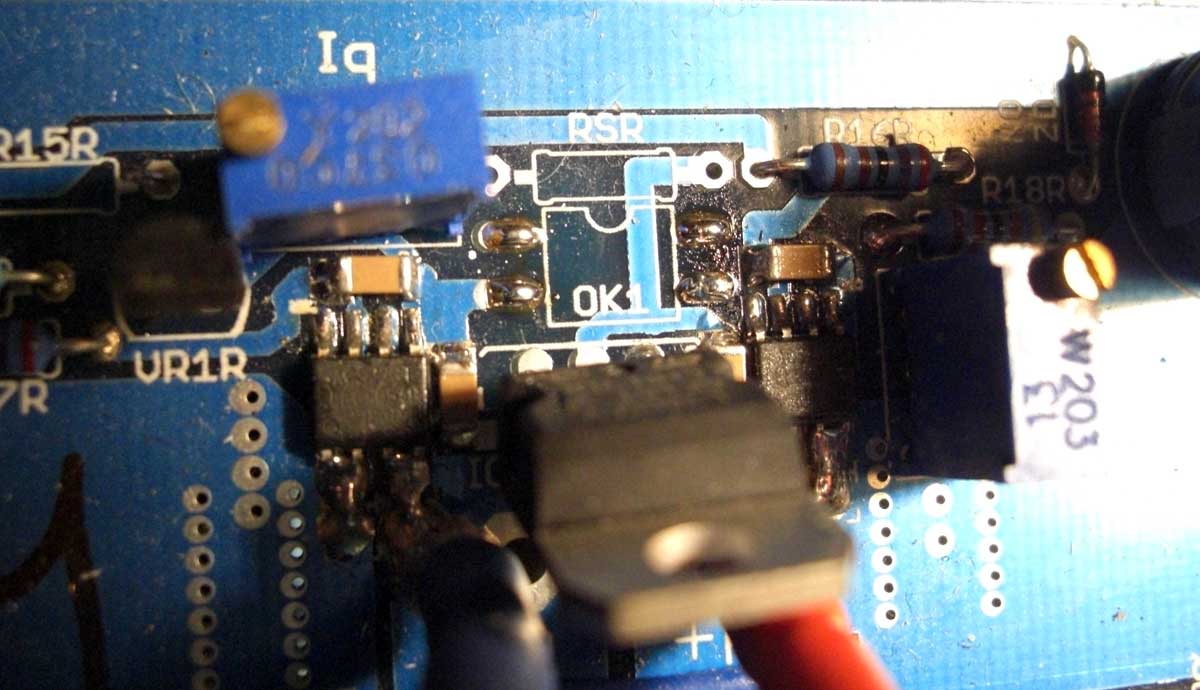

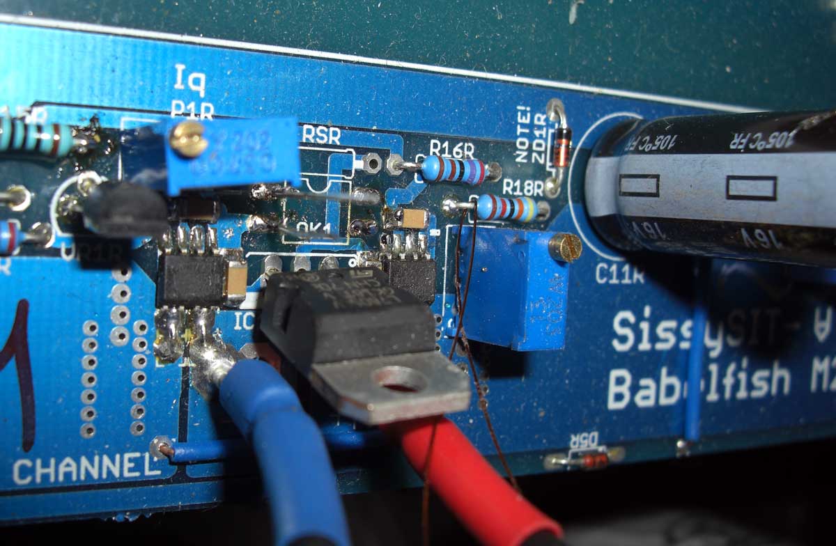

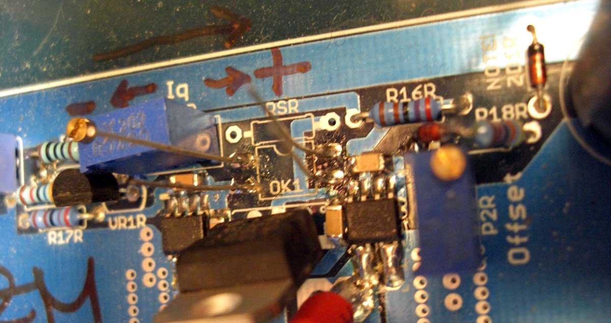

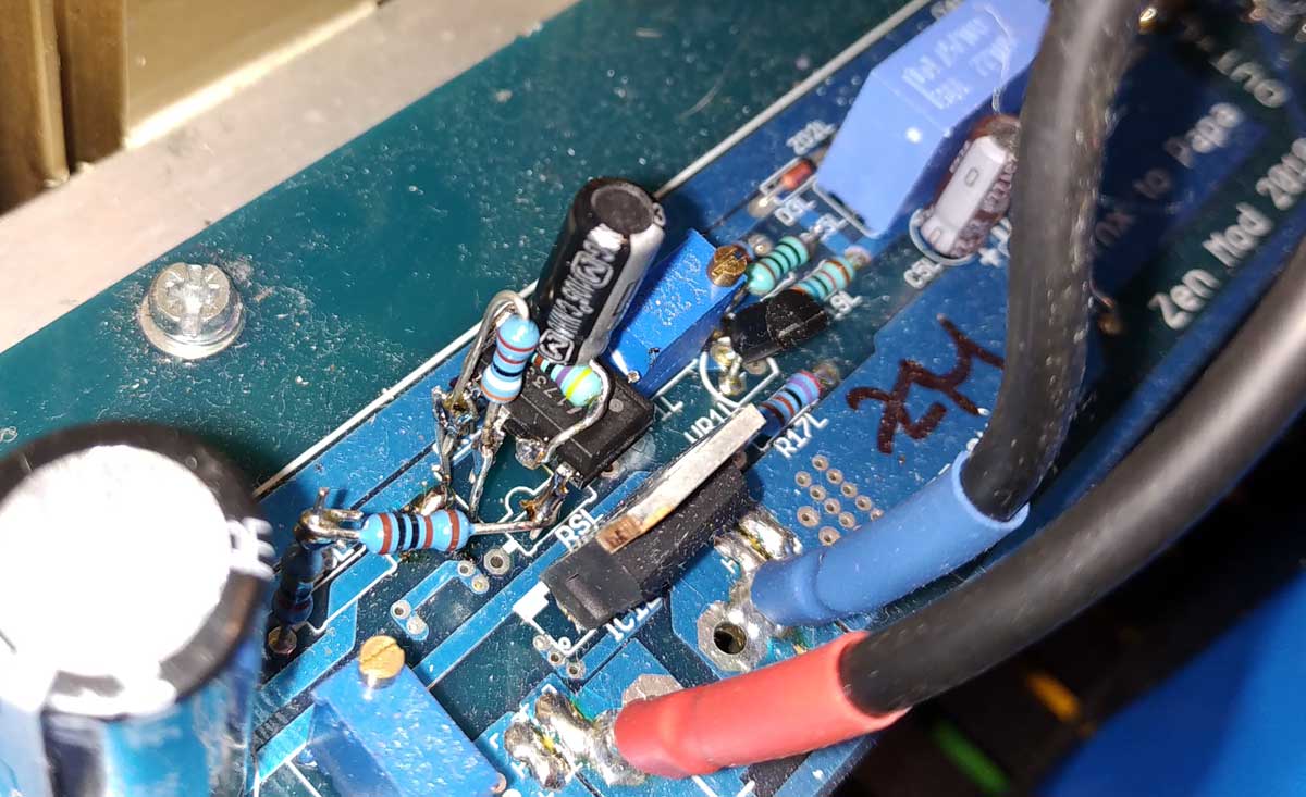

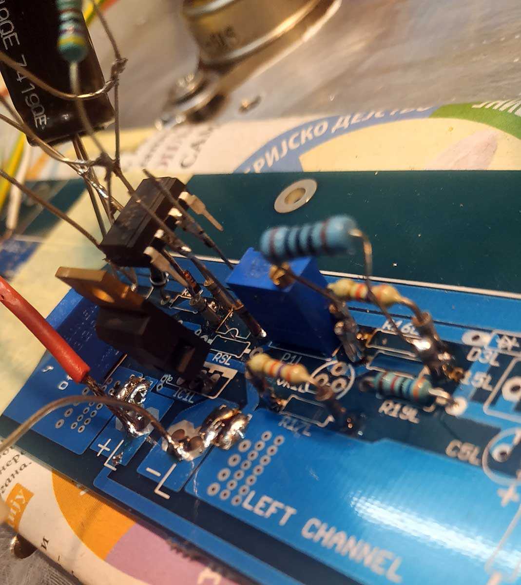

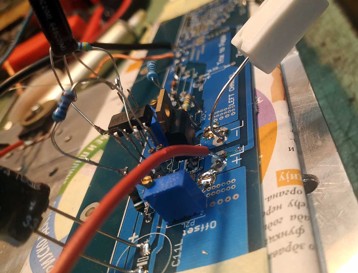

now , with tweezers , put entire thingie for mock-up between Moustaches on pcb , approx 5mm above pcb itself ; bend 7805 slightly away , to make more place
pin 2 of 6N139 goes in place of pin 1 of PC817
pin 3 of 6N139 goes in place of pin 2 of PC817
pin 6 of 6N139 goes in place of pin 3 of PC817
pin 7 of 6N139 goes in place of pin 4 of PC817
when you got it - if needed bend slightly each Moustach to accommodate - solder 6N in place and trim Moustaches

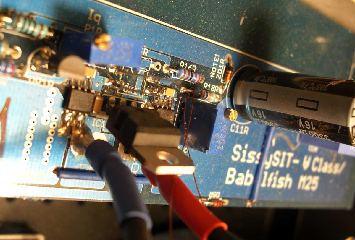

bend adequately remaining free resistor ( 5K6) , join with R18+Diode joining point , solder together , cut leftover leg
few pics as illustration , ignore that they're of Left Channel pcb ; difference to right one is that R15 and R18 are on opposite sides
ignore additional resistor soldered between pins 5 & 6 of 6N - my own Sissy is extremely tricky - Ugs window between SIT and MOS being just 720mV or so ........ I really didn't need to tweak it from original opto , but it is beneficiary for Greedy Boyz and also for learning sake

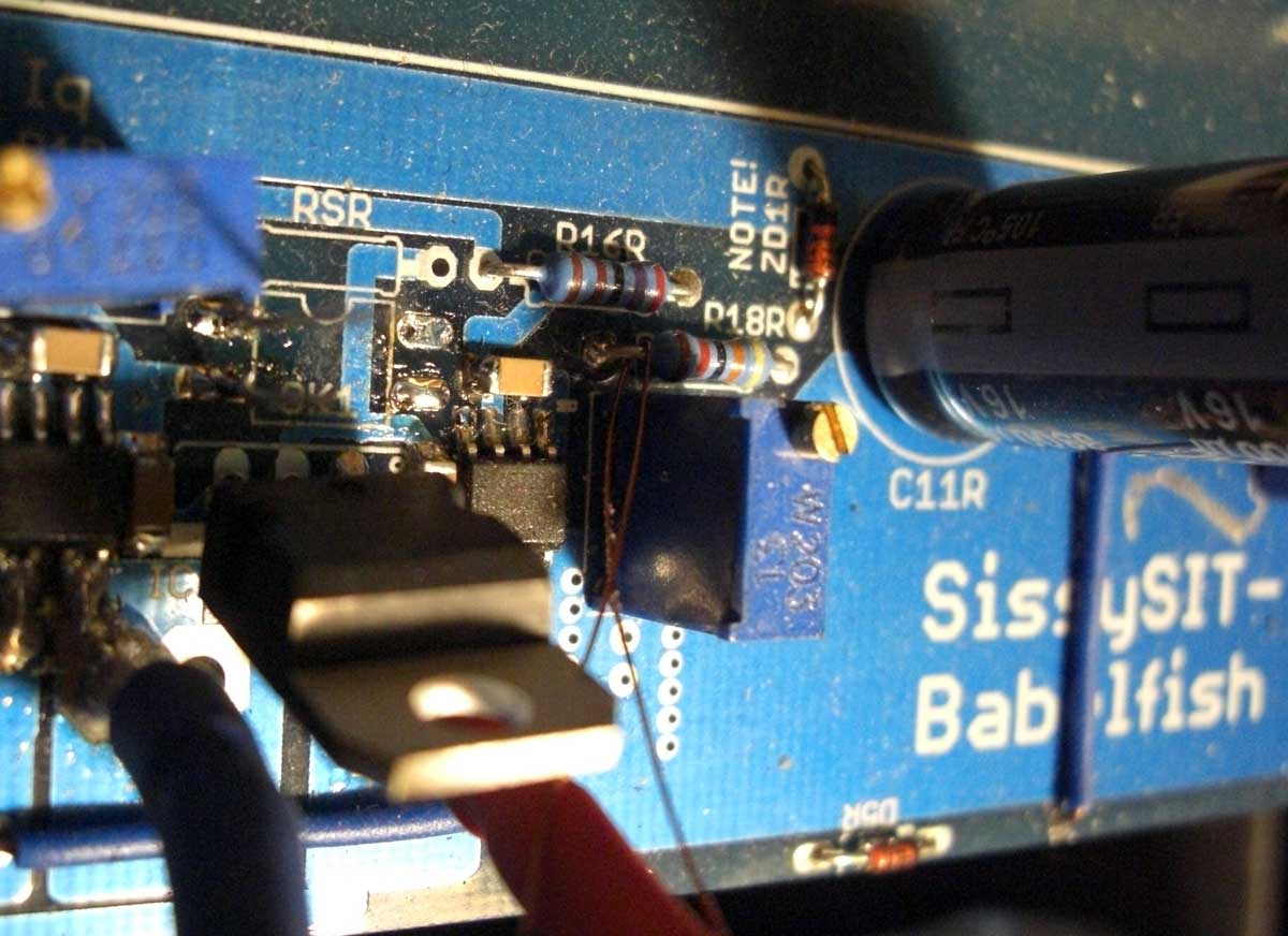

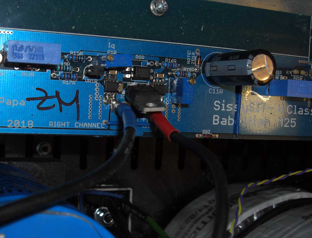

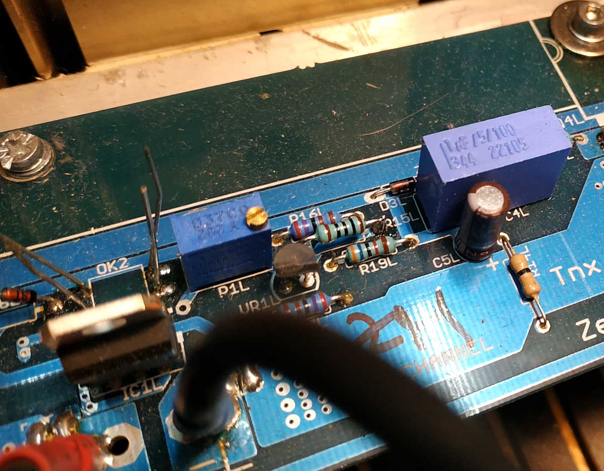

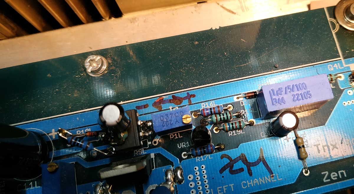

repeat everything with second channel ; again - difference being just R15 and R18 being on opposite sides
turn both (channels) Iq trimpots all the way CCW (shown on pics) , to set Iq to min for start
go back in thread ( first page , I believe ) , re-do biasing and DC offset setting procedure , preferably one channel at a time
again .......... :
- if you're starting from scratch - only you can decide will you go with original CNY17 optos , or right away with 6N139
- I can't guarantee that this remedy will cure all problematic SIT specimens; more AL involved in heatsinking , problem is smaller , that's simple physics ..... and - no matter how cute SIT is looking and how much we want it flawlessly operative and how much we hate even though of replacing it , when gate is leaking too much , it's leaking too much
if I forgot something , shoot
and - as always - blame Papa
![devil_y :devily: :devily:](https://files.diyaudio.com/forums/images/smilies/nicedevil.gif)

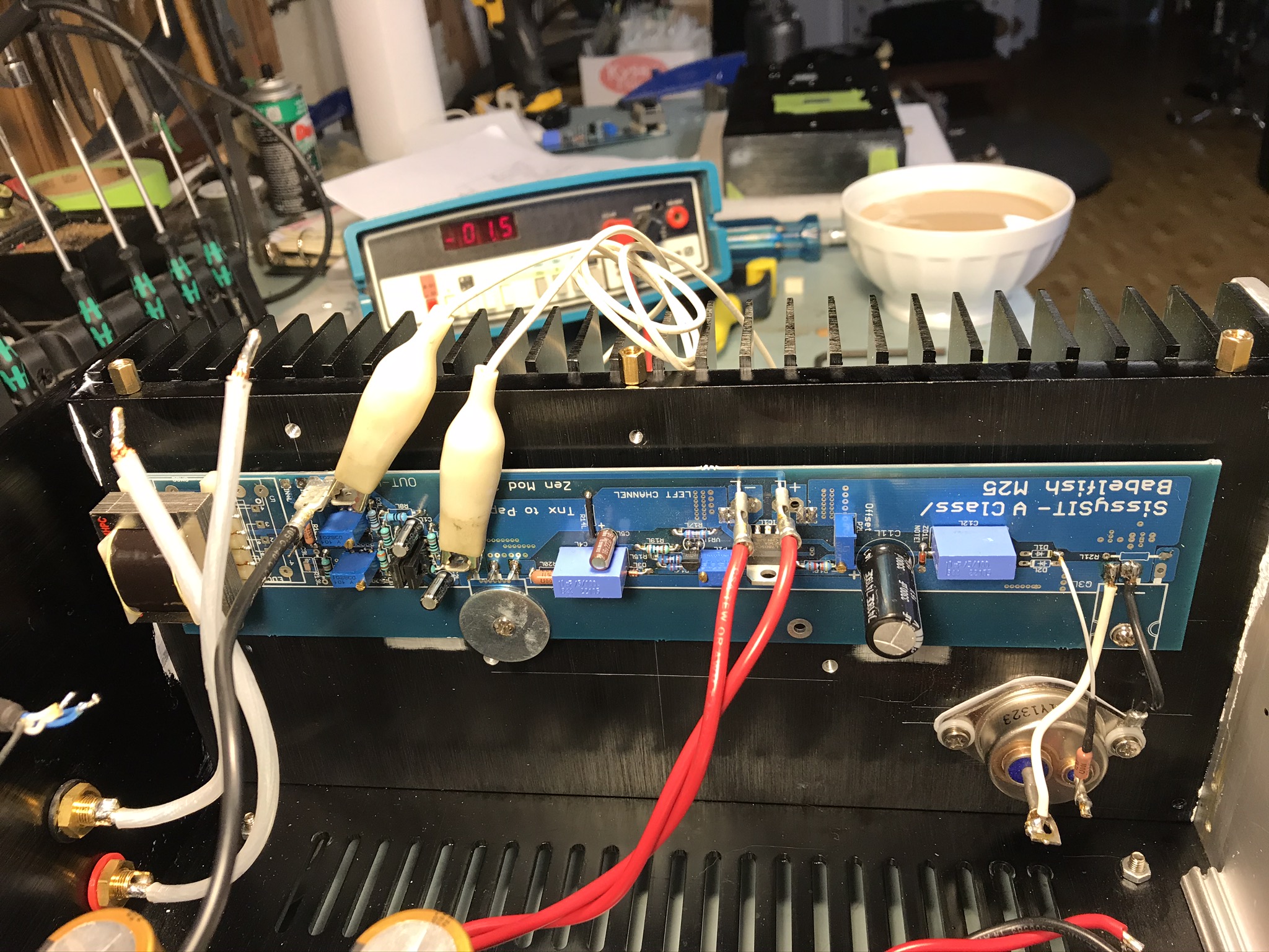

Very nice Zen Mod, the eagle eye photos look good. I think I’ll try and tighten up the devices by using SMD’s.
What does decreased speed , lowered highs effect?
My sissy rises 120ma over 5 hours as it reaches its thermal equilibrium. With more grip from different opto circuit what is predicted behaviour?
(biasing mechanisms can be made stiffer , but with price of substantially decreasing Rin of input stage , being mush tougher for input stage ; price - decreased speed , lowered highs ...... of course , there are other ways of biasing , but this was idea at a time ...... and pursuing other ways if just an idea for now)
120mA/5Hrs ...... just chill Bro
just re-check it in Summer , then forget
decreased speed , lowered highs = slower rise times/slower amp generally , more db shaven off at 20KHz .......... polite and boring sound , so you could ask your self - why I did bother ?......

First channel is cooking in temporary case. No mod done to the original opto and seem to be pretty stable at 1.5A iq. Offset is moving +/- 15mv from 0. Heat sink is at 45c SITs are 2sk182 from pras
I will probably not run it at 1.8A since my heat sinks are not that big. Is there a lower limit to the bias for the circuit to perform normally?
