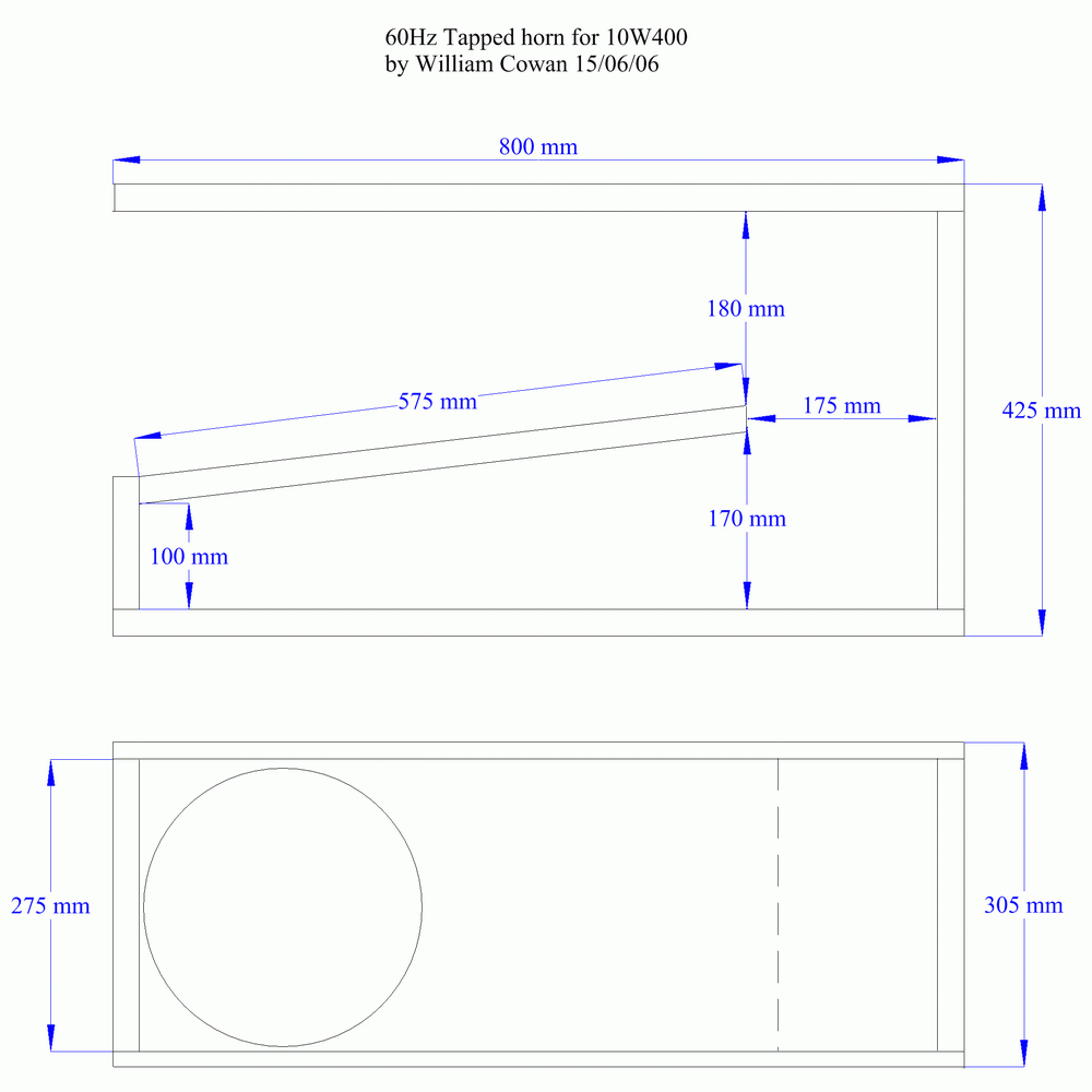

Very cool! So we're looking at about 70-80hz on the low end? I've been looking for a compact midbass horn to go under my synergy horn....
I tried double version of Cowan TH and it works fine with B&C 10CL51 60-250Hz. Easy to build and it's very dynamic and clear.
- baby University Classic folded midbass horn ?
