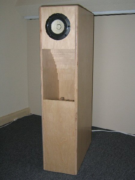

Yes, that cavity is to fill with sand bags, i'm doing it right now!
I used a foam on the front wall as you can see, but in the botton (in my case is the top) I used a long fiber damping, like a cotton. You can't see it on the pictures.
I used the #29 pieces, with spaces between them. You can see it here.
The sound, listening in the way that you see on my last picture, with no sand bags, I found that the highs are very clear and detailed, and so as the midrange! I notice that they get better during the first auditions! The bass is weak, but In this condition I cannot demmand much more from the bass.
I'm very satisfied by until now! If i'm linking the sound with this Pioneer receiver and old LD player, I can't wait to hear this with a single ended tube amplifier and a Hi-end CD player or Vinil!

That cavity is on the bottom, not the top. The enclosure will be on a shelf, so it needs to be upside down! The box is 20cm higher from the original project, so the speaker will be in my ears level. The cavity will be filled with sang bags.
I'll post more pictures later.
I saw the pic below before your response... it was all i needed to understand completely.

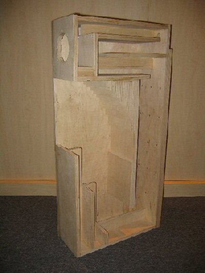

I can see that you are using the original parts (#29) to fill the compression-chamber. Are there spaces between them so that they fit the 170mm? I'm thinking about using two 170mm wide pieces instead. But I'm not sure yet...
You can use just two 170mm wide pieces. I did it also like that. The only reason the used the 6 pieces instead that they didn't fit in the original cutting plan.
Hope to see some pictures soon.
Here are some pictures of the speaker I build.
Alexander

I do not want earth shaking bass. But i now that I feel this lack of bass because the driver is very new, and I'm playing it with a poor amplifier. I'll have a tube amplifier very soon to run these babies!
Do you guys thing that the B-horn will work upside down?
