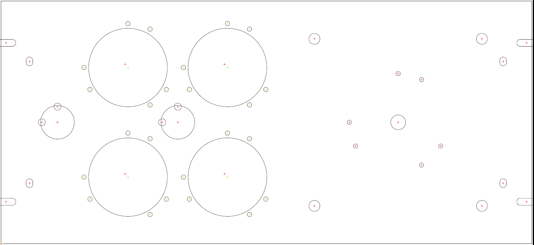

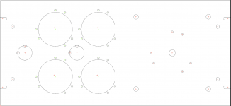

By the way, I had already laid out an AC/DC PSU with the Variac before deciding to build this amp. It would be a 1kVA box with an iso transformer so I can use it to play music or safely fix amps. Attached is a print from the FPD file of the front panel. The 2 smaller circles are for power and AC/DC switches and the 4 larger circles are for Simpson panel V and A meters. Just haven't built it as the amp project got my attention after BAF.
