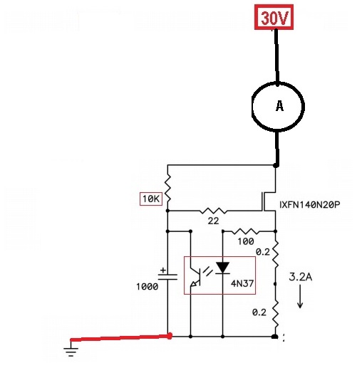

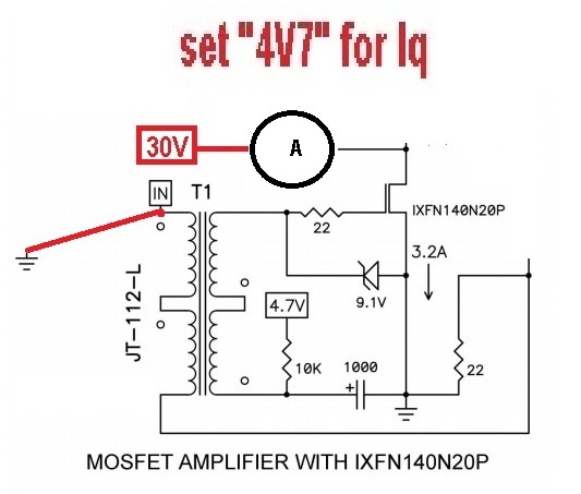

1. test for lower half :
to repeat (both my self and pico)ignore 4V7 as value , take it as figure ; set 3A2 in temp equilibrium , even if that demands 2 hours of operation
2. test for upper half - add 10K trimpot in series with red squared 10K resistor (preset to max value); fiddling with that pot , set 3A2 in temp equilibrium , even if that demands 2 hours of operation
3. then only you can connect two halves

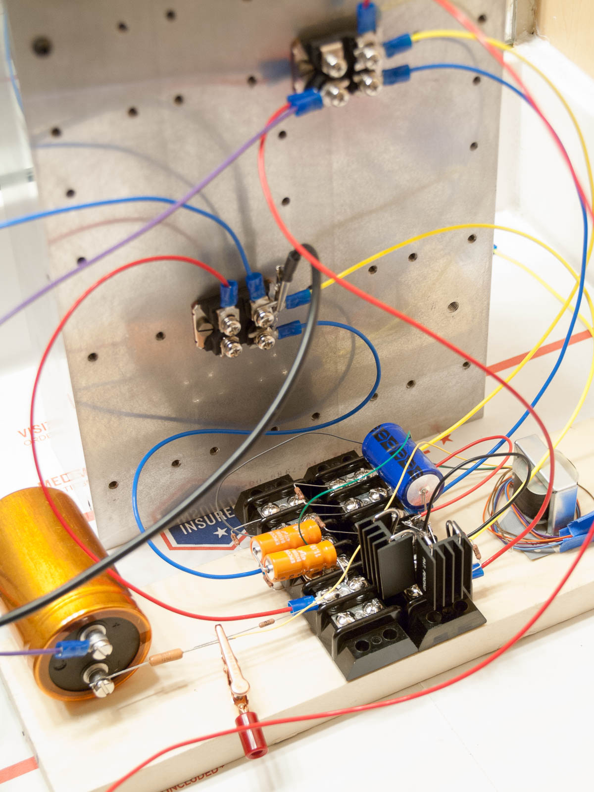

On first picture - left - 0.01A or negligible draw.
Wiring picture shows picture 2 on the right. 5A53 draw and STEADY. This turns on the upper device and it stabilized at about 175°. No runaway. Lower device is cool. The devices are arranged on the heatsink like the schematic - upper is the bias regulator and the lower is the output.
Are your both MOSFETs insulated from the heatsink? If not they should be and heatsink should be grounded.
