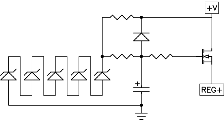

I'm thinking of using something like this on the supply. Any other suggestions welcome.
Here is one with an added resistor. This allows you to use a higher
value for the RC filter. If you used a higher value in the original the
voltage regulators (in the case of TL431) might not bias up, and if
instead you solve that problem by making C much larger, you might
see some motor-boating on the circuit.

Thank you Nelson.Here is one with an added resistor. This allows you to use a higher
I'll give that one a try.

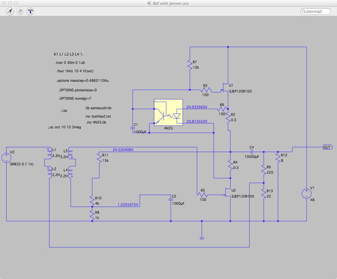

I was able to get the original Schade circuit stable at 1.8 - 2.0 amps
To be make sure it wasn't my wiring I brought up the generg circuit (below) - only required a couple of changes (gate resistors and bias supply).
With voltage at D1 = 50V and D2 = 25V. R2 = .33 ohm and R4 = .5 ohms. Current through these resistors is 1.5A. Rock solid.
I want to build the other channel and give a listen.
I also want to try a IXFN/2SK182 version with 60V supply and then I will try to resolve the IXFN/IXFN version.

This is interesting! What typical values in the components is there ?
Assuming you have 70V of unregulated dc coming off CRC, and intend on using IRFP240 or 250.
First Diode. 1N4004
Zener Diodes: 6 x 11V (or any other combination that gives you between 64V and 66V)
Top resistor between 1k and 2k to feed Zener network adequate current.
For RCR network at gate of mosfet. I used 220 Ohm 1000uF 220 Ohm. You could also use something like 1kOhm 200uF 1kOhm.
Quite a bit of flexibilty on those values.
Mosfets: whatever you have with decent transconductance. IRFP240 and IRFP250 are good examples. They are also cheap.
Note: If you have less than 65V of unregulated supply voltage coming off CRC you can either accept a lower regulated supply voltage, or alternatively you could try using depletion mode mosfets which will give you a higher regulated supply (around 4V higher) voltage compared with IRFP devices.

Is there an obvious reason why I couldn't use a bifilar wound transformer for the BAF schade circuit? I already have a nice JT-11 here.
I can put a LCR meter to it and and look for differences in SPICE.
I dont see any. But i may not be the best reference...
Looking forward to the results from Spice.
