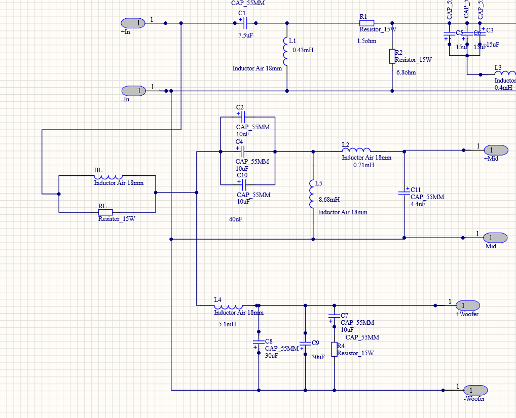

It is common practise (for diyers) to use 6dB BSC (baffle step correction) for standmounted or big freestanding speakers, 3dB BSC for those who are supposed to be placed near front wall and 0dB BSC for soffit mounting or in-shelf bookshelf speaker. This is because BS is -6dB, floor gain is +3dB and wall gain is +3dB.
The problem is like markus said, that all these have different knees (Fc) and that floor and front wall also make a sharp cancellations (of which the first is of greatest importance).

I`m considering Baffle Step to even effect the midrange as if you see the way the correction curve requires some of its upper part of the baffle step is felt even at the low midrange as well. I feel just increasing the size of inductor will not help in here. Can anyone express your thoughts on this please.
Dont use a separate BSC circuit, too much heat and current. Just measure your Drivers and make a normal 3 way crossover and account for the variation,I`m considering Baffle Step to even effect the midrange as if you see the way the correction curve requires some of its upper part of the baffle step is felt even at the low midrange as well. I feel just increasing the size of inductor will not help in here. Can anyone express your thoughts on this please.
