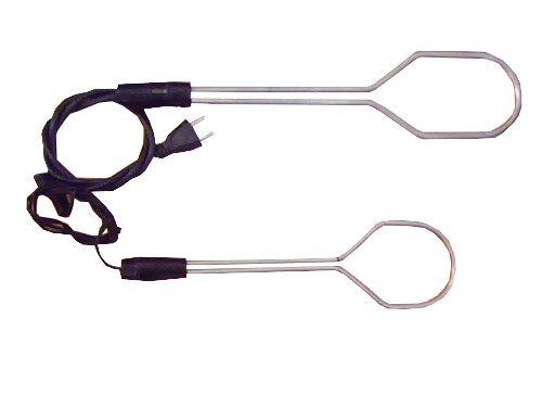

![rabo_quente.jpg](https://www.legal.adv.br/img/refs/rabo_quente.jpg)
![raboquente1.jpg](/community/proxy.php?image=http%3A%2F%2Fwww.jctherm.com.br%2Fimages%2Fraboquente1.jpg&hash=9e031f36e295b00cf1ad1b0447182833)
These are very inexpensive heaters intend for water.
ERRATA: I mean say heat the tube getter by induction, not the cathode.If they are intended for water then they might not work too well on small pieces of nickel. Or they might work far too well!
I already test this device in dry conditions and the metal resistor becomes very red instantly.

Really?? I would use it to interfere with the hi SPL boombox from my neighbor's spinster...rs rs rsThe issue with the induction heater is radiated noise. Since it would be used intermittently it might not be an issue, but It would probably cause interference in the HF band.
I will buy a 220V heater and use it in 60V for safe. ThanksImmersion heaters often explode if allowed to run dry. Don't risk that with a mains powered device!

At 3 to 10 dollars it is unlikely to be an inductive heater. There is no point anyway, as a resistive heater is perfectly good for heating water.
I don't understand your remark about 'expensive Pro heaters'. Those on here who bake their valves do them in a domestic oven. Inductive heating is for the initial getter firing which has already been done in the factory.

Those pictures you posted are NOT induction heaters. They are water heaters working at 50 or 60 Hz depending on the country you are in. They are used to heat water. Not much of an inductive field produced even if you step it down to 60 V with a variac or transformer.
Induction heaters produce minimum frequencies in the kHz (kHz = thousands of Hertz) range for their "inductive" heating using a rapidly changing magnetic field. You can read up about this. Even with a suitable coil, capacitors, heavy copper, transformers, components, and a manic departure from all safely concerns, even I won't be dreaming of doing this any time soon.
You mention commercial equipment? The closest I have ever come is my mother in-law's single element induction cooktop for portable table cooking. I wouldn't even do it there (expensive piece of kitchen equipment I would not want to break or replace).
You want to see some links from us? Probably not going to happen. You can do a google search yourself on induction heater and look at the images from other diy people. You can read their successful and unsuccessful stories and their incidents/accidents (like wearing a ring while too close to a heater -- this is near instant heat). I would not recommend any attempt at this because of the crazy high voltage/current/temperature produced. You have been warned.

FullRangeMan, what is used in a tube factory does not put out any HEAT!
It is an RF induction heater, probably in the Kilowatt range. It does usually use a coil, but the coil is big and fat to acommodate the very large RF CURRENT. Not 50/60 Hz. AC mains voltage. Not high voltage AC. Not high voltage DC. Radio Frequency. It's a big big big RF amplifier with a suitable coil to transfer the energy to the load. The load is the metal in the tube.
Think of it as "wireless spot welding". Ok?
