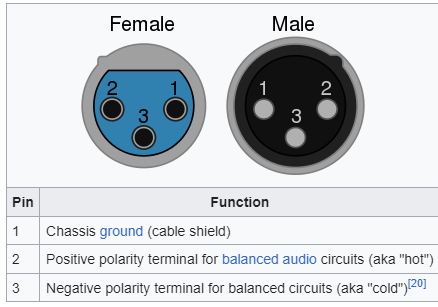

Seems to me that when wiring balanced connectors, the live end should contain a female socket and the receiving connector the male. This would tend to prevent human contact with electric output.

The standard connection for balanced audio connections using XLRS is male for output and female for input.
See XLR_connector
"The standard signal flow for audio in XLR connectors is that the output is a male connector and the input is female. In other words, the pins on the plug point in the direction of signal flow"
and for completeness, the pinout is:
This is the configuration that you should use if you wish to be compatible with the AES standard. And all the commercial gear out there - home and professional.

The refrain "audio goes in the direction of the pins" describes the sex of the
connector which is opposite of your description. We got some Sony BVW-7x
machines for the Japan market that had the reverse connectors installed. It
took the tech a fair amount of time to convert them to North American sex.
Nominal analog level is +4 dBm with some houses running +8 or 0 dBm as
the 0 reading on the meters. + 4 dBm is 1.224 V rms and nobody ever worried
about touching of shorting the signals. Digital signal levels are 1 V p-p.
I calibrated Henry Matchbox audio levels to +4dBm on the balanced side and
-8 dBu of the unbalanced side.
