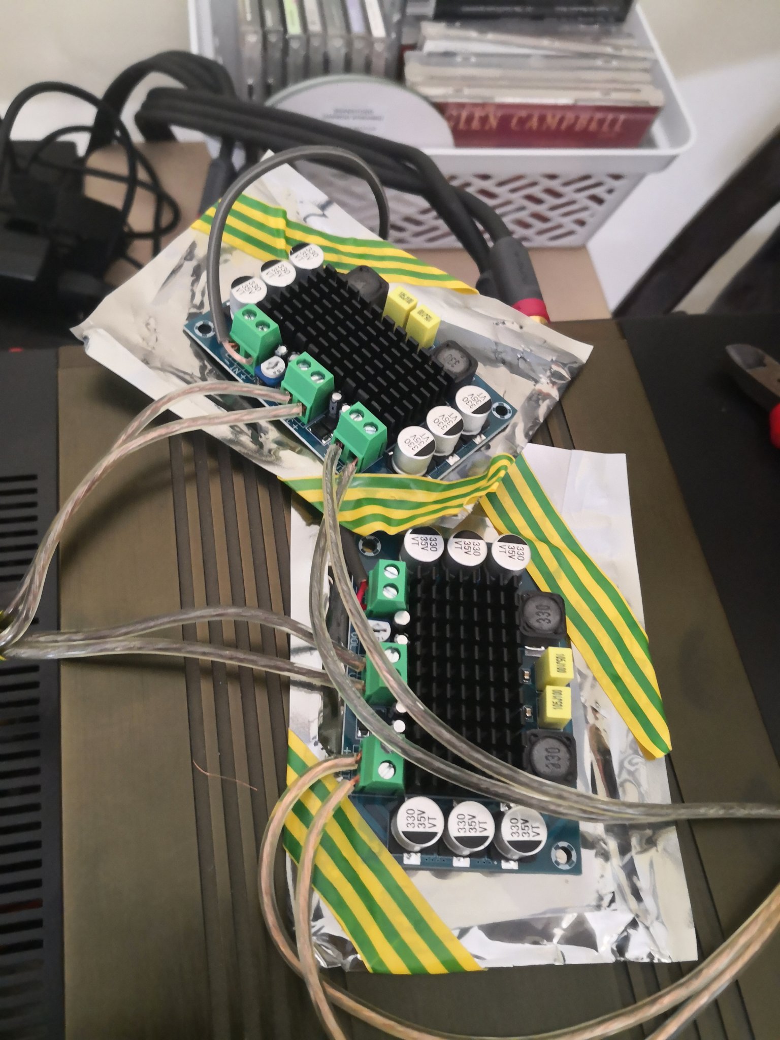

I have 2 of these DC 12V-26V 100W Mono Channel TPA3116D2 Digital Power Audio Amplifier Board powered with 2 seperate old 19V laptop chargers, the sound signal is coming from sound card in PC then optical into a cheap DAC then into the boards via rca plugs I am running yamaha ns 890 speakers 2 completely seperate channels, it's the best quality sound I have ever had no hiss or hum what so ever in every way, more volume that I can ever use only using around 10% of power amazing, like to hear you thoughts. Will tidy it up.
