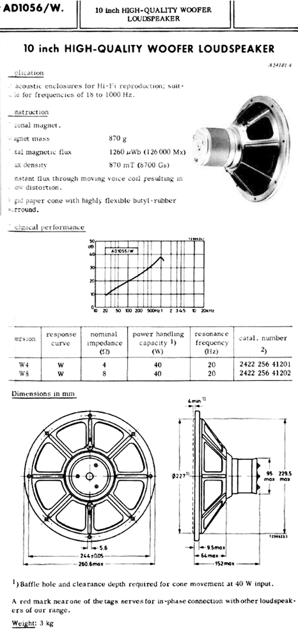

Hello everyone,
I have a pair of BeoVox 5700s. Sadly the woofers on both and tweeter on one seem beyond repair. The woofer speaker coils are making contact with the magnet or some metal fillings causing a scratching sound. Not sure what the problem is with the tweeter.
I really link the speaker housing though and the other parts seem fine. I was wondering if anyone could recommend a suitable replacement woofer and/or tweeter? Also, if there is any way to repair the woofers I'd love to know.

Replacement for Celestion HF2000 tweeter: Seas 19TFF1 H0737-08 Tweeter - Celestion HF2000 replacement
Sounds like the woofer voice coils are burnt out. This would call for a recone job, but it is highly unlikely that parts for these particular woofers would be obtainable.
The B&O 5700 has a 10" woofer, either the Philips AD1056 or, later, the Philips AD10100 which has a ceramic magnet.
The specifications of the latter can be downloaded from here: 10 inch Round High Fidelity Woofer Speaker-P Philips; Eindho
You may use these specifications to search for a suitable 10" replacement woofer.

Thanks Galu, that's really helpful.
I live in London by the way.
I have found the specs for the Philips AD1056 and will search for a suitable replacement.
Will post an update here with the result. Any other suggestions welcome 🙂

Welcome fellow UK dweller!
For reference, can you share where you found the specs for the AD1056?
