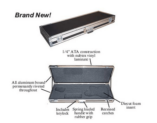

For bass, you want a stiff, airtight (other than bass reflex ports) enclosure.
Plywood ATA (Airline Transit Authority) cases fit that general requirement:
It is possible to DIY a case like that, but the valence material has to be sized for the plywood you use, preferably at least 3/8", bass enclosures are usually 3/4".
Any air leaks will make noise and waste considerable amounts of your limited power.

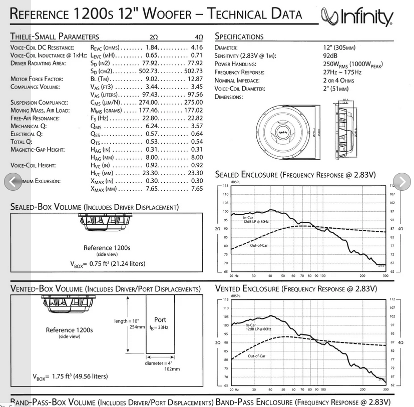

Right now, I’m eyeballing this speaker:
https://a.co/d/09cpSMED
In conjunction with the DML panel IF the DML experiments work out. Sealed enclosure, no ports (the low end bump isn’t worth the effort for this use.) I’m actually reaching “up” with this sub, not down lol. I’d use a woofer if I could find similar shallow mounts but the industry doesn’t really “do” that. This “sub” has specs and user reviews that place it as higher frequency than some of its peers, which is better in my use case. winISD shows it falling off around 40 but close enough. Top end should reach the 200-400hz rollover expected to match the DML’s.

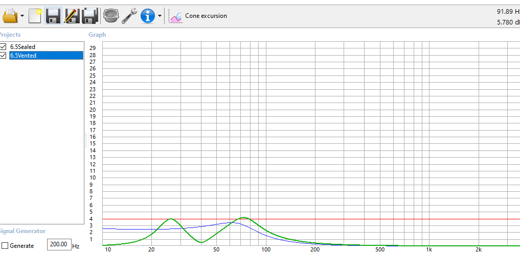

The Infinity reference-1200sm looks like a good choice for the project.This “sub” has specs and user reviews that place it as higher frequency than some of its peers, which is better in my use case. winISD shows it falling off around 40 but close enough. Top end should reach the 200-400hz rollover expected to match the DML’s.

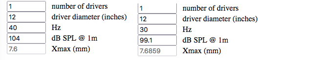

Just going off it's published specs, you can expect to reach Xmax at 99dB at 30Hz (low B), 104dB at 40Hz (low E) with it in a sealed cabinet.

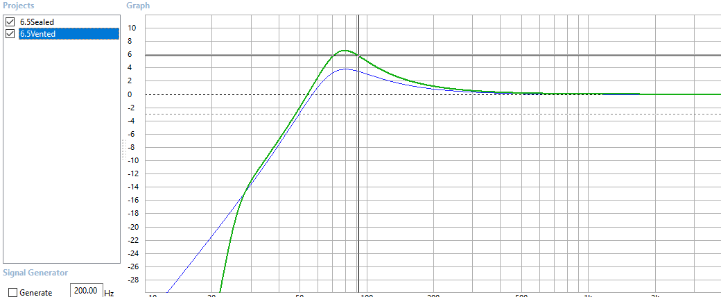

The cabinet suggestions response seems reasonable:
At 2.83volts, (2 watts @4ohm) the sealed does ~80dB @30Hz, 85dB @40hz.
With 200 watts, 100dB@30Hz, 105dB @40hz.
100dB@30Hz sounds about equal loudness to ~50dB at 1kHz, a quiet conversation.
The driver could take more than 200watts, but will be above 10% distortion, and when driven past Xmax, the mids start to sound "gargly".

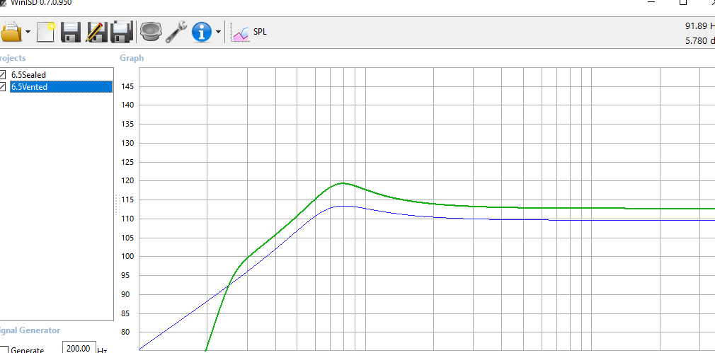

At 2.83volts, (2 watts @4ohm) the 33Hz Fb ported does 89dB @30Hz, 92dB @40hz.
With 200 watts, 109dB@30Hz, 112dB @40hz.
It would be +5dB louder @30Hz, +7dB louder @40hz than the sealed.
Given just 1/4 the power it would be near the level of the sealed woofer.
When you consider equal loudness contours, +4dB @30Hz sounds around "twice as loud".
And consider these are one meter levels- an orchestral kick drum can do ~115dB at three meters, snare ~108dB. Rock drummers tend to do those kinds of levels when "restrained"

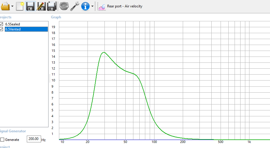

Anyway, since you potentially have the cabinet volume for the bass reflex, I'd suggest using it, you can always adjust the low/high balance with tone controls, but when you can't hear the low end at full power, nothing you can do about it except distort
