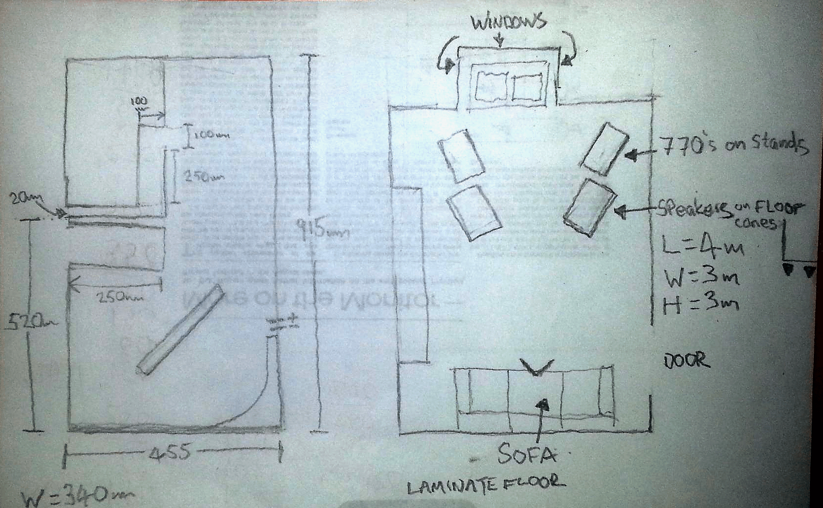

So the best I could do was to scribble on a sheet of paper. The speakers I have had only for a few months with no drawings of its design. The picture of the speakers I have had to estimate what's going on inside using a metal coat hanger. At the bottom I just took out the B139, there I saw the angled wood kind of directing the wave up and below there ay the the back was that nice curve also helping the wave up wards...Greets!

Honestly, a bit confused by the speaker sketch; is the 20 mm the terminus (TL open end) ?

The positions of your speakers and their boundary reflections will cause problems like you are experiencing. Placing them against the wall opposite your couch would reduce many of the issues.

Yes it's 20mm by length of 250mm on baffle'Boom'/'punch' is in the ~100-180 Hz BW.
From what I gathered I don't think they are transmission line speakers. Really I don't know what the builder's intention was. At the first listen of the speakers I had zero bass, why? The whole of the inside was tightly and mean very tightly

I'm gonna remove the 770's and put these speakers their on a stand (some old speakers will do) and go from there.
This got me thinking, my other TL speakers (Pro 9 TL mk1) sound was much better when i had them closer to the front wall. It's gonna be allot of work but im gona do it!

I've removed the 770's and placed these speakers where they were, naw sitting on a 5inch block of dence polystyrene for naw only to lift off the ground. Improvement of sound =yes and in the lower basd also! ! Whoo hooo!!
So it was placement and lift that did the trick. Know I have to add damping material to fine tune.
