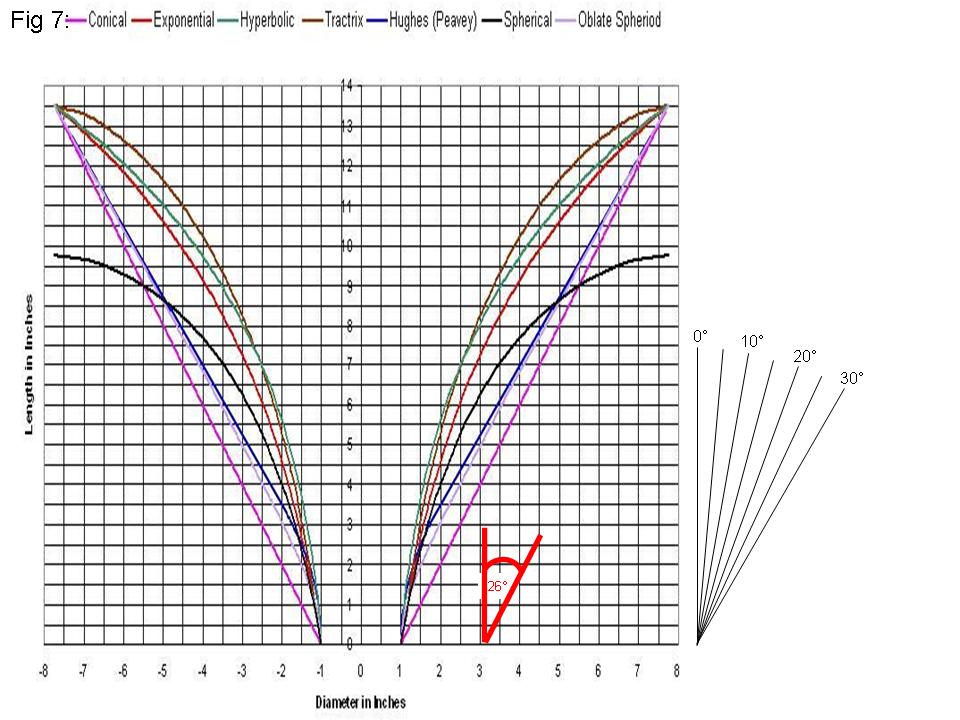

TL/horn theory has a flare factor (conical, expo, hyperbolic, parabolic, radial) and frequency (cut-off) spec.

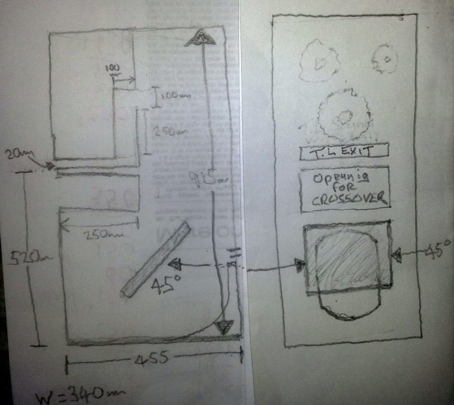

Ok, blocking off the Window area can o use 2in very dense polystyrene? I some, it's what we are yousing for external insulation? Regarding dampening the speaker, in the picture I have shown the 1in piece of wood splitting the rear sound wave into 2. So half goes straight up and the other travels to the back and then up. Question is how much of the wool I have should o use? And at what density? Also how high?
Sure! As long as it's clamped/weighted/whatever so it's inert in the > ~500 Hz BW.
The divider is way too short to do this in the cab's passband, so basically just an internal stiffener, eigenmode/standing wave deflector to keep it from possibly 'drumming' between the top, bottom plates.
Short of doing impedance sweeps, it's basically a fill to personal 'taste' sound wise and no experience with wool.

So an update. .I filled in chamber B139 and the wood at angle hight. Fairly medium density like a soft sponge. I left the amplifier on for an hour or so and then had I listen, I'm probably being biased towards the conclusion but it felt tighter, deeper in control. I'm using a Sony Ta1144 amplifier.
