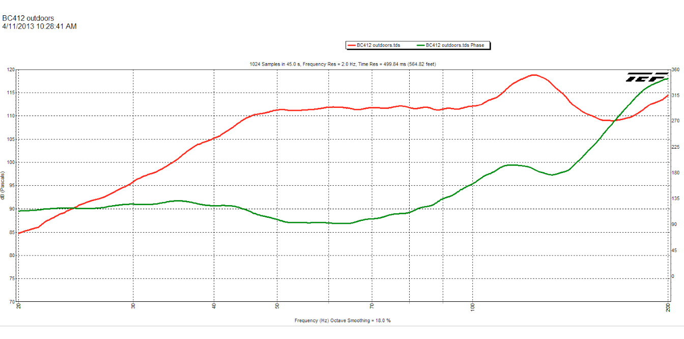

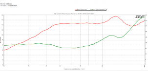

Quad loaded FLH, large frontal boundary area.According to the video, "this uses a completely different alignment than anything we've done at Danley Labs"
Gets loud, rolls off below 40 Hz.

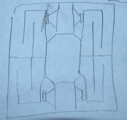

A fold pattern like this would probably get the FR it has with the right drivers:
A rehash of the BDEAP style methinks.
Art the driver hatches appear to be on the outside corners.

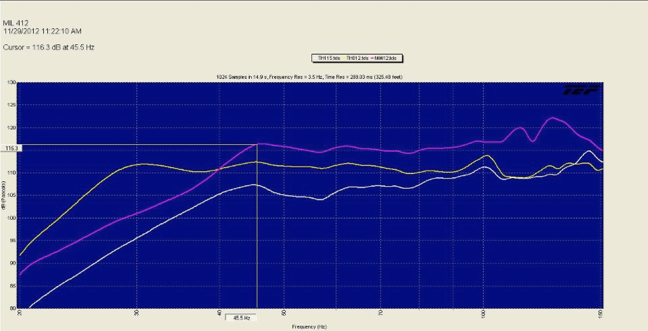

He seems to have dropped the former working name MIL 412 after the military failed to engage.
And correction to my post #3, the MIL 412/BC412/IHOP rolls off below 45.5 Hz, not 40 Hz.
Judging by the popularity of subs here with similar LF corner, there is a much larger contingent of those willing to sacrifice low for LOUD.Hmm not much of a "sub" then. Looks to be the size of two (roughly) TH-118's (laid down on their sides, stacked on top of eachother)
Each sub does suit specific needs thou, so maybe this is a good option for someone needing LOUD above 45-50hz.

Most of the "suck the air right out of your lungs" slamming and punching goes on upwards of 80 Hz, where the BC 412 shines, though it would require something below for pants flapping EDM, as it drops at about 20 dB per octave below 44 Hz.
At 106 dB one watt one meter, it is hot for a cabinet only 50 x 50 x 18 inches!
