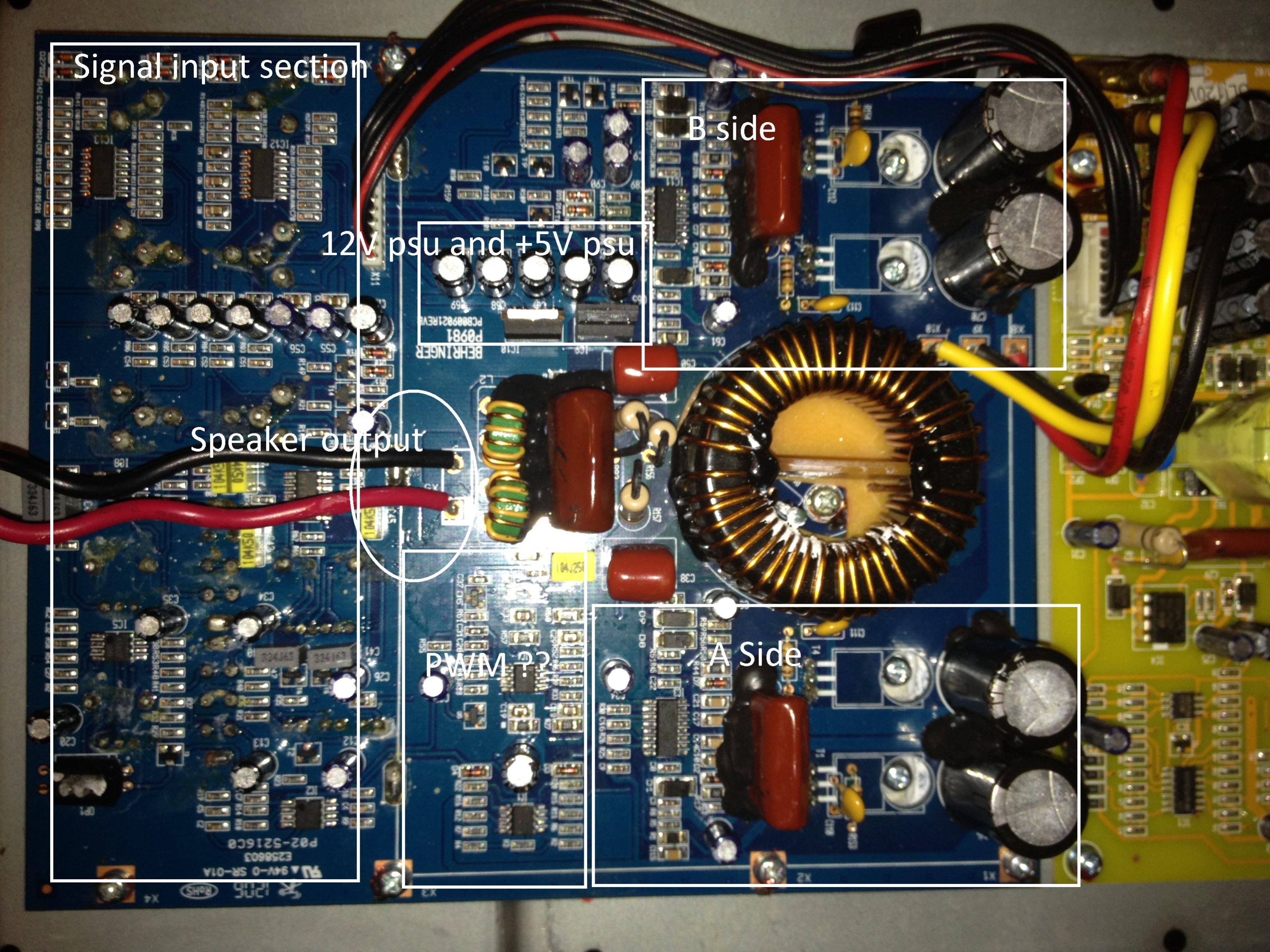

Hi All.. new to posting but have been lurking for a while reading and trying to learn about Class D amps. I have a Behringer B1800D Sub with integrated 1400W class D.. Amp has failed and am trying to repair it. If any one has schematic.. that would be a lot of help.. but I have looked and looked and cant find any.
Anyway.. buy using what I have learned here and looking at tech reports and data sheets here is what I think it is.
Class D 1400 W..H bridge amp. using self modulation Delta Sigma
Uses IRS20955 gate drivers.. The Fets are IRFB4227;s

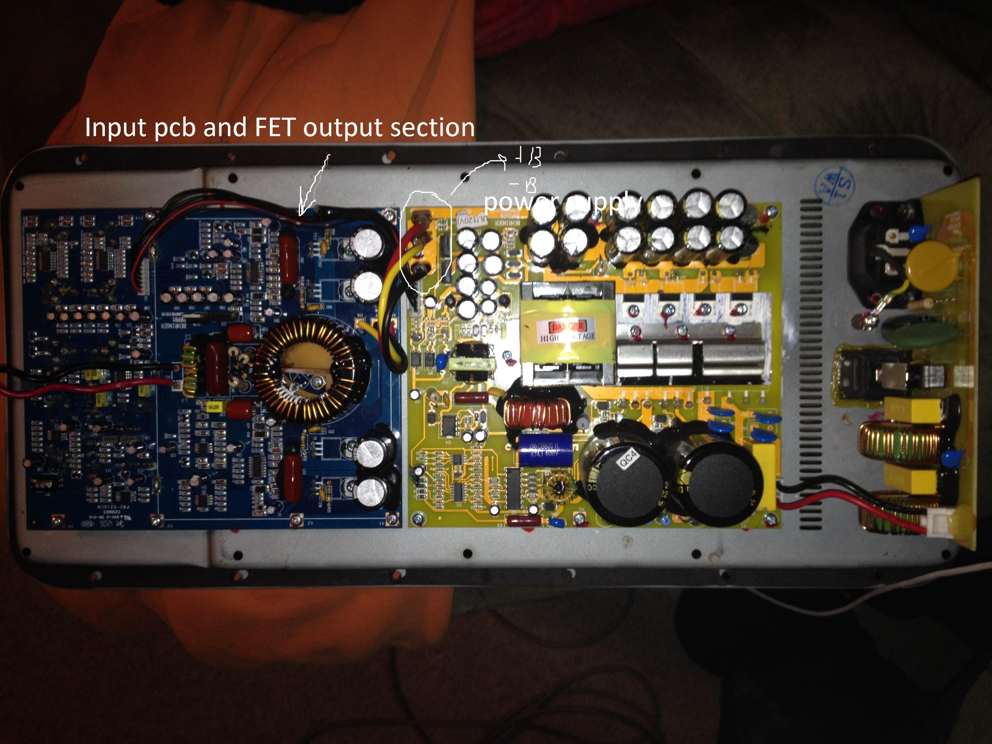

I measured +B and -B at about 78 volts. PSU is Behringer SMPSU28
Input and power stage are on Behringer pcb type P0981

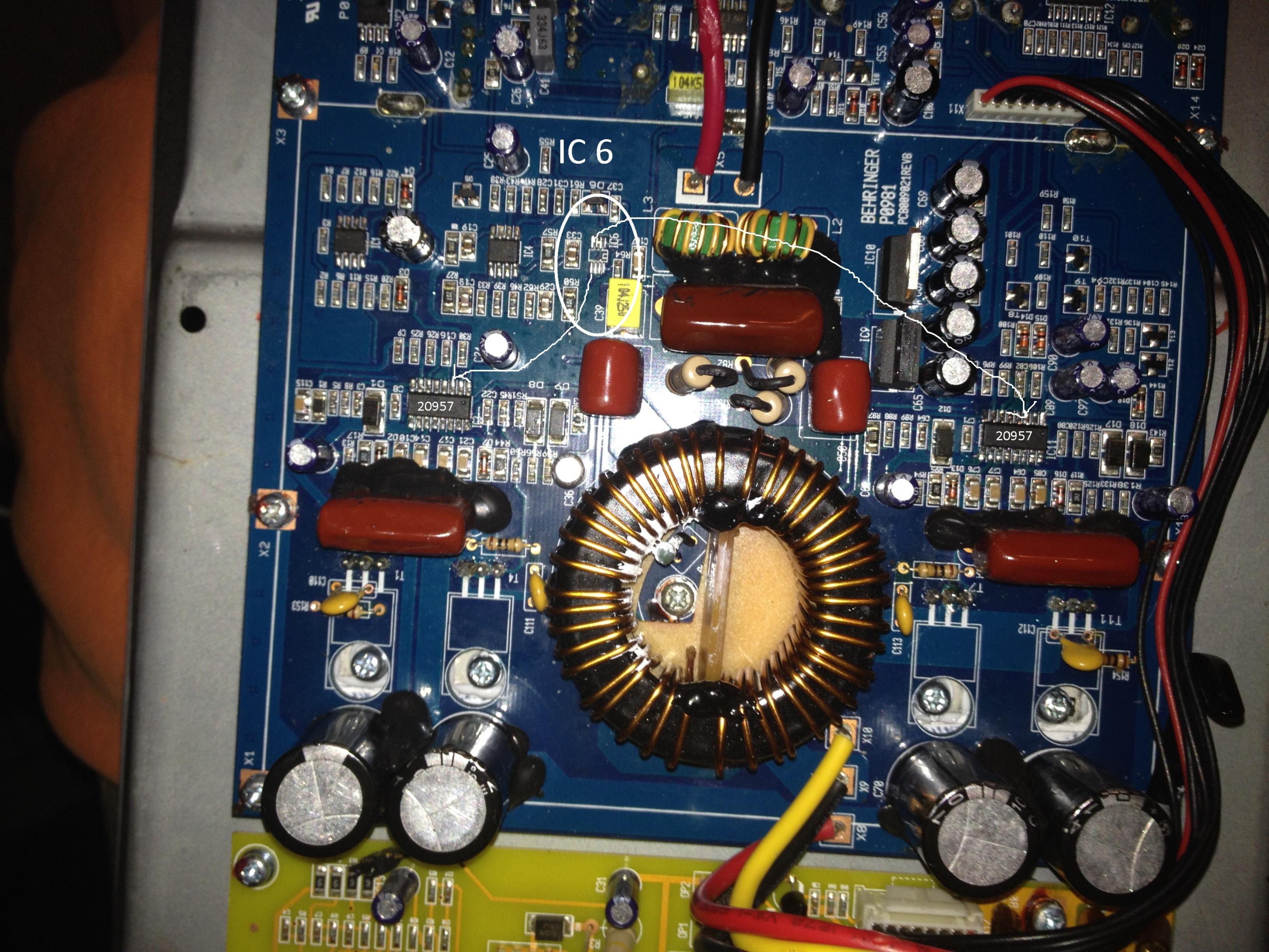

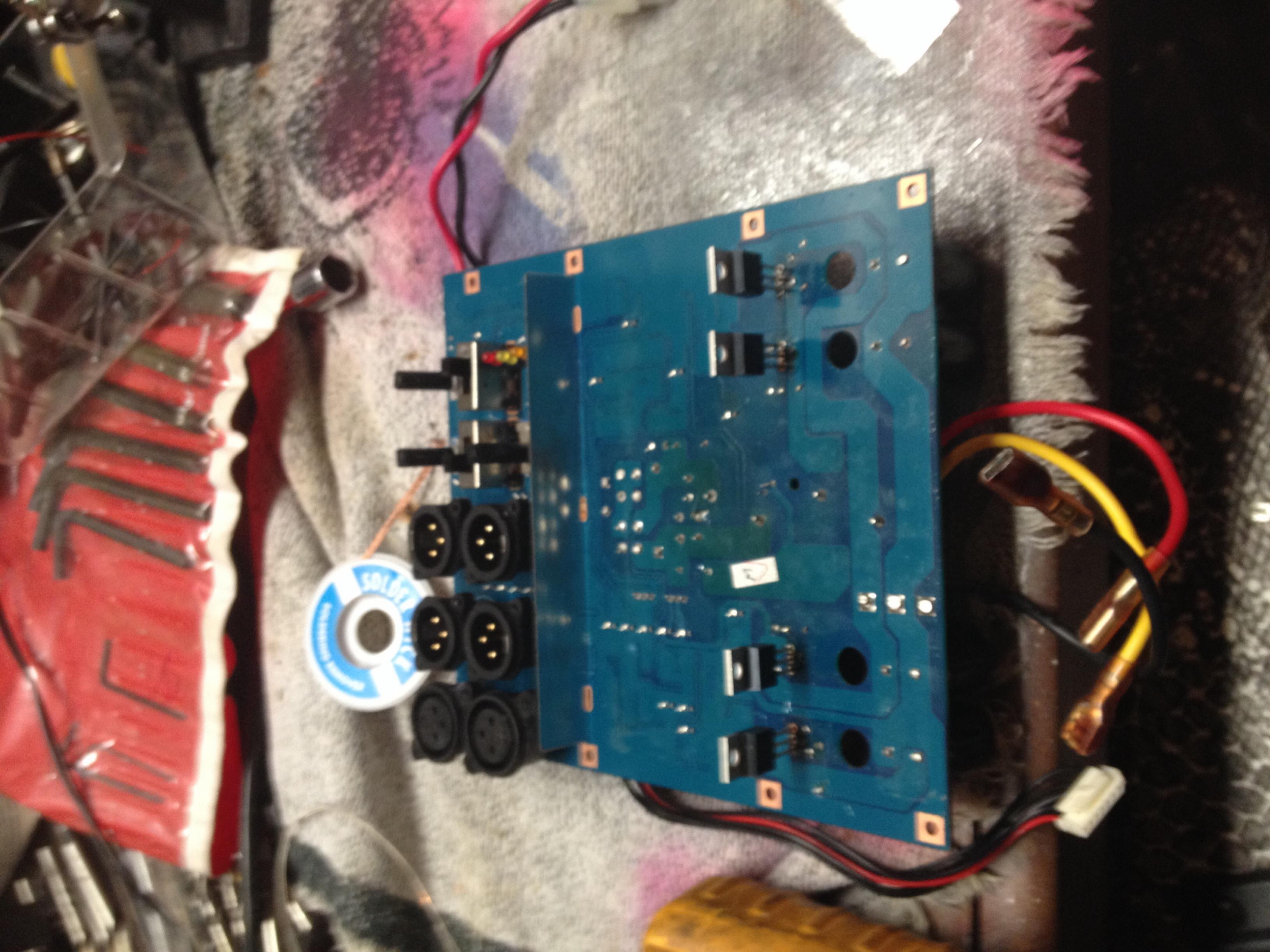

I have included some pics of the amp and close ups for reference.
The Amp seemed to fail in steps.. My son said that the Protection light was coming on, but the sub was only putting out about half power. Then it continued to worsen to the point were it would not work at all. Power light would come on.. then Protection would flash and you would here a pop in the speaker, then it would just repeat this cycle. Eventually not even the power light woudl come on.
I unplugged the PSU connections to the P0981 pcb and all voltages seem ok. I did more digging and found both Fets on the B side shorted. Also after doing some resistance measuring and comparing from A side to B side. i determined the 20955 on the B side was toast as well..
Ok, so figured I had it nailed.. I replaced both 20955's with 20957's and replaced all 4 fets just because.
After doing this, I was able to power up the amp. Power light comes on then after a few seconds the Protection LED flashes and that cycle continues. So obviously something still wrong. I assume OC protection. I checked all voltages again at the 20957's everything seems to be where it should be. I watched the V(ds) on the fets with a scope and I see on the A side the High side fet is trying to turn on, voltage is at about 68vdc and drops down to about 30Vdc when the fet turns on for brief moment before the 20957 goes into protection.. On the B side.. I see again the High side fet turning on but the 68 Vcd drops to 0. So.. I think that there is some issue on the A side.. Fet is not turning on all the way or something as it should drop to close to 0 as well. In doing some checking all the sudden the amp stops the reset cycle. I just see the Protection led flash once at poweron.. CSD is charged to 10 V. I found now that VB to VS on the A side is only .8Vdc.. So I probably damaged the chip while trying to check it..and Vbs is not at 15V so chip is not starting up. I swapped the 20957's to confirm the issues moved with the chip. It did.. so I replaced the 20957. Now the amp powers up.. starts to cycle as before. I also noticed the there is just 4.5 vdc on pin 3 ( in) on the A side. and 3.5 on the B side. I measured resistance to gnd on pin 3 and on A side it is about 700K and on B side it is 212k.. so something not right there either.. anyway to make a long story short. i was doing some more testing.. Amp turned on and LIMIT let was on a long time and amp made a weird noise then power shut off and now the A side fets are toast and so is the 20957..UGH..

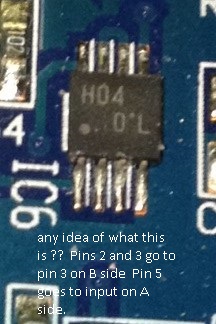

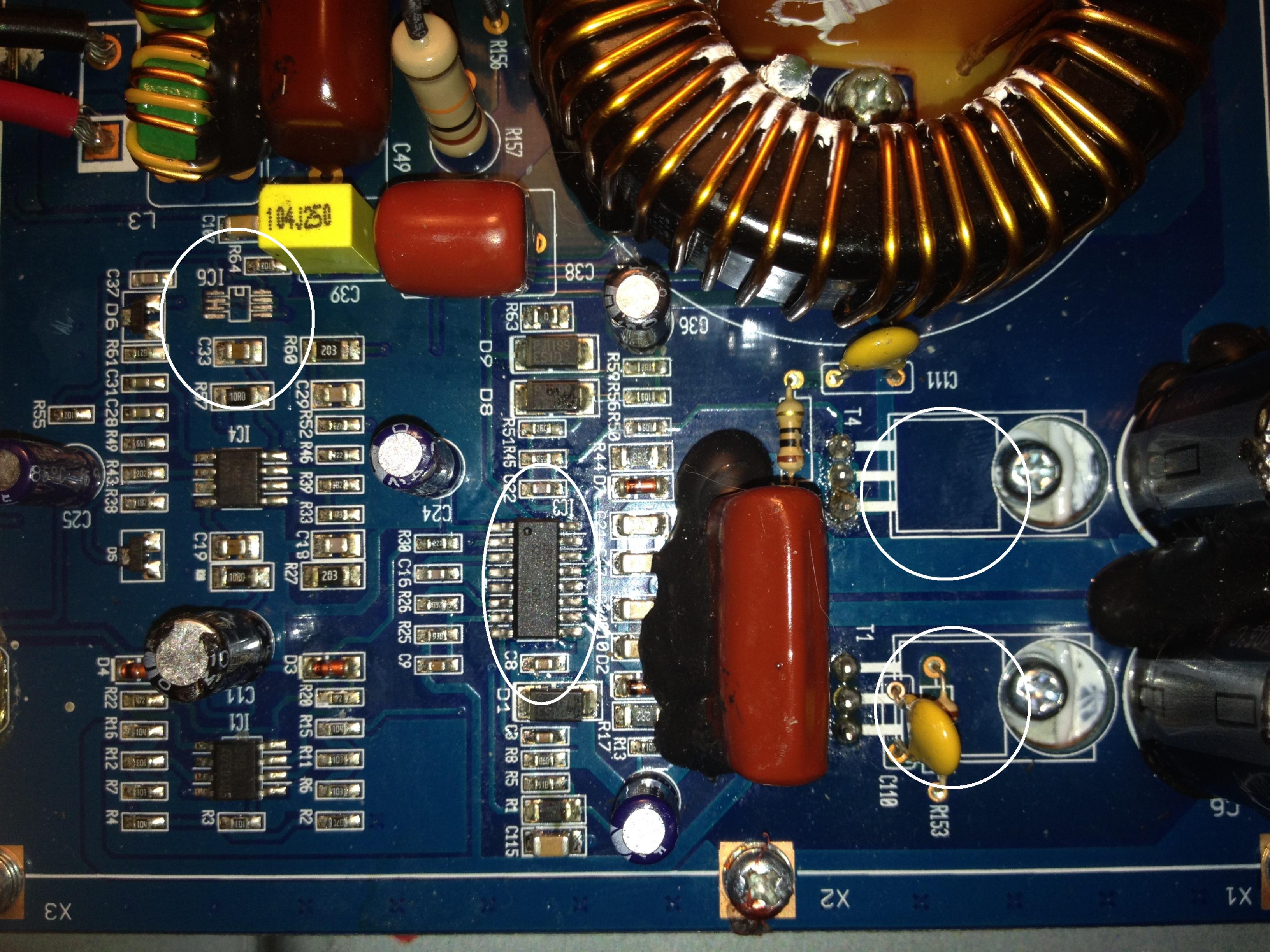

5) I included a pic of a chip I can't identify.. it is IC6 and has 8 pins It has H04 0'L on it.. I think this is part of the pwm circuit.. i was able to kind trace the singal flow from input to this chip. and I traced from this chip directly to pin 3 on both A and B sides.. I pulled this chip and then when I measure pin 3 to gnd both sides read about 700K ( before B side read 212 ohms) so I think this chip is also toast. I tried powering up the amp with this chip removed and it still did the OC thing and such and then that was when it toasted the A side fets.

Well I replaced the H04 IC it was bad. This IC is being used to invert the signal for the Full bridge design..I was getting nice Square wave out of it ( was inputting 80Hz sine.. So that seemed good now.. Powered unit up and it is still cycling.. Grrr.. I can see for a brief moment a Sine wave at the ouput.. so seems like the Class D is starting up and working.. then going into protection.... still.. I then cranking up the input gain.. and it blew up again.. LOL.. it took out the FETS .. damaged the driver IC IRS20957 and also damaged the H04 ic again.. so.. at least I know for sure what gets smoked when it goes out.. So.. back to the drawing board.. I hate trying to trouble shoot with out schematics.. Thanks for the help up to this point..
