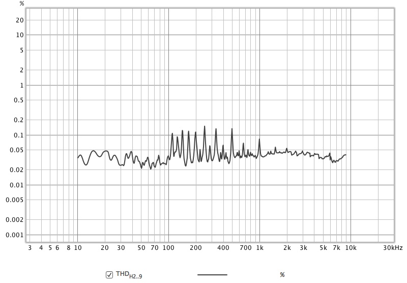

Respectfully, here is a distortion measurement made at a low two bars input. The test circuit is long and includes a variety of quite elderly and cheap devices and rusty cables. The laptop feeds a USB-to-SPDIF/coax converter I found on eBay cheap, as the input is digital. Test is 10-20kHz, no kidding.
Perhaps speaking only for myself - and I like great music from my ESL speakers - .04% THD at just 2 bars meets my standards.
There is no need to bother to post the 10-20kHz FR.

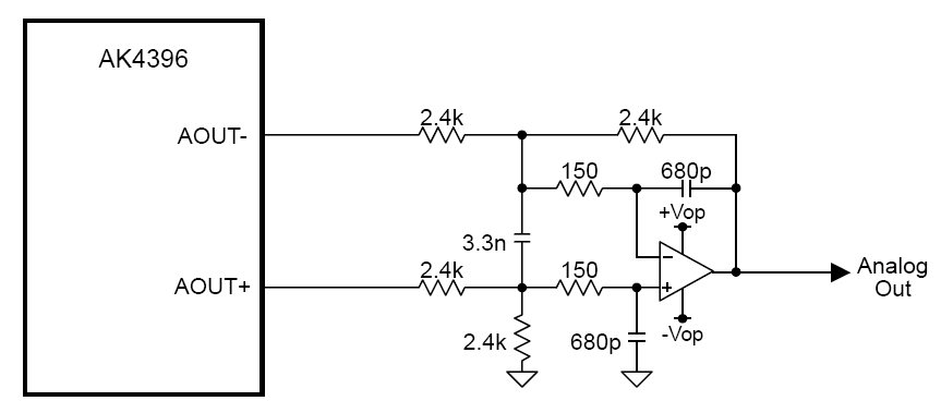

I'm tuning my DCX2496. I use unbalanced outputs, so I removed the operational amplifiers at the balanced output, shortened the signal path and changed the element values to those suggested by the manufacturer AK4396 in datasheet. I still have AK4393 but I will soon replace it with AK4396. I installed sockets for the amplifiers so that they could be replaced and installed ne5532 (channels 1-4) and opa1612 (channels 5-6).
Since this modification, I have been struggling with the problem of strange, irregular signals on channels 2 and 4. The sound resembles tapping and rubbing a fingernail on the membrane, and sometimes crackling. Sometimes there is silence for two hours until it suddenly appears, and other times it happens right from the moment it is turned on. Has anyone encountered such a problem?

Usually lose connections cause such problems, on one of my dcx I had to replace the 6 small caps just after the dacs, it had similar problems.

I had the flat cable connector at output board side with lose connection. cheap Cina crap....
Yes, I changed all the connectors and ribbon cables on mine, two times already. Also, if it's silent for 2 hours and then starts crackling, it sounds like a result of thermal expansion, therefore likely a cold solder joint anywhere in the path, including the connector itself.
