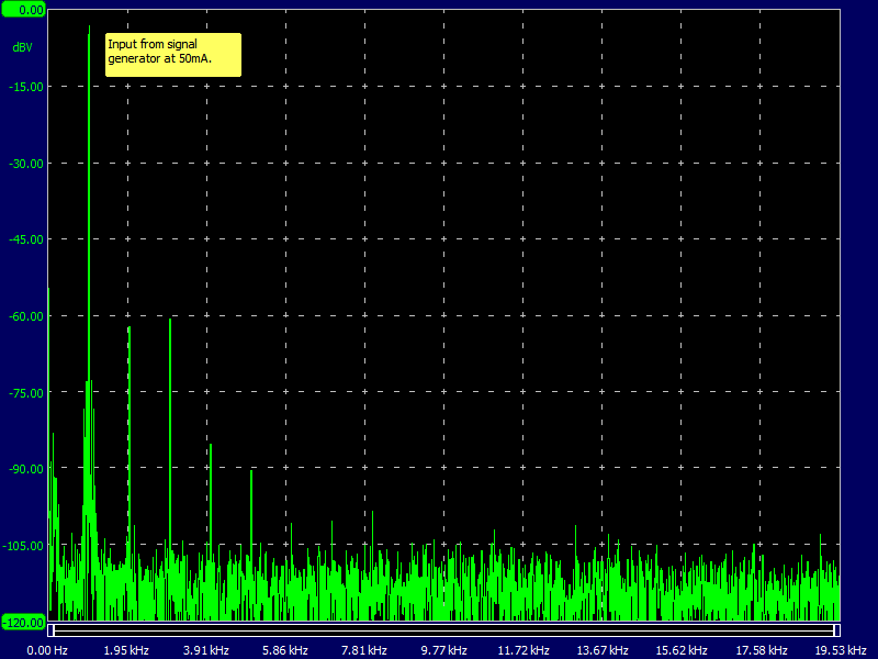

At the suggestion of one of the LA readers, I injected a 1kHz 25mA current into the output node of the regulators in the test, (and some which have subsequently been sent to me), and took an FFT to see how the error amplifier was influencing the signal.

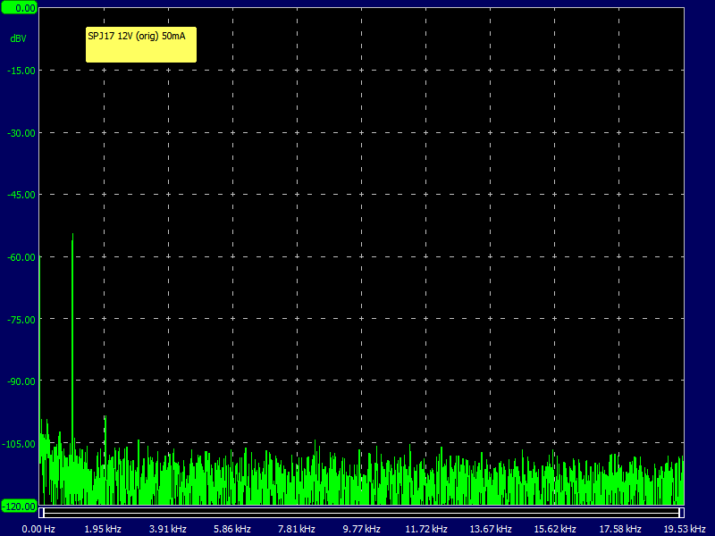

Jack, injecting a signal on the output gives an interesting figure of merit, it's great of you to make those measurements. I put a bench setup together to do my own and connected the coupling capacitor backward. After a few minutes there was an ugly noise and I got nervous that the signal generator output was damaged. After some time I figured out it was the capacitor that popped, but that made me nervous anyway about damaging the signal generator.
So I ran the generator to our ripple rejection test setup as a high current low impedance driver to a 10 Ohm resistor in series with ten parallel 22uF BIPOLAR ;-) caps that then go to the regulator output. A true RMS meter was put between the driver and the 10 Ohms and the sine wave amplitude was adjusted so the meter reads 50mA rms.
Our original SPJ17 at 12V shows a fundamental at about -54dBV, not as good as your AP measurement of -59dB (although there could be a difference in input signal). However, the 2nd harmonic is at about -100dBV which is over 5 times better than the -86dB you saw. I'm not sure what could be the difference, perhaps the load affects the AP output?

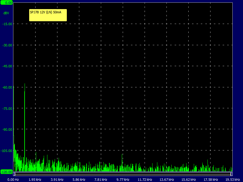

We're about to announce a redesigned product with lower noise (you saw it here first) and it looks better than the original SPJ17, at -57dB fundamental and -106dB 2nd harmonic. An FFT of the buffered generator signal taken at the driver/10 Ohm resistor junction is included as a baseline reference. The sig gen is not an Audio Precision, just a venerable HP200CD that has significant harmonic content.
As a sanity check I plugged in a LM7812, a LT3080@12V, a LM317@12V and some of the other non-monolithic ("boutique") ones you checked, which show similar qualitative results although the numbers don't correlate exactly.
