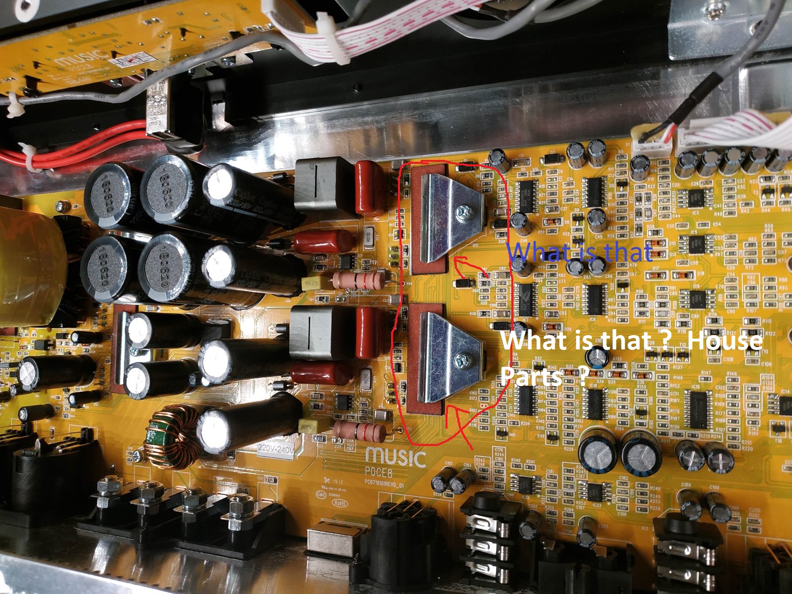

Under the PCB there are two MOSfet´s, probably IRFB4227 or the like. Instead of using two screws, which can be tightened wrong, Behringer uses one screw, a metal piece and some softer material for even pressure distribution. The heat from the FET´s is transferred to the cases lower cover.
So the chance that the FET´s get too low or too much pressure, is reduced. Remember where they produce! You can see the 2x3 contact solder points on the left of your marking.
As this is a Studio and no PA amp, this should be just fine, needs no (loud) fan and has no heat sink that can be covered with dust over time.

I would guess the FETs are TO220 FullPack not needing any isolation. You can get 4227's in fullpack also. Take a look at the guidelines here:
https://www.infineon.com/dgdl/Infin...N.pdf?fileId=5546d462677d0f460167bba4f4e81abd
And read the schematics for iNuke 3000 ... I think the A800 is very similar.
A few things seem to have been added though, especially around the output, where you find a so8 chip (does it read 311 ... so a comparator?) ... not sure what this is, and also the smal SOT23 on the picture called IC13, maybe a small temp sensor? ....
