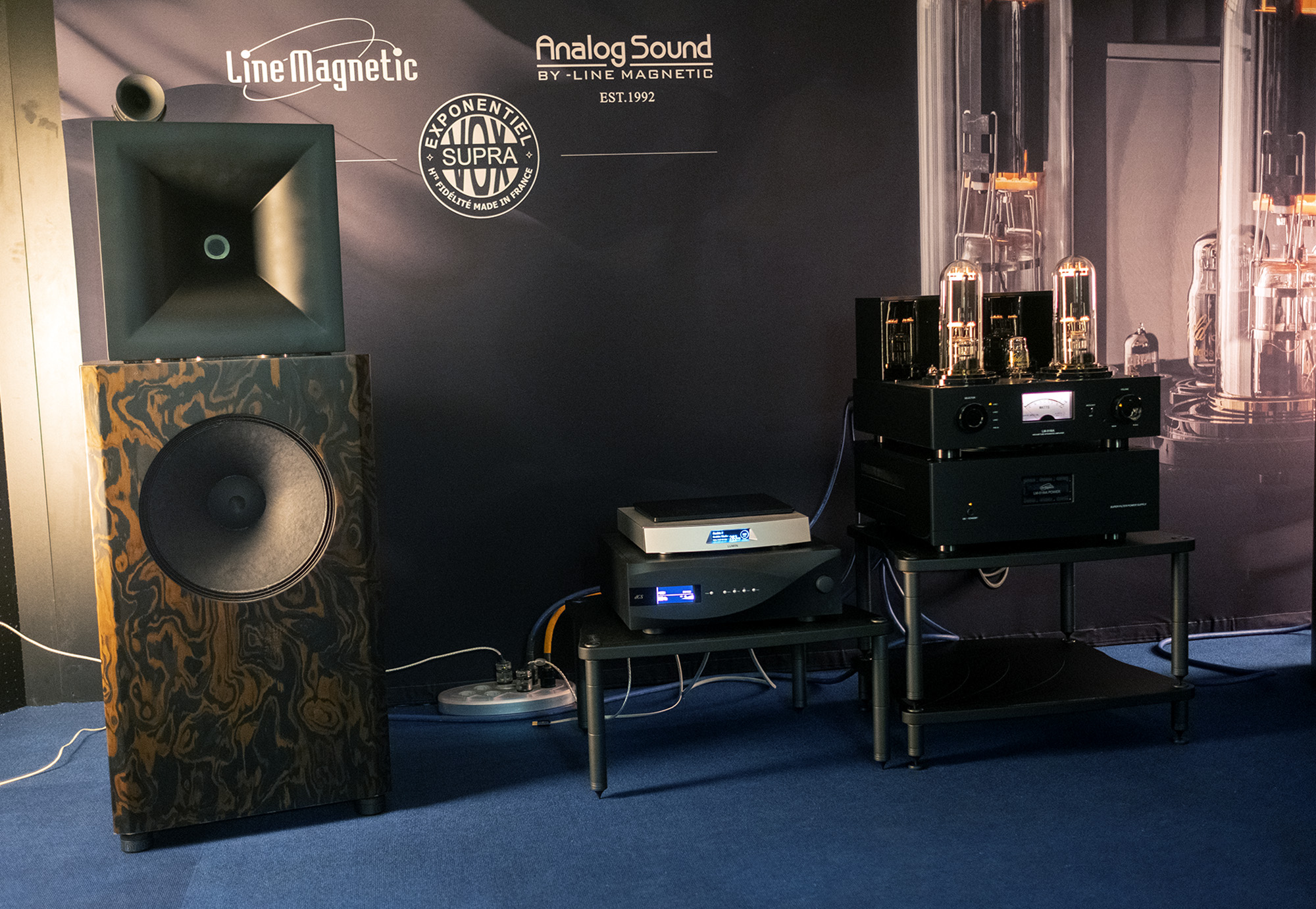

Radian drivers are interesting, especially the 7-series, but QC appears to be lacking compared to the big brands.
A 7-series neo driver is also used in this relatively simple Supravox 3-way, which quite a few people seemed to like at Munich High-End:
