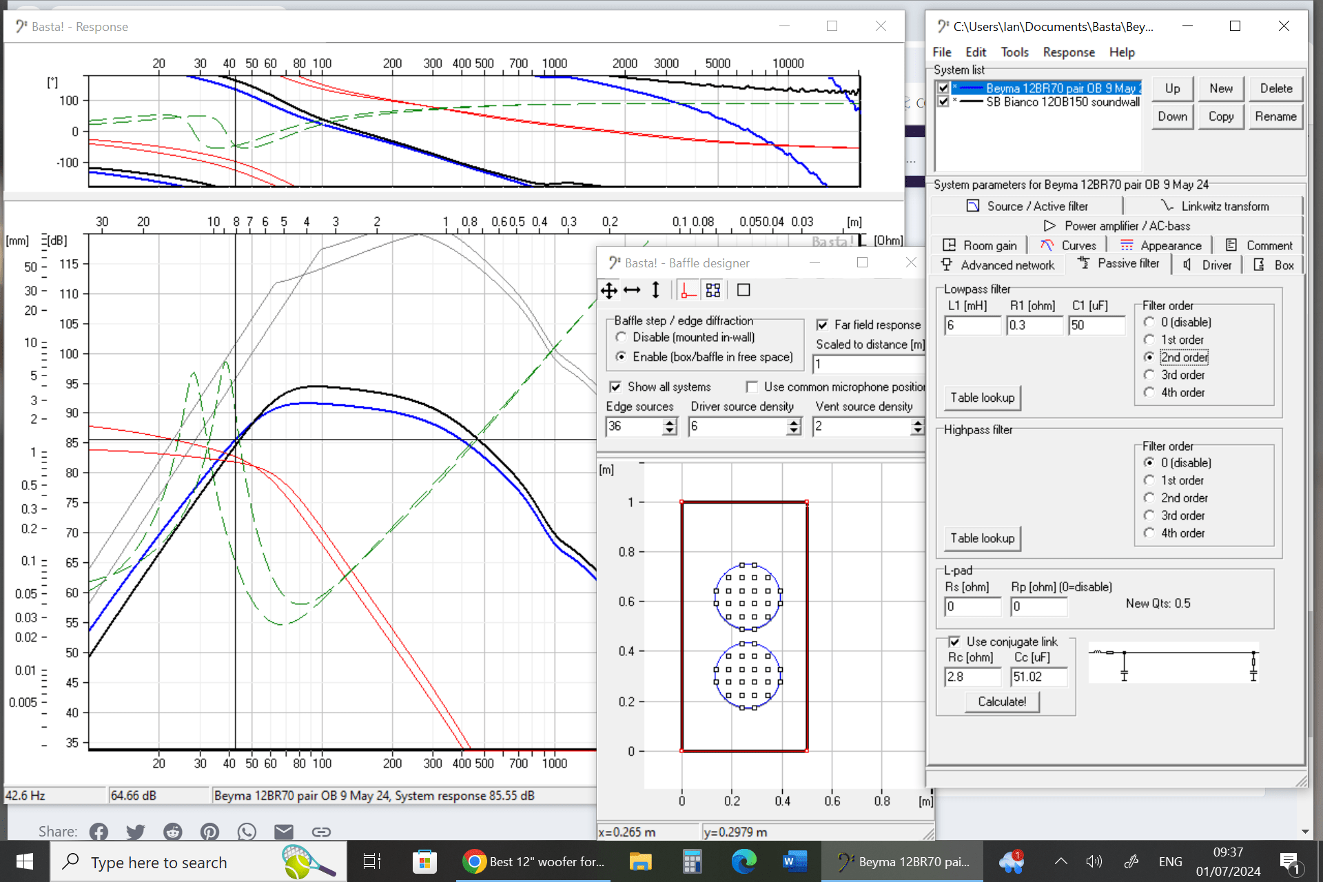

@jerome69 No need to scold me! A driver with Qts of 0.5 can easily be used on open baffle with a passive network.
The difference in Qts between the Beyma (0.5) and the SB Bianco 12OB150 (0.63) is not a huge issue in this context.
Below is a Basta simulation of them both with the same simple passive crossover consisting of a 6mH inductor and 50 uF cap (plus impedance compensation). In both cases a pair of drivers is connected in parallel, and mounted on a 50cm by 100cm baffle. The blue SPL trace is the Beyma 12BR70 - it has about about 3dB less sensitivity, but more bass extension, -6dB point being around 43 Hz. The black SPL trace is the SB Bianco - it only reaches 51 Hz, -6dB.
The heavier cone of the Beyma (74g as opposed to 52.4g) is probably the key difference.

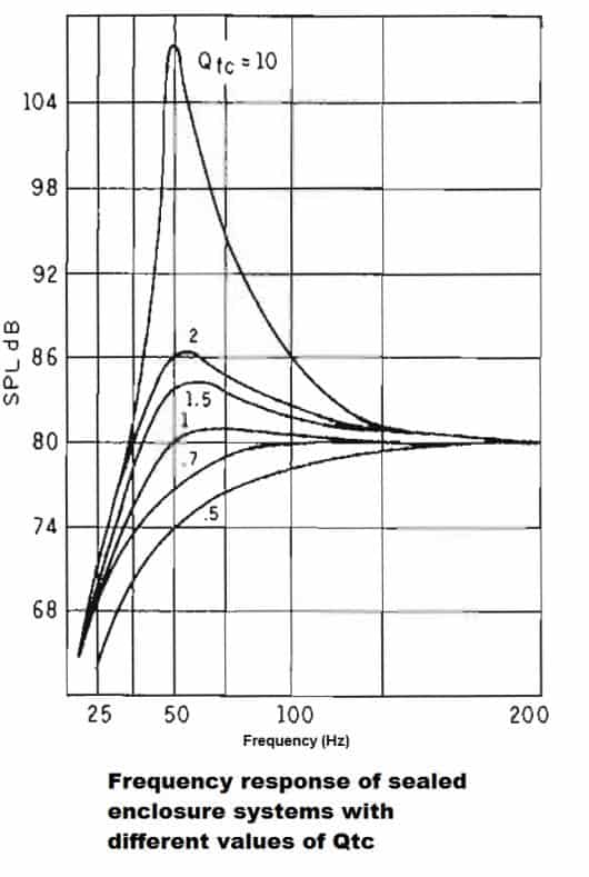

Thanks for pointing this out. I was aware of the graph for boxed speakers but not sure how to connect it with open baffles?Historically driver Qt = desired transient response = Qtc, so 0.5/transient perfect - 0.707/max flat
The driver I´m using has a Qts of 0.4. If Qtc=Qts then it might be what explains the "anemic" midbass I´m hearing.

You're welcome!Thanks for pointing this out. I was aware of the graph for boxed speakers but not sure how to connect it with open baffles?
It's certainly a significant 'player' with baffle size the other.
