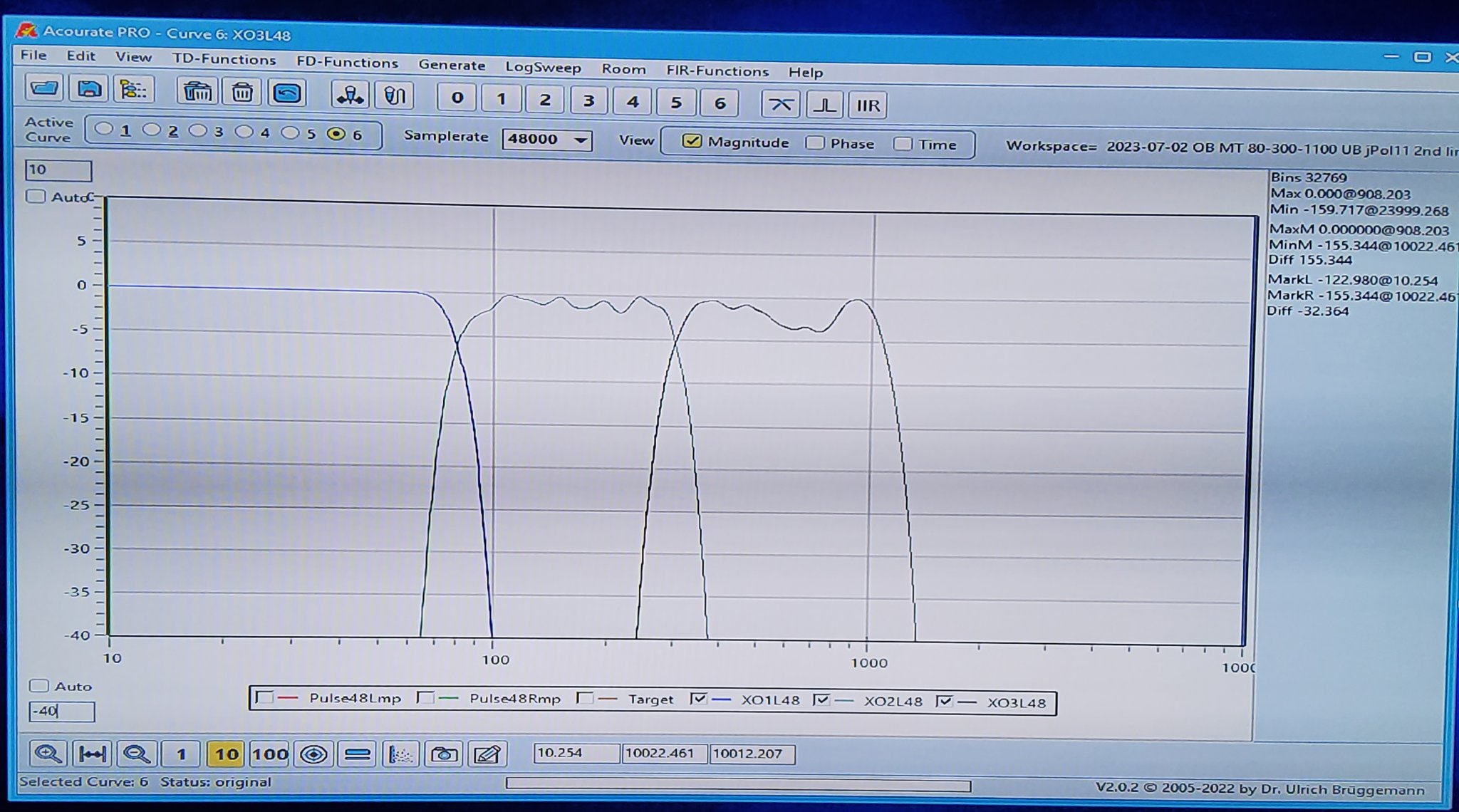

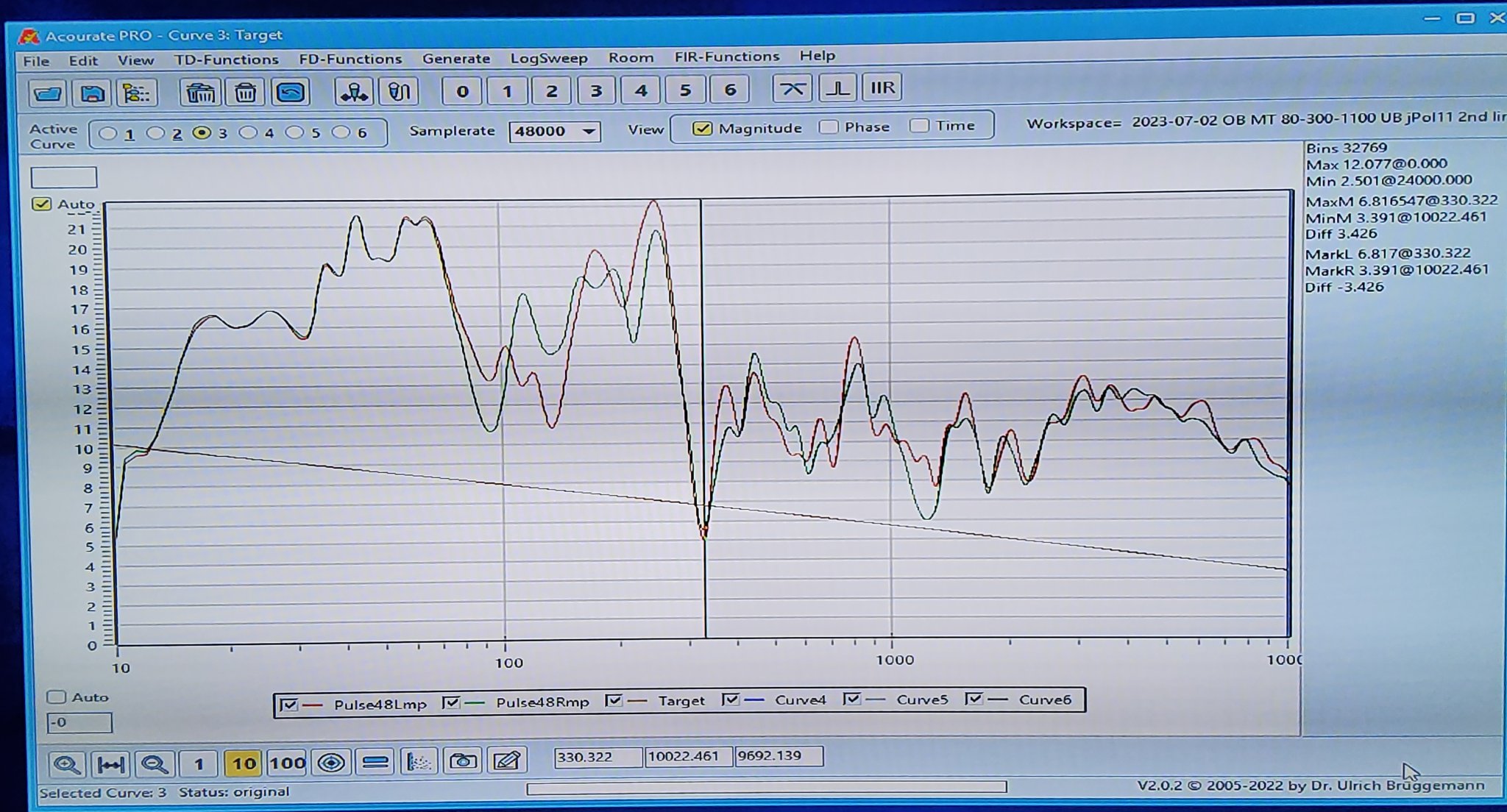

Some measurements from when I developed the filters in Acourate.
First graph shows left and right sweep measurements using the digital xo, also the target curve against which the speaker response is hammered into shape:
You can see the massive drop of the 18" starting around 280Hz.
These are the xo:
Sorry for the picture quality and size...couldn't format well on Android.

I understood, sure your crossover is not working ! You don't have any open baffle equalization .... Sure you don't have any low mid and you can better with less.

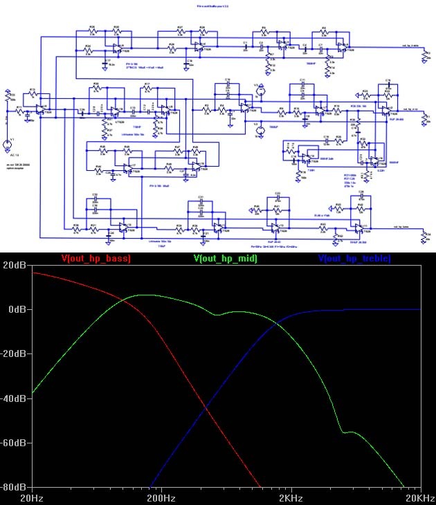

This an example of crossover I done. I include the dipole equalization and delay correction.
With your numeric crossover you should do the same crossover response.
Bass correction is red curve - Green is mid curve and blue is tweeter curve : the only normal curve without dipole correction. The mid curve is a little more complex du to mid-bass correction.
To make dipole correction you should take into account the dimension of the baffle. Here the baffle is 30 cm wide, a dipole equalization 20-400Hz is done.
Note you can do a global dipole equalization (see Perry Marshall designs ) or for each drivers.
