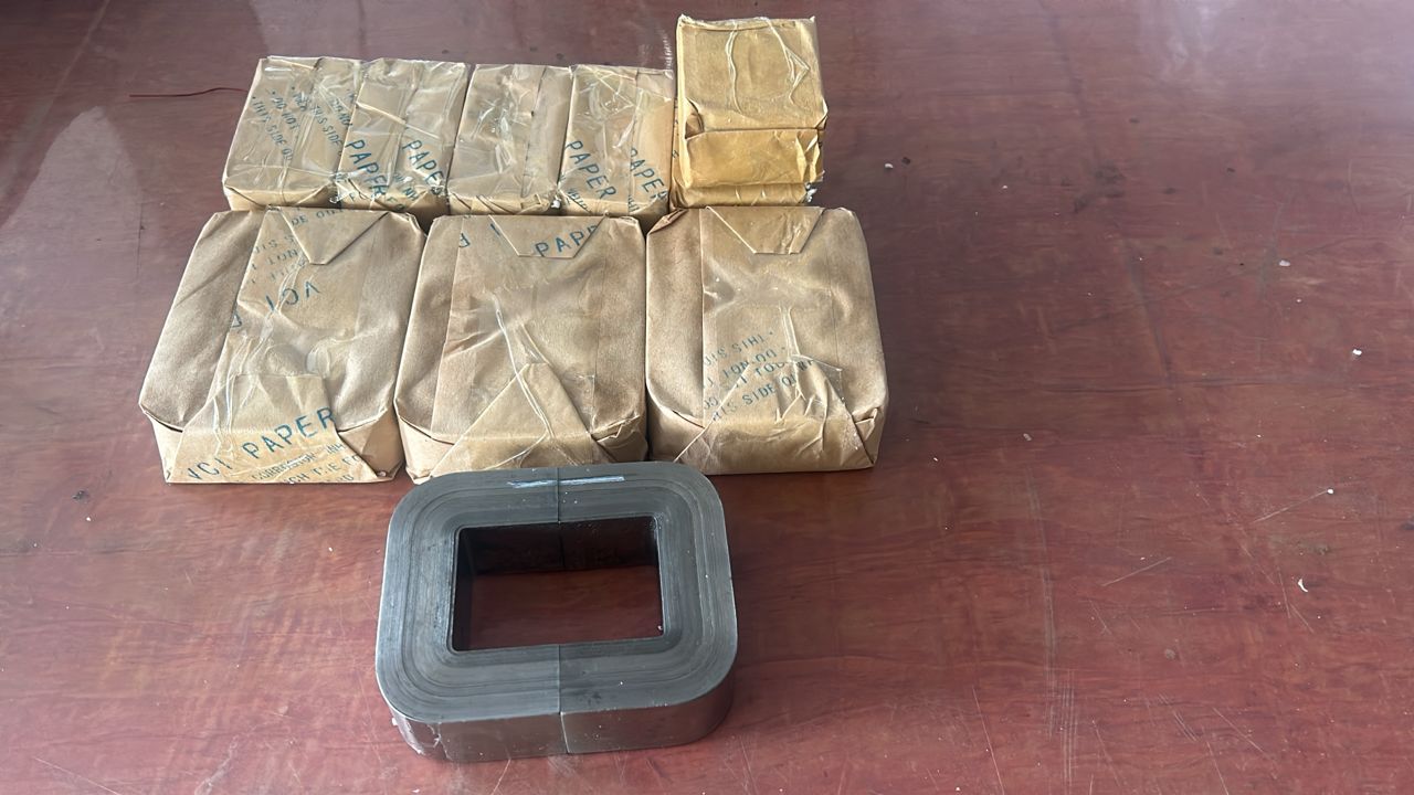

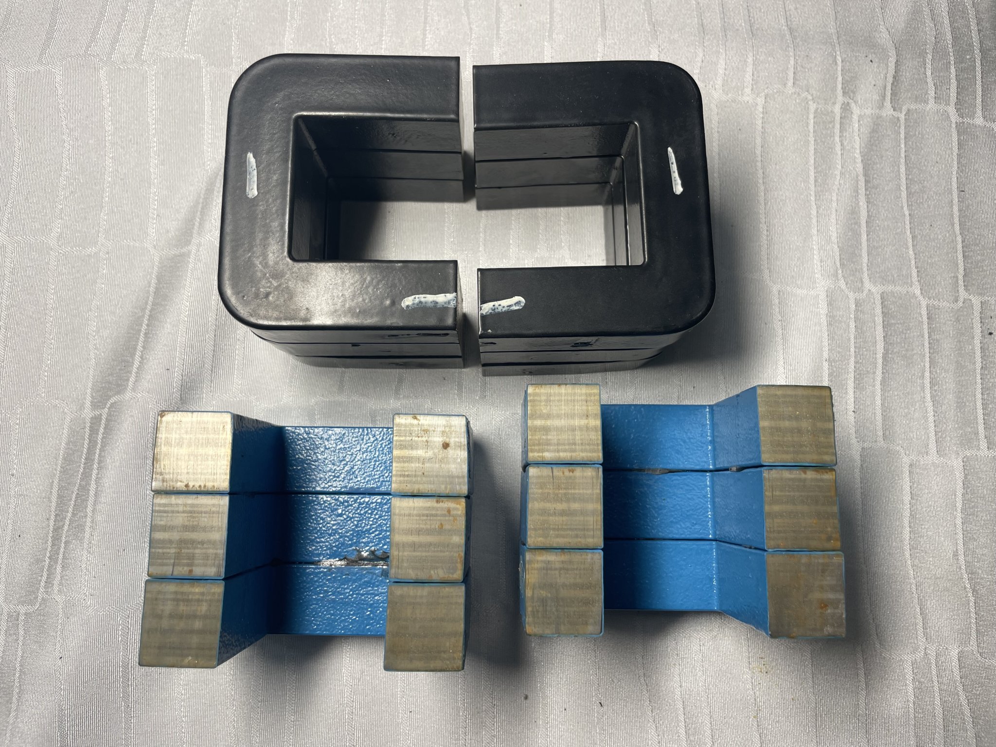

You can pick up any supplier you like from China on Alibaba. They ship worldwide. BTW, I would suggest if you order amorphous or nano-crystalline add an option - epoxy coating.You must tell me where you got them and the cost! Write in private if you like.
Thanks. Do you find the quality to be that good or do you need to specify it? I am especially thinking about the cut and the matching.You can pick up any supplier you like from China on Alibaba. They ship worldwide. BTW, I would suggest if you order amorphous or nano-crystalline add an option - epoxy coating.

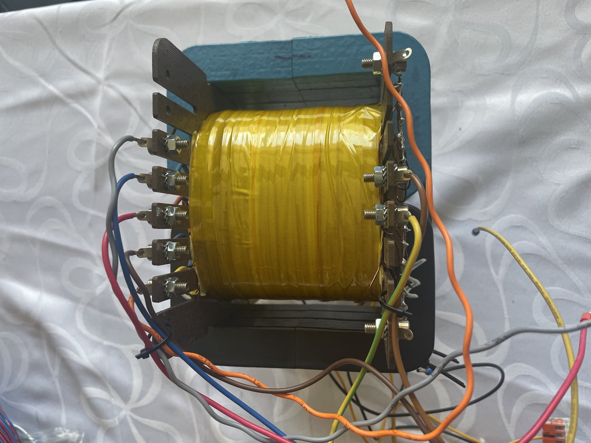

Why not just make the cores clamped between the two metal plates wider to fill in the gap in the coil former? How is the pictured design better than that?can explain better ?
There are just a handful of amorphous/nano ribbon manufacturers in China, so you don't have much choice anyway no matter how many core suppliers you find. Main were from from Anhui Lizhi Magnetic Material. Once you air-gap them, any discrepancy in permeability will be insignificant. I tested amorphous and nano in push-pull output transformer, and sold out all pairs of amorphous, left only 1 pc of unpaired nano. Decided to stick with HiB cores, finished product quality is roughly same, yet GOSS HiB are cheaper and smaller for same level of flux density.Thanks. Do you find the quality to be that good or do you need to specify it? I am especially thinking about the cut and the matching.
