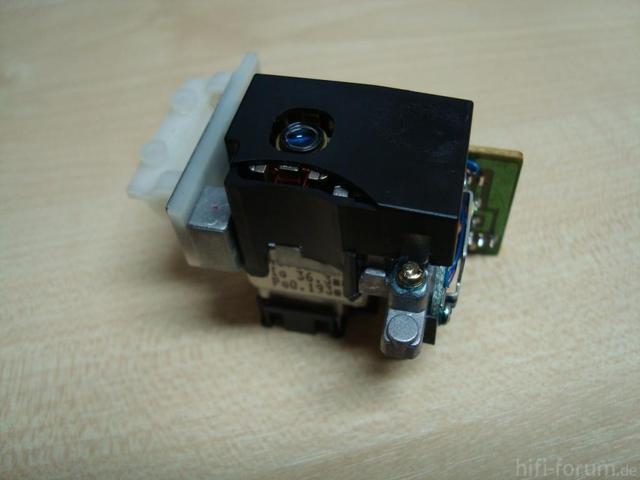

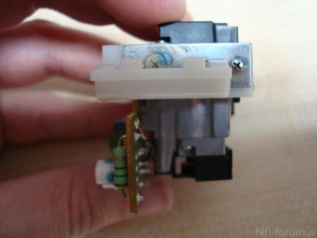

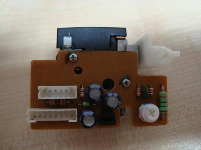

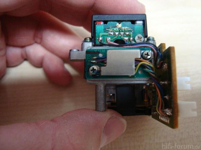

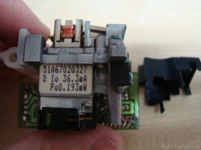

In the meantime I recommend user's, who looks for vintage cd player follow models:
A: Top Loader:
1) Krell MD-1 (the only model from Krell without custom made MCU)
2) Micromega SOLO/DUO/TRIO from first series without CDM9-pro (i. e. with CDM1-CDM4)
B: Loader & Tray:
Linn Karik (Laser-Unit: Hitachi HOP-M3)
Linn Karik Compact Disc Player - which Loader ?
Nakamichi OMS5/OMS7 (only with NEC HLPL030020)
Gerner Electronics, Laser pickups, Flexboards, Beamerlampen, Messgeräte
very cheap in used condition:
Cambridge Audio CD-4/CD-6/Discmagic (Laser-Unit: Sanyo SF-91)
NAD5320 (Laser Unit: TAOHS-JP1)
http://vintage-audio-laser.com/liste_dac/images/optique/taohsjp1.html
also very good are most JVC versions with laser units from the Optima series so as most models equipped with the previous mentioned laser units. In my experience, these laser units are very reliable and (probably for that reason) not hard to find and still available.

Onkyo's DX1200 and DX120 uses a laser unit without typing - go to
CD-Player-DAC-Transport List
this forum mentioned only the number "241070" - go to
Unbekannte Lasereinheit, Hifi-Klassiker - HIFI-FORUM
and
Gerner Electronics, Lasereinheiten Laufwerke, Displays, Touchpanels, Folienleiterbahnen u. Reparaturservice
and the images from attachment.
Looks similar to TAOHS-JP1 from Olympus - go to
Changing TAOHS-JP3 vs TAOHS-KP1

tiefbassuebertr, thanks for that info! Your photos show precisely the same optical pickup which is in my Onkyo DX-120.Onkyo's DX1200 and DX120 uses a laser unit without typing - go to
In regards to TAOHS-style optical pickups, there appear to be several different mechanical designs for how the pickup interfaces with the guide rails.
the TAOHS-DG2 in the Onkyo DX-120 has a white nylon plastic slider which is attached with two screws. I assume there is sufficient clearance for the mechanical alignment to be adjusted precisely before the screws are tightened. I've been careful not to disturb the nylon slider position. Its existing mechanical alignment appears to be correct in my Onkyo DX-120.
Other versions of TAOHS pickups have sintered bronze slider bushings which are permanently press-fit into the aluminum case casting.
When I searched the CD player DAC transport list I discovered numerous Yamaha CD player models which contain TAOHS pickups. Carver, NAD, and Kenwood also used them.
