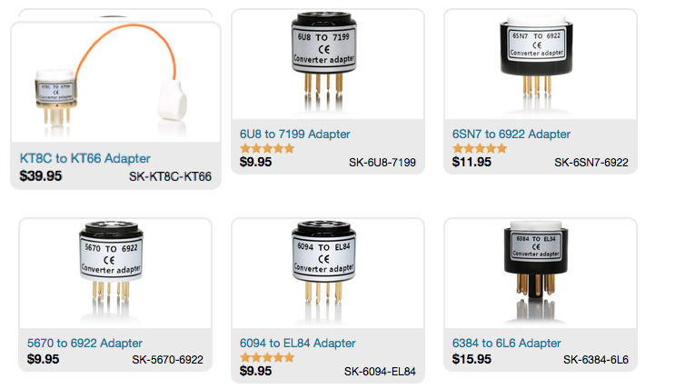

With some DIY effort, they can be matched.Will they mix and match?
One can file out the throats of many "1.4 inch" horns by 1/10th inch (~2.5mm) to match a "1.5 inch" driver exit, but matching bolt patterns is another challenge, horns are not drilled for all drivers.
One can also make an adapter plate to transition from a 1.4" driver exit to a 1.5" horn.
Sometimes an adapter plate is required just to accommodate different bolt patterns.
Kind of like tubes/valves, the "plumbing" requires different solutions:
Anyway, like with tubes/valves, it is a lot easier to not adapt if you don't have to.
