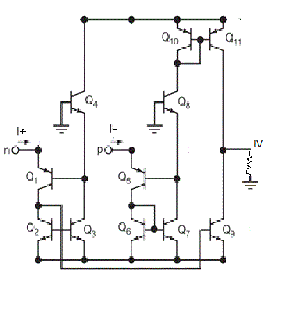

I am planing to build a DAC. it is based on PCM1794 + CDTA (Current differencing transconductance amplifier)-I/V + JFET-buffer.
Has anyone tried the CDTA circuit as I/V? Good sound?

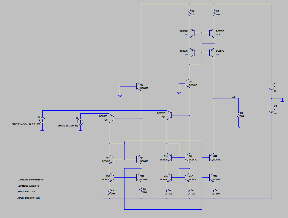

I am planing to build a dac with no op-amp. It is based on PCM1794 + CDTA (Current differencing transconductance amplifier)-I/V + JFET-buffer.
Has anyone tried the CDTA circuit as I/V? good sound?
I think your circuit has been drawn incorrectly.
There are 2 BJTs with 'floating' bases.
PS, it's worth putting this in Ltspice and see how it goes.
For the PCM1794, the DAC OP Z is pretty high, >= a few hundered k ohms,
so that is working for you, linearity wise. All the mirrors are working against
you, linearity wise and noise wise.
I've built a lot of grounded base design I-V's and when done right, they
sound really good. Devil is in the details.
TCD
T
Here is a LTspice sim, and I got a thd of -90db.
That's better. 🙂
I suggest doing open loop circuit sims at 10kHz or 20kHz. This will tell real
story of linearity when all the non linear capacitances come into play.
Also you will need to take care of OP offset.
Having said all of the above, this circuit will probably sound quite good, maybe
really good.
PS, you also should account for DAC OP Z. In the case of 1794 I use 200k or so.
Apparently it is even higher than that but 200k is safe. It will affect the distortion
to some degree.
TCD
If the best SQ is your aim don't just sim for THD, also check PSRR by setting the supply to produce an AC voltage (with the source turned off) and sweep it across the frequency range monitoring the output.
<later> Since you provided the .asc I ran a quick check - the basic PSRR is fine, worst case about -67dB @20k on the +ve rail. -ve rail is better. Next step is to check how the circuit modulates its own supply rails and turns out that's not quite so good, there are very likely changes you can make to make the current draw more invariant of signal. But listen to it first before going on to that. I agree with @Terry, it'll probably sound very good.
