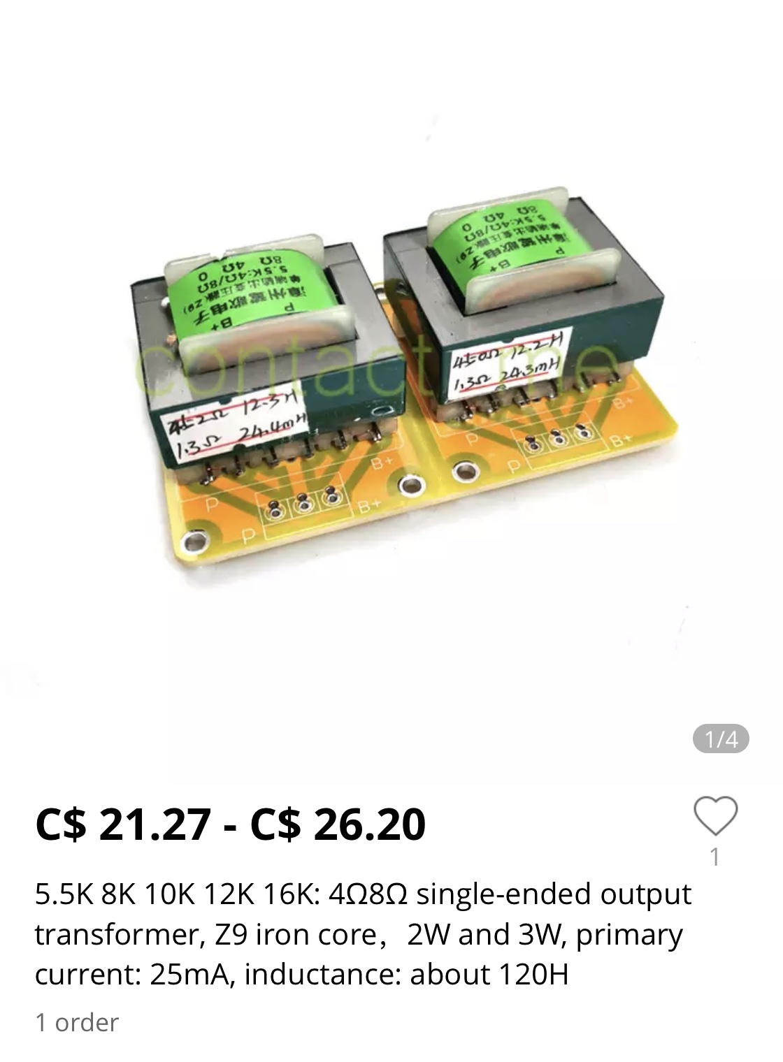

The 125ASE is $53.48 CAD. That is $120.86 CAD for a pair including taxes. That is mostly why I haven't already ordered the 125ASE. I purchased the small black ones that are pictured above for $44.37 CAD delivered.

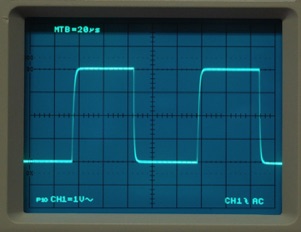

Below picture is from Hammond 125DSE on the left and 125ESE on the right with 10KHz square wave, we all know which would be better for high-end.
Now compare that with 2nd picture - Tube/OTL amp output signal on same 10KHz - just so smooth without any ringing.

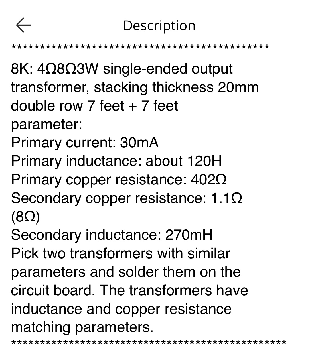

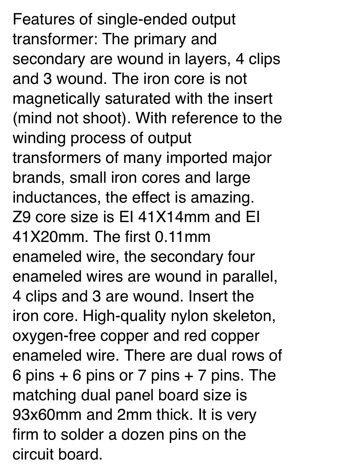

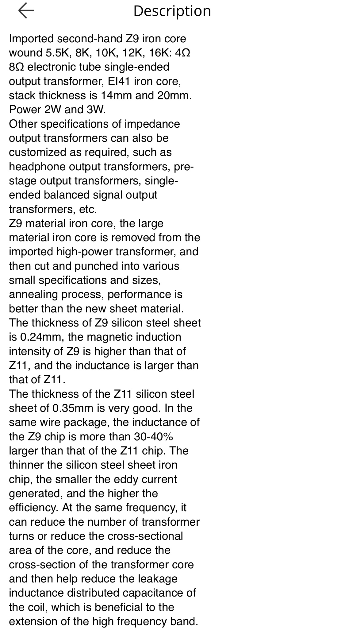

Depanatoru: I already have the black ones pictured in post #57 of this thread, they are 5K: 4/8 Ohm 3 Watts and are described as being “3 clips, 2 wound”, and I have another pair on order. I attached the screenshots of the description for the ones on order. They are the 8K:4/8 Ohm 3 watt, and are described as “4 clips and 3 wound”.
Interesting, in the text they describe as 120H of inductance but on the transformers is written 12,3 H. I would say - there is no way that they have 120H on EI41 core!
Yes. I saw that as well. I was more concerned about the winding geometry than with the inductance because of my 630 HZ crossover point. I’m not sure exactly what “4 clips and 3 wound” means. Does that indicate that there is some sort of interleaving/segmenting done in the winding of these OPTs?
I have attached the rest of the description of them that I missed in my earlier post.
