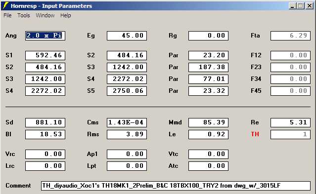

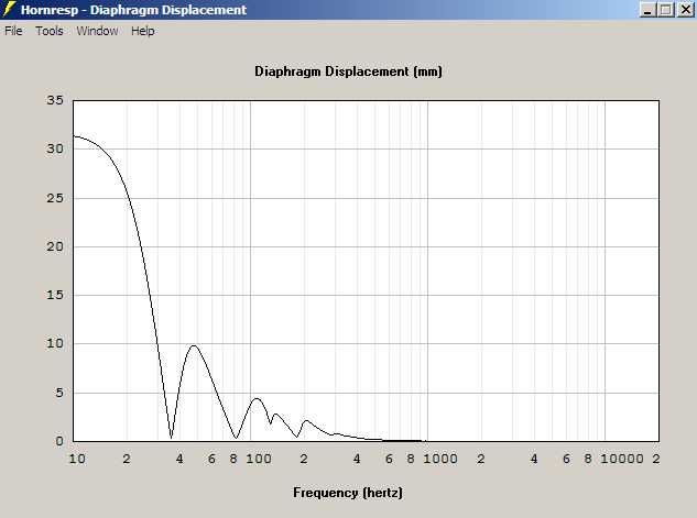

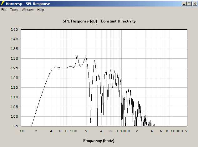

As jbell is bringing up the "SS18" maybe I should add to what I said in Post #22: if you put your 3015LF into Xoc1's design for an 18" woofer you'll have a very nice TH. Naturally, it'll be bigger than the SS15 but it will reach a little lower. By the way, in that big a box don't run the input into the 3015LF past eg=45V with the 32Hz/24dB/octave LR high pass that jbell recommended in Post #19, at that input level the speaker just exceeds Xmax (on paper), and as weltersys already pointed out any additional input power will not buy you anything (well, maybe distortion, torn diaphragm....).
I'll attach some Hornresp screen prints:
