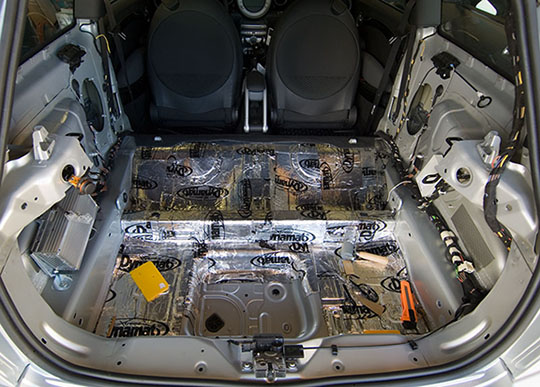

This is going into a 2007 Mini Cooper. You can see the factory amp in this photo. I don't have that amp because I ordered the base system knowing I would upgrade it. diagram of amp location
You can see the upgraded amp looks a little tall but squat. I don't have dimensions unfortunately.

The perfect space is under the passenger seat IF there aren't electronics in there which ours has (DSC) Not much room under the drivers. Hiding it where the factory one is would be perfect. I keep searching but I can't find dimensions. I did find this but can't make out the part number. hk amp
Just found the dimensions of the factory H/K amp:
"Just measured, 7.5" long, 4.5" high, 2.5"deep, mounted on frame. No more depth available, but plenty of room on the other dimensions."
I would imagine he means that the height is what he calls "deep"

Looks like his dimensions may be right. Here's a shot of the amp. Very strange looking dimensions

Yeah, kinda chunky, but not unusual for a stock amp. It *does* look like the same space is available (at least without the trim panel) on the passenger side if you wanted to go with two 2-ch’s.
