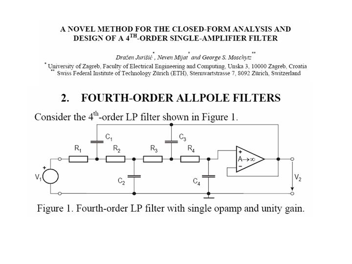

I recently started to study 3rd and 4th order active filters built with just one opamp. I would appreciate any advise on these topologies. I thought this topic fit Lynn's search for better sounding active crossovers, since expensive discrete JFET and tube amp designs have been discussed. A one amp filter could sound better than a two amp filter.
