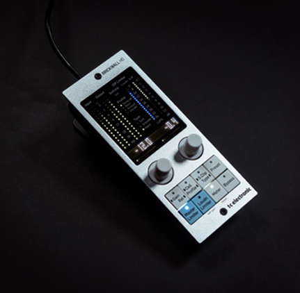

If you want something more easy to implement, you might consider this:
https://www.tcelectronic.com/product.html?modelCode=0815-ABX
Using it's optional hardware controller (and a dB meter..) you could "dial things in" at your 11 foot position.
TC Electronics has been making great sounding gear since the 1970s.
I have no personal experience with the Brickwall HD Master Limiter, but never have been disappointed with any TC gear I've used or owned in that time.

Music file playbacks usually with JRiver, so my pc feeds audio via USB to my DAC. So connect this limiter to another of the pc's USB ports and JRiver can access it as a plug-in?
That's just crazy. Fitting a limiter to thwart dynamic peaks on a horn system.
