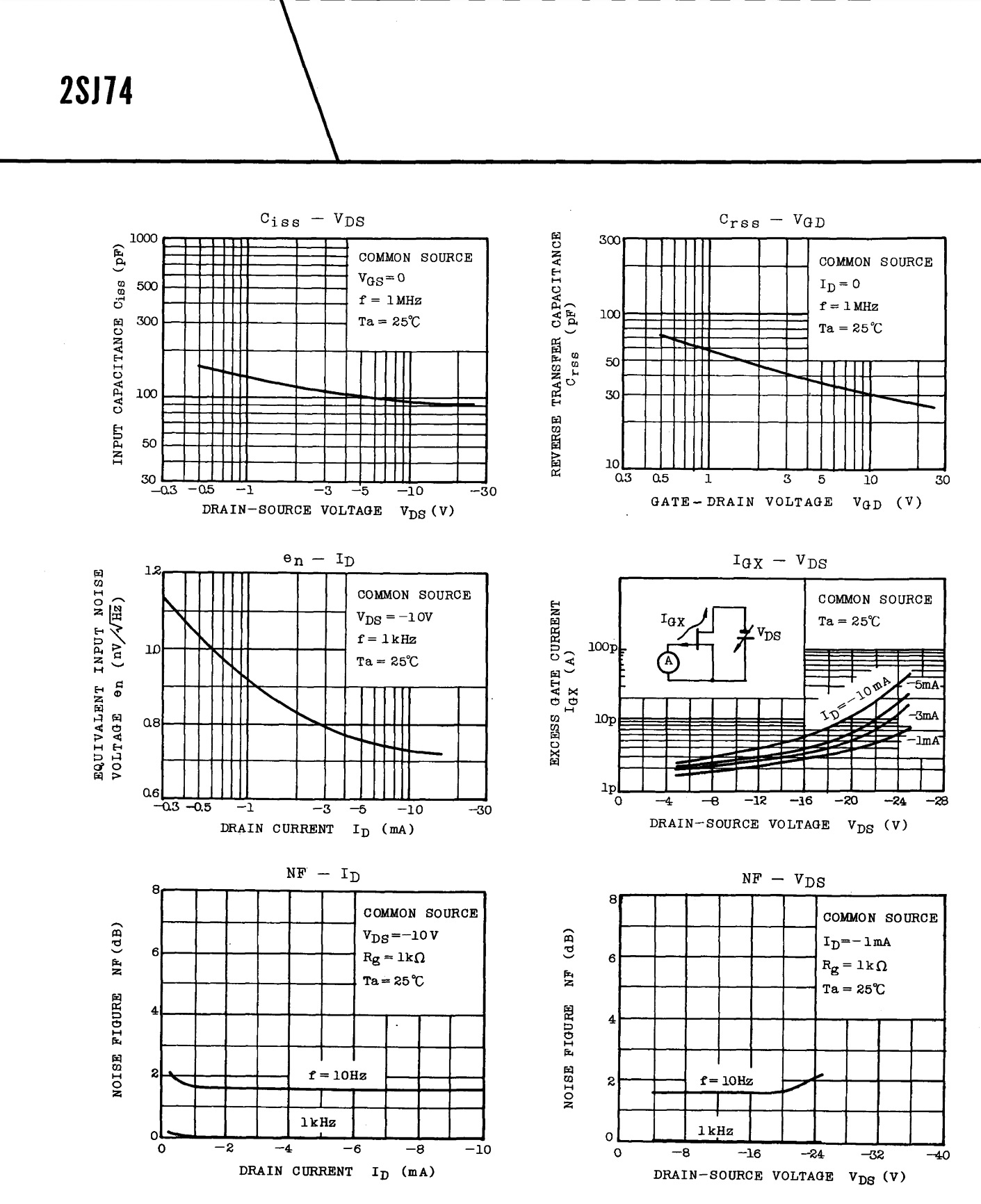

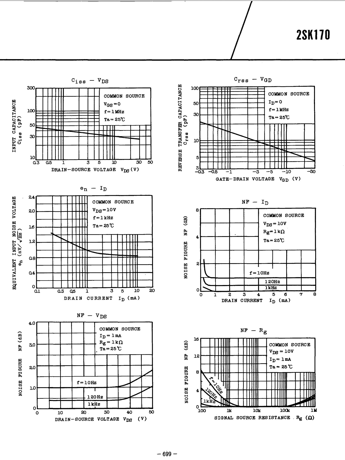

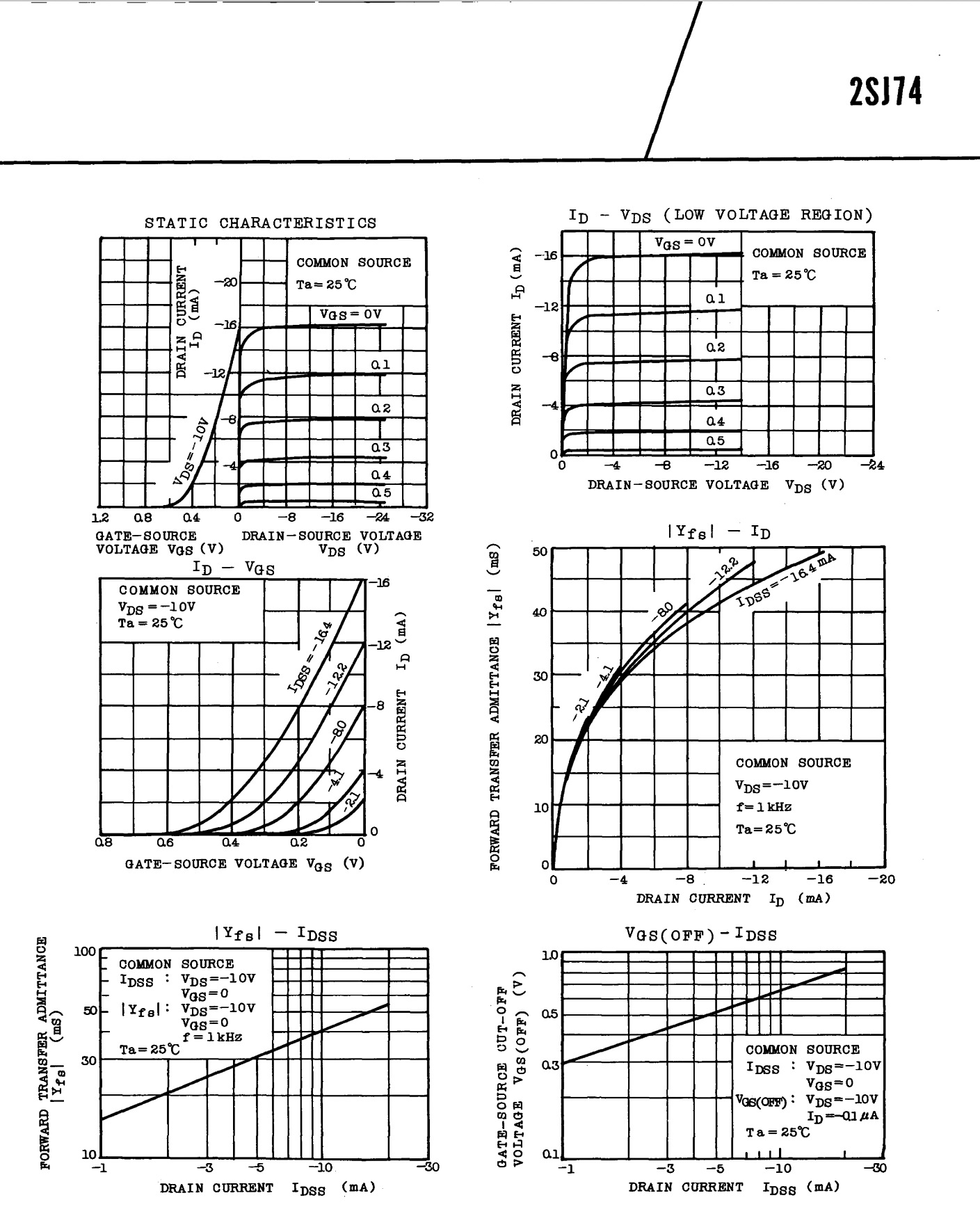

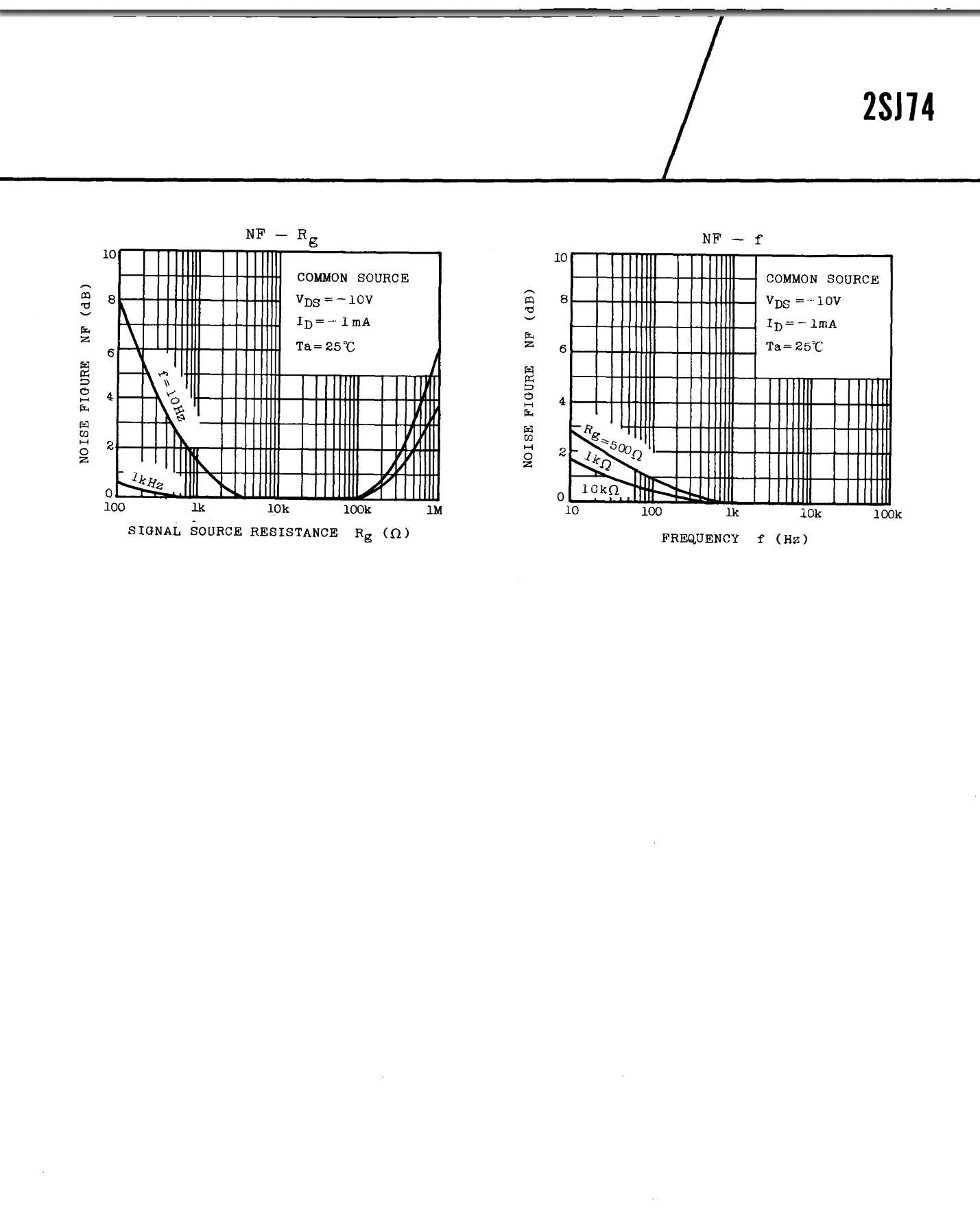

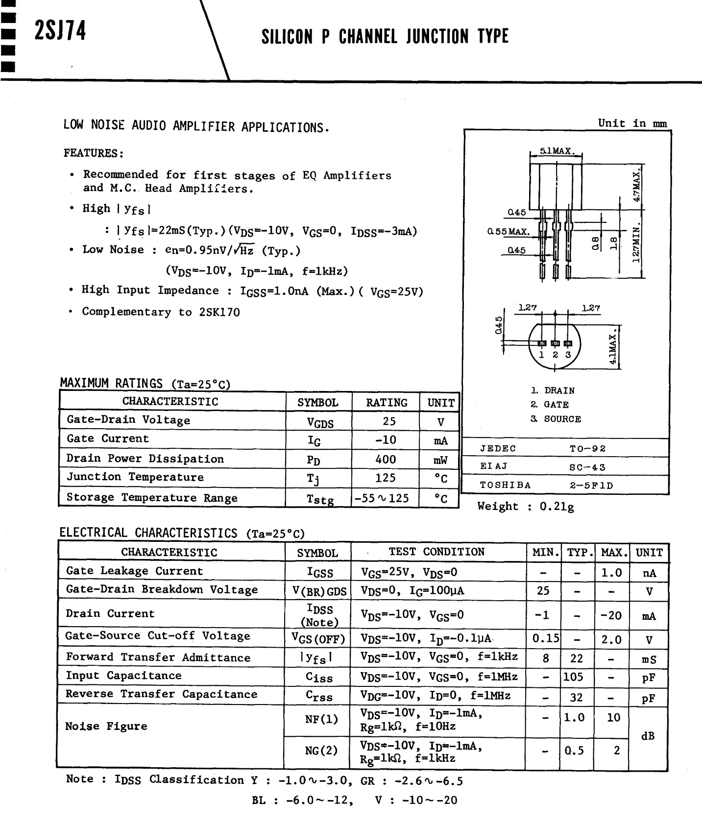

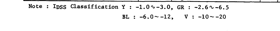

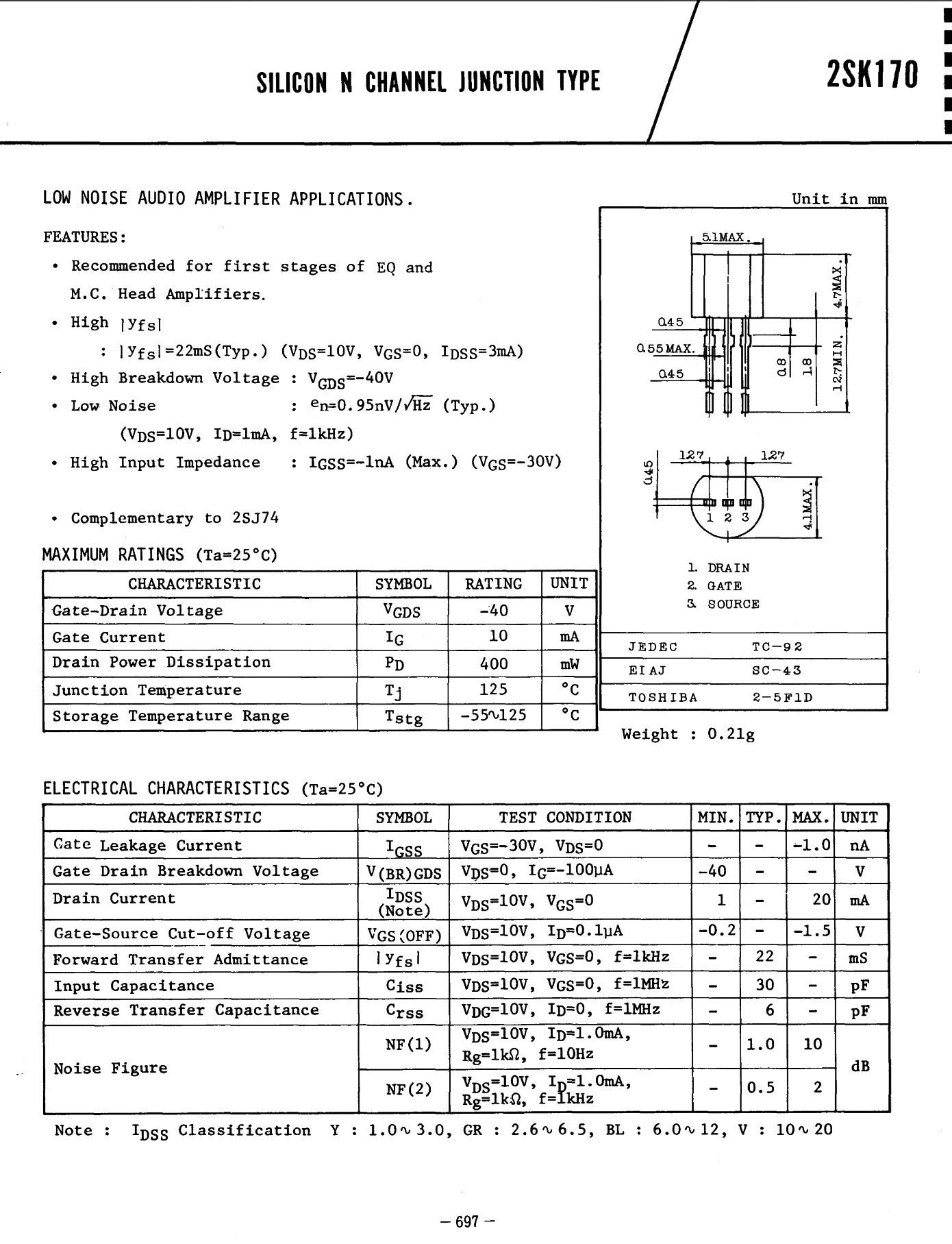

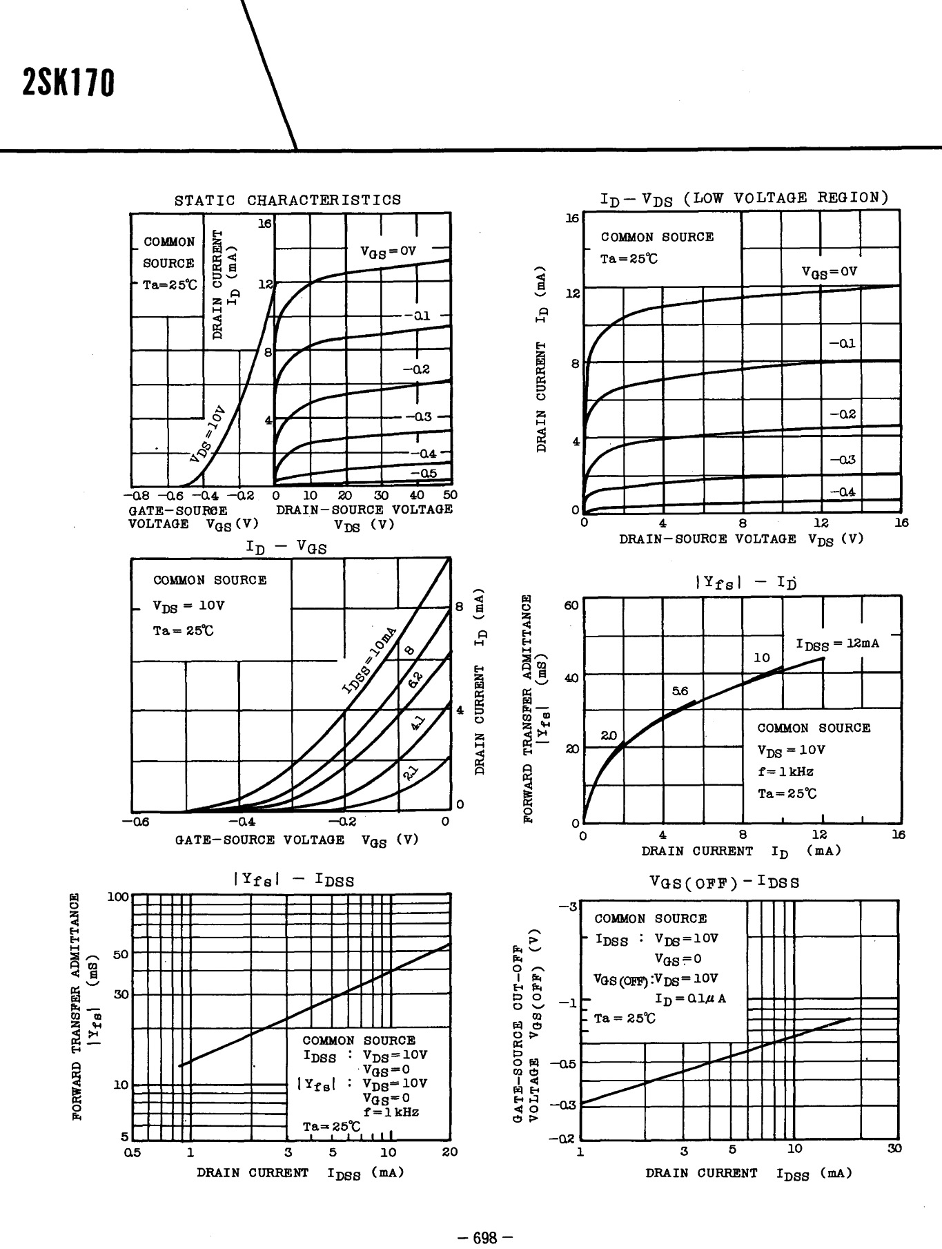

In 1983 Toshiba data book show all jfets grades: Y, GR, BL, V
I guess " Y " grade Idss= 1~3mA is rare....
this was used by Mr. Hiraga in original " Le Monstre " 8 watts amplifier
source : http://www.rsp-italy.it/Electronics...ents/Toshiba Small Signal Transistor 1983.pdf

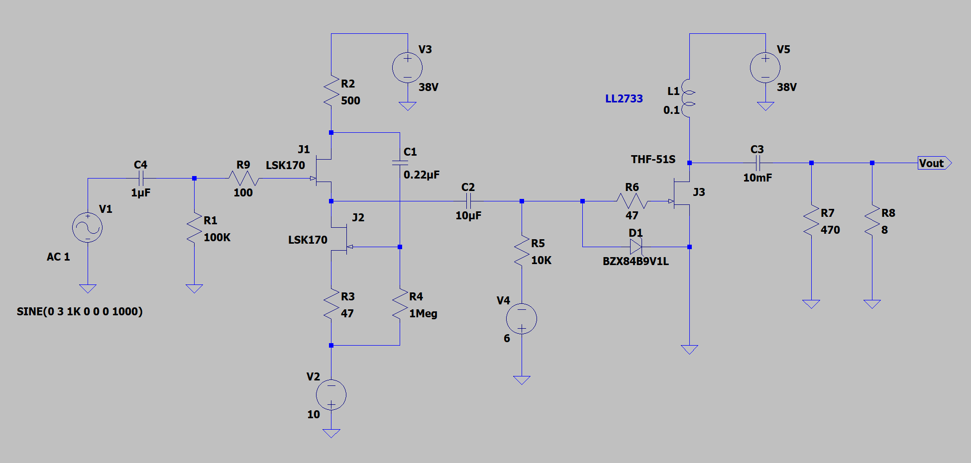

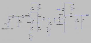

Thanks for the measurements Nelson. I came across Borbely's article earlier this week and had mentioned it on another thread, what timing, just as you said this was my introduction. I was in search of a single-ended JFET buffer that could drive the input capacitance of the THF-51S. Good to know lower Idss parts are on the table.
I hope this isn't too off topic, but I wonder if you have any experience with Borbely's JFET spin on the White Cathode Follower. Output impedance of this buffer is quite low, 2.3ohm as measured by Borbely and 4ohm in my simulation, I am planning to breadboard it in a THF-51S design, something like the below. This is my first time designing with SIT, so I apologize if I have overlooked some error.
