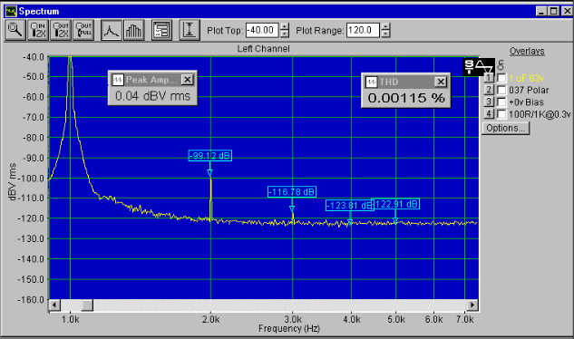

My attempts to manually sum individual harmonics values from Bateman's graphs into THD have all so far yielded THD figures somewhat close to the ones Bateman published, but mine are oddly all a bit too high. If I use these weighting schemes, I get WAY higher THD sums that are even further off the mark. But for fun, I calculated THD all three ways, to see what the differences would be.
SUM TEST 1
Bateman's published THD (calculated by Spectra 232Plus software): 0.00115%
...................dist.............distortion ......1937 n/2......dist. factor....1950 n^2)/4....dist. factor
# ........... attenuation..... factor raw ... multiplier...weighted '37......multiplier......weighted '50....
H2: ...... -99.12dB ...... 0.0011066% ...... x 1 ...... 0.0011066%...........x1...........0.0011066%
H3: ......-116.78dB ......0.0001449% ......x 1.5 .... 0.0002174%.........x2.25.........0.0003260%
H4: ......-123.81dB ......0.0000645% .......x 2 .......0.0001290%...........x4...........0.0002580%
H5: ......-122.91dB ......0.0000715% ......x 2.5..... 0.0001788%.........x6.25.........0.0004469%
summed THD: .............0.0013875% ...................0.0016318%........................0.0021375%
...............................(1.21x published) .............(1.42x published)................(1.85x published)

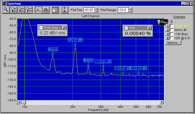

SUM TEST 2
Bateman's published THD (calculated by Spectra 232Plus software): 0.00840%
Not showing my work this time. Too hard to format!
My raw summed THD: 0.0089356% (1.06x published)
Pretty close match this time…yay! I feel confident that Spectra uses no weighting scheme. I still can't figure out why I don't hit it right on the money.

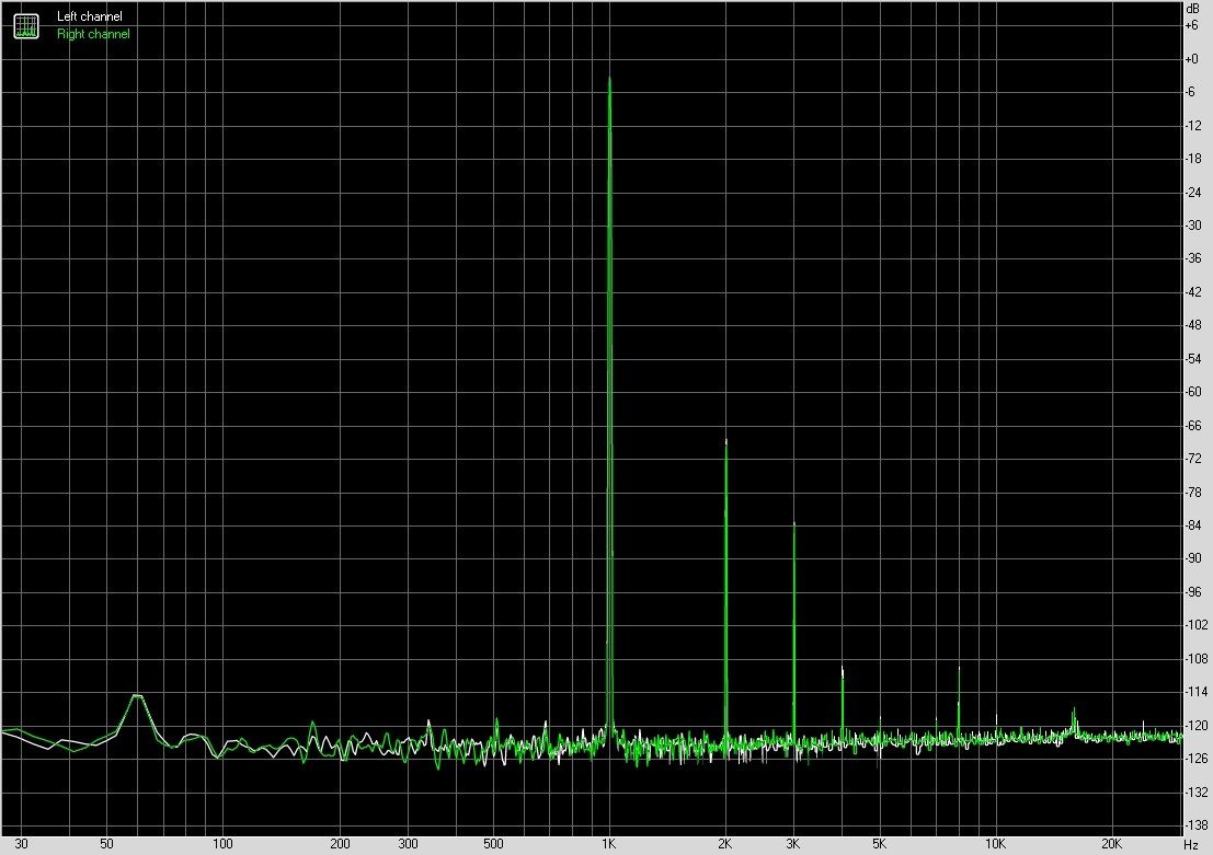

SUM TEST 3
X's published THD (calculated by Rightmark RMAA software): 0.05%
raw attenuation and distortion factor
H2: -69dB 0.0354813%
H3: -84dB 0.0063096%
H4: -109dB 0.0003548%
H5: -118dB 0.0001259%
H8: -110db 0.0003162%
summed THD: 0.042588% (0.85x published)
This discrepancy is very likely due to my imprecise reading of the FFT. Those skinny peaks are hard to eyeball. I guess that RMAA does not indicate exact individual harmonic levels on the graph like Spectra does. Or maybe it DOES use the 1937 weighting scheme!! Yeah right...I just can't read the values.![smash :smash: :smash:](https://files.diyaudio.com/forums/images/smilies/smash.gif)
