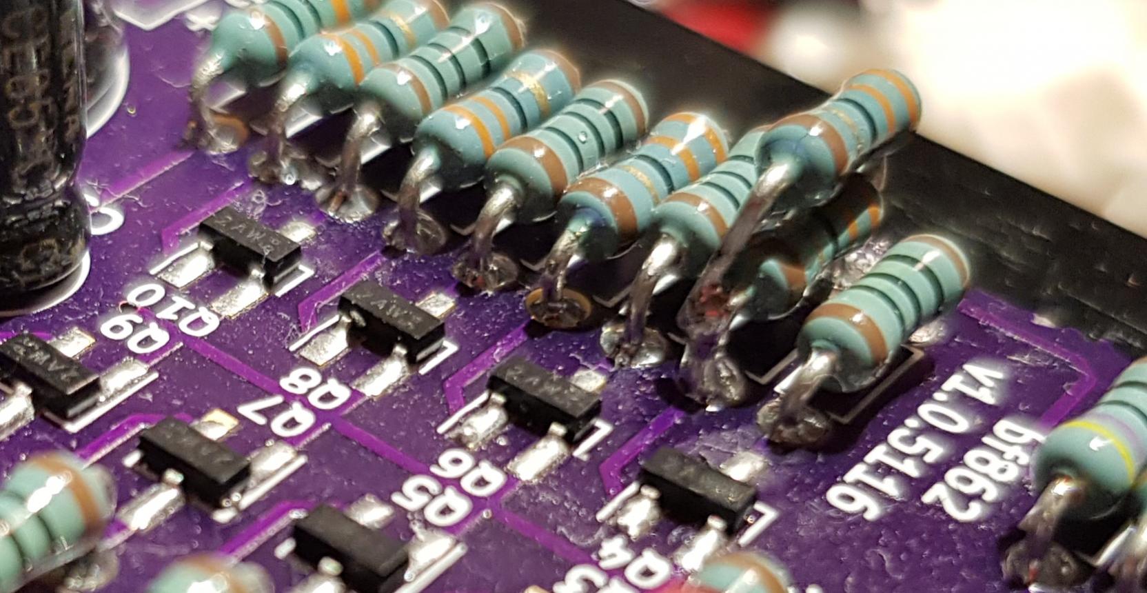

I populated the output capacitors and the extra 33R Takman resistors(on one of the boards as I wanted to test bias in both setups).
I used a 9V battery as power supply.
33R in parallel for 16.5R gave 6.97mA, 33R as is gave 5.30mA.

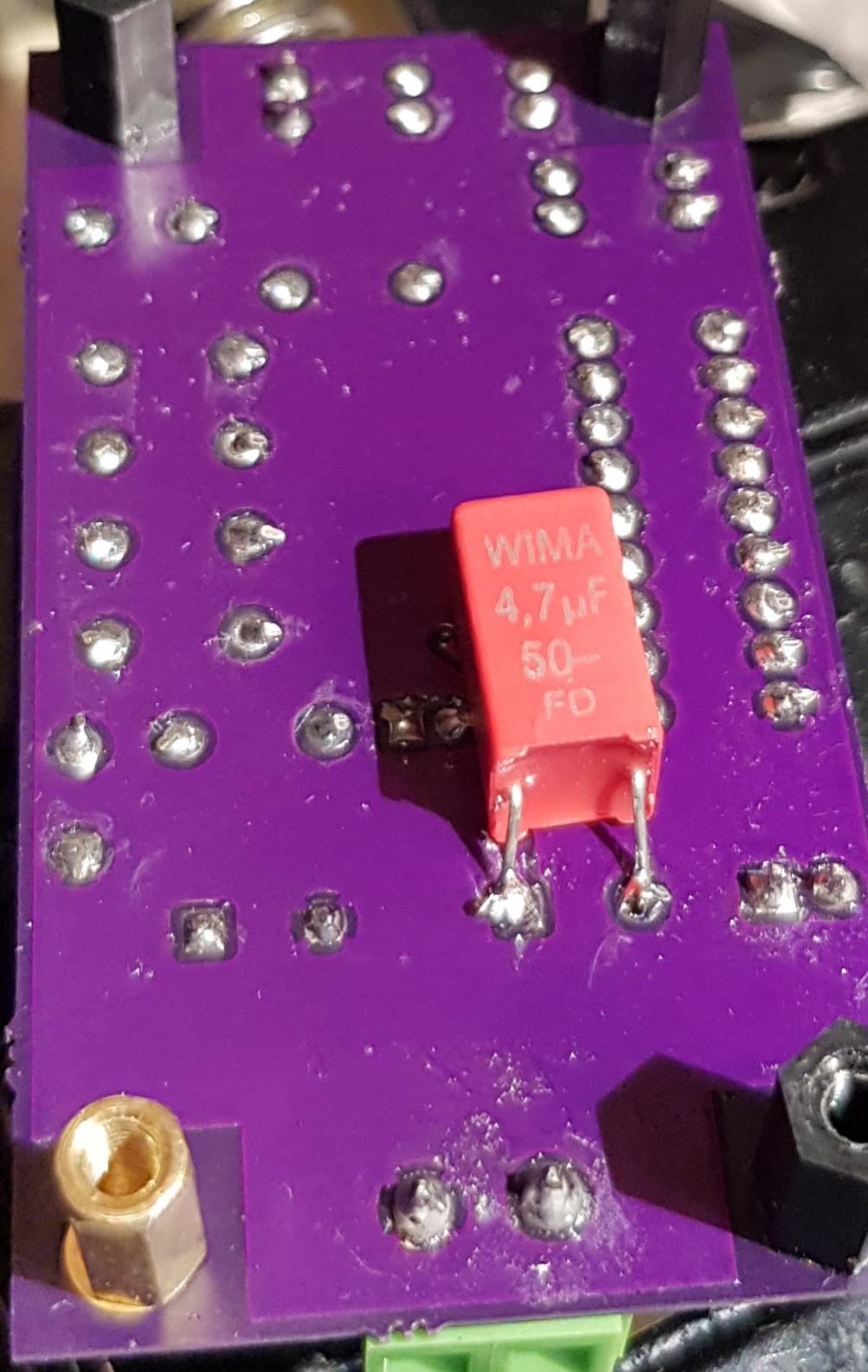

I did put a Wima MKS2 4u7 across each output capacitor.
I got a 0.001mA difference between all output pairs. I'm ok with that result.
The pics show only one, the first, resistor I put in parallel with the ones already on board.
