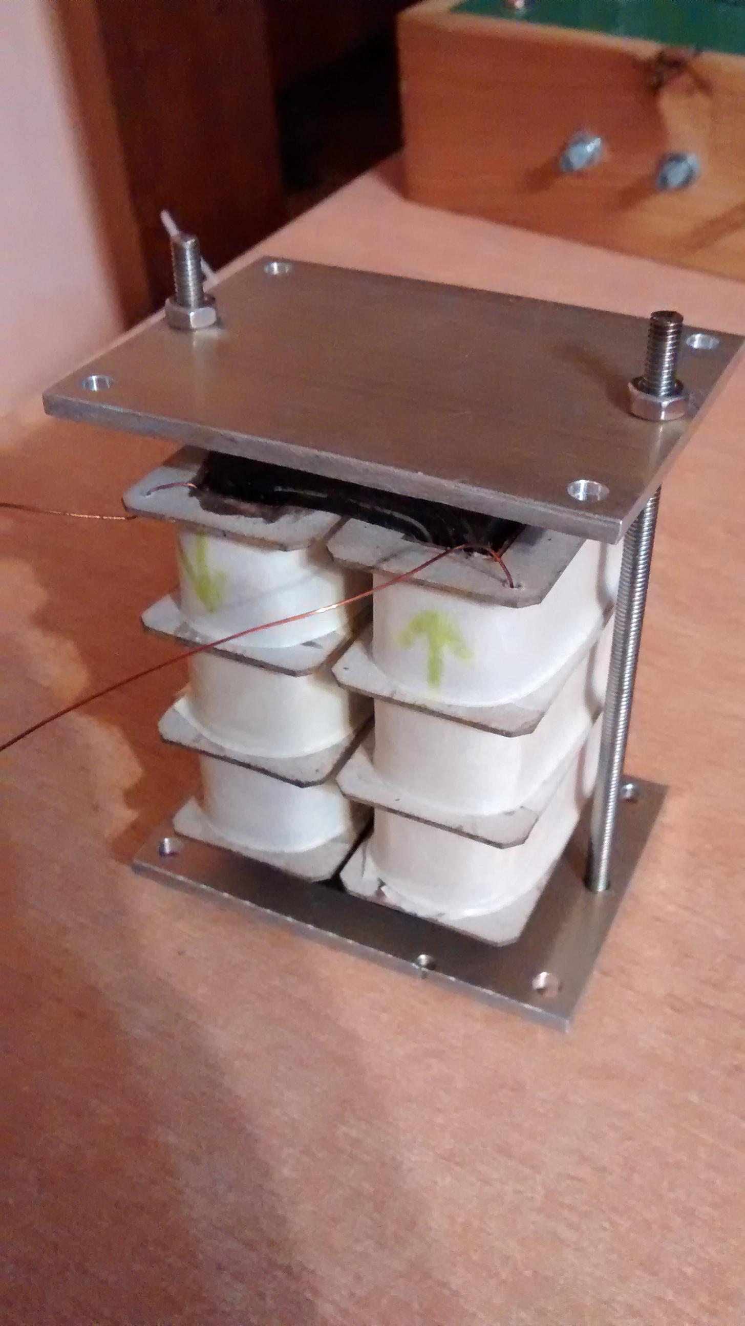

Choke input power supply is a great thing! Nowadays I'm refusing to build anything with cap input and currently I'm making a choke input separate PSU for a DAC + tube preamp - 7 separate transformers and 11 chokes in total - it's heavy! 😀
There are some "underwater stones" I would like to share though:
1. Sometimes very high rectifier PIV is needed, especially if the choke and capacitor following the choke are high value and the sum of the Rdc of rectifier + PT + choke are low. When B+ is applied abruptly (no soft start), the capacitor after the choke is not charged and represents short circuit to ground. When the rectifier conducts, high current passed through the choke as it saturates, while the capacitor hasn't charged yet and still represents very low impedance. When the rectifier goes (off) state, the saturated choke suddenly sees a very high impedance circuit and it tries keeping the same current. Guess what can happen?
The choke has to be with a high insulation.
PSUD2 does help.
2. Critical inductance (Lc) vs critical load (Rc) has to be thought carefully. If the criteria are not matched (Lc too low or Rc too high), the following B+ tends to be above the Urms*0,9 choke input rule and tries to reach the Urms*1,41 cap input rule. Make sure you put a minimum critical load - a bleeder resistor across B+ to ground can help.
To prevent wasting power, I've put a string of zener diodes on my amplifier with a heatsink. Their breakdown voltage is chosen so they activate in a case of a fault (power tube failure for ex.)
3. A choke for a choke input duty can be noisy. It swings a very high voltage amplitude and can see large inrush current, so it needs to have very good insulation between windings and good mechanical strength. Sometimes it needs to be poted. It also emits quite more of a magnetic field than a choke after a capacitor, so it has to be far away from sensitive electronics. C core chokes are better in this.
When having spare time, I'm winding my own "higher end" on double bobbin single C core, splitting their bobbins to at least 6 sections for low parasitic capacitance, so that less crap goes into the circuitry and so the choke has a higher self resonant frequency, preferably above the audio band. There's a photo of one of my chokes:
Of course the idea of winding the chokes this way is not mine.
Alexander.

Alexander thanks for sharing those experiences and observations. That choke looks awesome - would love to do that. One day.
The PSU will be in a separate box from the phono stage and I'll be mounting the chokes to maximise distance from each other and at right angles where possible, diagonals where not. I have bleeds in both the psu and the Phono stage, the latter being used to elevate the heaters for v2. Both b+ and b- should see around 34mA.
Alexander - did you sleeve your interconnect and terminal wiring to the choke ? One terminal wire in the photo looks to be very close to the core.
Hello,
The wire is wound and secured, to not go any closer to the core. The distance between the wire and the core is 1mm of air. The other potential wires on the bobbin have 1mm distance of bobbin material.
