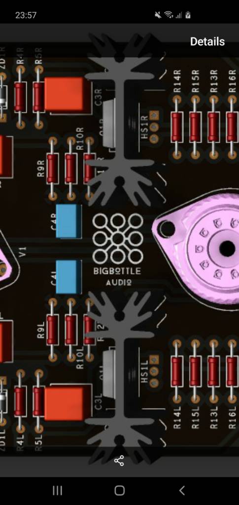

Dropping in to say hi and give a sneak peek! PCB is coming along nicely! Parts can be mounted on top or bottom to allow tubes to stick through a chassis. JFET footprint will accept an SOT-23 SMD or TO-92 through-hole device. Output cap allows for just about any flavor cap your heart desires.
Haha, I love it!!!Dropping in to say hi and give a sneak peek! PCB is coming along nicely! Parts can be mounted on top or bottom to allow tubes to stick through a chassis. JFET footprint will accept an SOT-23 SMD or TO-92 through-hole device. Output cap allows for just about any flavor cap your heart desires.
How cheeky is this....
![Screenshot_20200107-235743_Gallery.jpg Screenshot_20200107-235743_Gallery.jpg](https://www.diyaudio.com/community/data/attachments/728/728774-82a4a9be571e3805bc895cc1dab2442b.jpg)
You and me both!Can't wait until the final version is ready
I am sure Craig is grafting on this and we'll have a prototype soon!

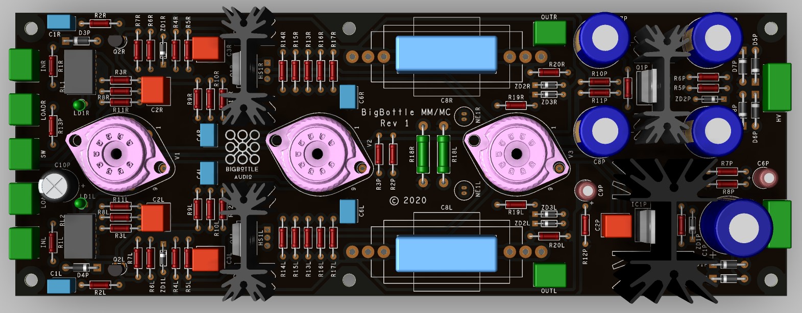

I think we may have a finished product here, which obviously needs a test build before releasing them into the wild!
I love the work Craig has done and once Alan gives this version the thumbs up, I will build one ASAP and see how it looks. #Exciting!
Here's a bit of detail and some pictures.....
A "mild to wild" amount of different sized output caps can be used on the Phonostage, thanks to Craig's creativity with the layout.
+ & - indicators are now on the Capacitors and what else is rather cool is..............you can now populate the PCB on either side
- Relay only on top
- Tube sockets only on top
- SOT-23 JFET only on top
- TO-92 JFET rotated 180
- TO-220 devices rotated 180 and on other side of heatsink web
The FET will have a dual footprint allowing the use of surface mount BF861C or an equivalent leaded version. Unfortunately, we are yet to find a perfect suitor. I will endeavour to find one as this will help those who are new to soldering. If anyone has a suggestion, we'd love to hear it!
Top side:
Bottom Side:

Top side:
![1bc75ea5cbd058ed3688ec1db701f5c4.jpg](https://uploads.tapatalk-cdn.com/20200117/1bc75ea5cbd058ed3688ec1db701f5c4.jpg)
Bottom Side:
![ffd66a6baade857aaa266725d07b5069.jpg](https://uploads.tapatalk-cdn.com/20200117/ffd66a6baade857aaa266725d07b5069.jpg)
I am mega excited to get one of these up and running!
I was looking at JFETs and J211 might work ... we will have to run that by Alan and see what he thinks.

A few ??? What type of tubes? I see ECC83 and PCC88. What's the 3rd tube? What about PSU. I see it's mentioned it's on board... what are the specs of trafo?

It's 2xPCC88 and one ECC83
PSU is contained on the PCB, and the Transformer is:
165V @ 0.1A
9.5-0-9.5V @ 1A
There is a Chinese R Core or similar on ebay which is OK for the money. I get mine built by Toroidy.pl

Can the PCC88 be the 6v version - 6DJ8 (ECC88)? and can the ECC83 be the Russian variant 6N2P or even the lower gain version of 12AX7 - 5751?
Nice! Yes the wife can't live without her vinyl collection. It's always a bonus when I say "I can build something that will make your vinyl come back to life!"
ECC88 - No, PCC88 only.
5751 - May not have enough gain
6N2P - No
It may seem like a really odd choice of valves but it was done deliberately. This combination of valves give just the right amount of gain, so low noise and offers really low Millar Capacitance.
One or two of the PCBs have been modified to accept other valves but personally, I think we got the right combo.
Obviously, if anyone chooses to modify the PCB, once in their possession, that's entirely their prerogative.
