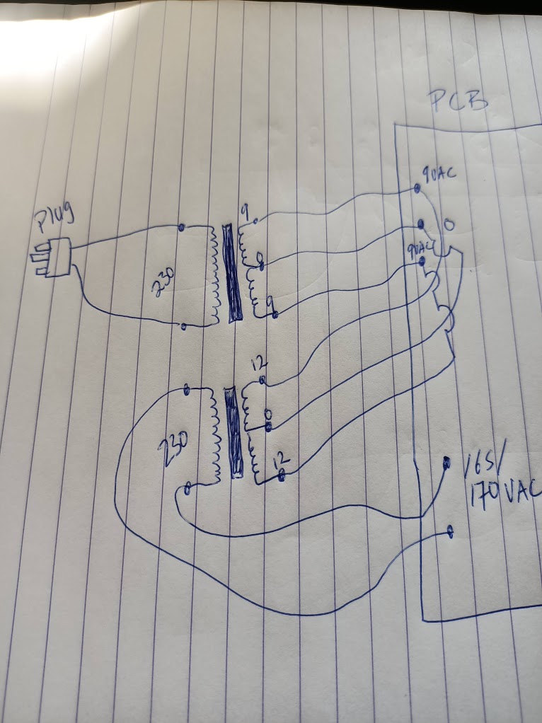

Still I cannot seem to find a single thing I did wrong. Quadruple checked component values, made sure all the solder points are good and there's no shorts anywhere.. I'm just at a loss
Well, I figured one more thing out.. I had sort of partially blown a fuse on my AC line.. Very strange behavior. I measured the AC on my power transformers, and it was going up very gradually.. Which seems odd, so I pulled out the fuse and while it looked okay it measured 160K ohm.. So I'm guessing what happened is that there was not proper AC applied to the circuits when I powered it up this last time. I am surprised it blew up in such a spectacular fashion though. Would little or no AC cause something like this to happen?
