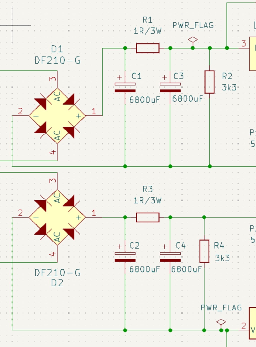

After reviewing several designs in this forum I've come up with the following:
I've seen bleed down after the CRC as seen below.
I've seen the bleed down replaced with a LED.
And I've seen a bleed down with the LED post regulator.
For the sake of simplicity I'm thinking that the LED in place of the bleed down is
the 'best' solution because it serves two purposes. It serves as a bleed down and
a power indicator?
Dan

I often use an LED in that location as a power indicator even when there's no need for a bleed path. In fact, I like letting a single component serve a dual purpose in my electronic designs, not just in audio. It's not just the saving in cost, it's the elegance.

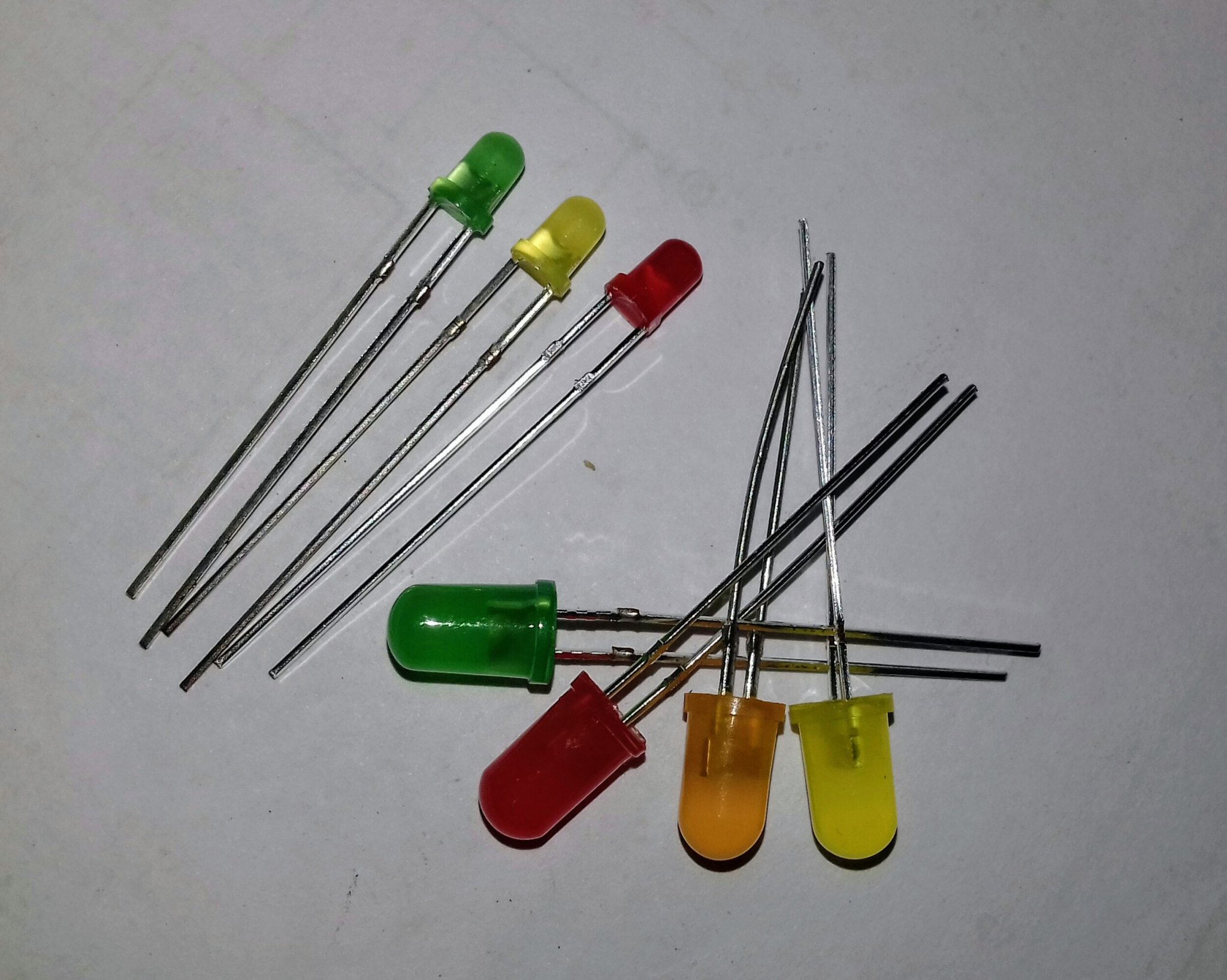

Watch the LED current level. You haven't specified the PS voltage. At 50V, a 3.3k resistor will push nearly 15mA through the LED. That's about the max current for a reasonably long life with a 5mm LED.
If you connect a 1 Watt resistor between the voltage regulator's output pin and ground, whose resistance in ohms is less than or equal to (38.4 * RegulatedVout), it has several effects:
Of course, this assumes your transformer's ratings can accommodate an extra 26mA of current per rail, and your thermal budget won't be exceeded by the extra heat dissipation
- bleeds the regulator's output voltage down to zero at power off
- bleeds the regulator's input voltage down to ~2V ("dropout voltage") at power off; a voltage not dangerous to service personnel
- guarantees the regulator's output current is AT LEAST 26 milliamps during operation -- thus the pass transistor inside the regulator is running at a reasonable current and operating at a comfortably high gain (gm > 1.0 siemens) during operation, thus its regulation is excellent and its output impedance is low

With a modern high-efficiency GaN LED (blue or green), 10mA of current will result in a brightness level that will practically put out your eye. 10 mA is more in the line of less efficient LEDs like the GaP variety. If I were running a GaN led as an indicator, II would give it 1-2mA instead.

Adding an LED in series with the bleeder resistor is fine, but does have two drawbacks:
Tom
- The current through the bleeder will be limited to whatever current the LED can handle safely (or while not turning into a supernova) which may not be enough for the application.
- The forward voltage of the LED will limit the final voltage across the supply capacitors to a few volt. Given enough time the voltage will come down due to leakage through the LED, but that could take quite a while (hours). That may not be acceptable in the application.
Tom

That's why i didn't mention anything about LED's in post #5 . For smaller Class-b amps LEDs (as bleeders) maybe fine but for Big Class-A, definitely not. It will take hours to fully discharge the bank."Adding an LED in series with the bleeder resistor is fine, but does have two drawbacks"...
