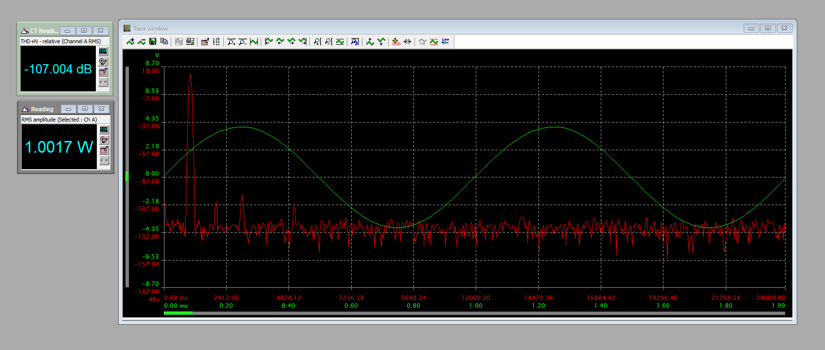

If you have a crappy DSP system I would agree. But I developed one that could rival any system on the market in 2 channel unity mode hooked up to passive speakers. But also has the ability to do DSP up to 4 channel. So that’s not the situation I’m in.
Total system THD+N here. Beats pretty much everything else out there by at least 30dB.

I make my own DSP amps.They use Ravenna AES67 audio over IP so unlimited units can be clock synced. Each one has 4 channels of DSP (3 Purifi 1ET400A modules inside, and an XLR sub out for a powered sub) So good for a 3 way and sub each. Finally got Trinnov and Storm Audio on board with the Ravenna. So with their 32 channel processors combined with my DSP amps up to 128 drivers can be actively driven in a single home theatre. With audio quality on par with the best of the best 2 channel dac’s and amps to each driver. The amps build into the wall and have fibre optic Ethernet inputs. So there’s very short speaker wire runs to the drivers.
