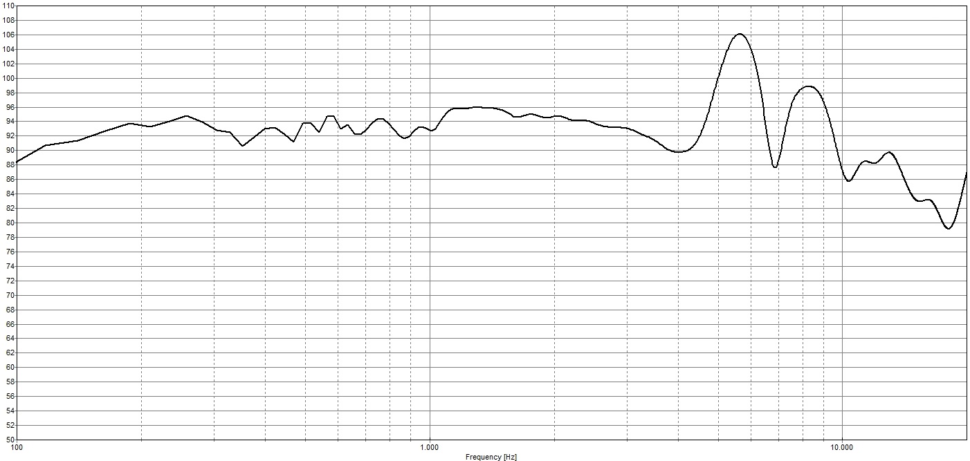

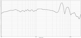

That is prototype

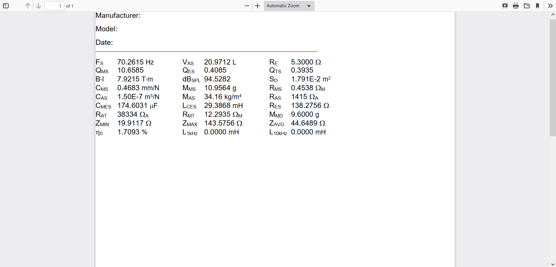

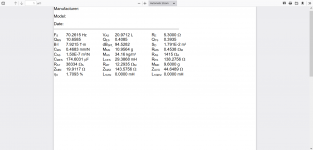

You are right, a M74D would be very very expensive, think in terms of €3.5-5k/pcs but possibly well worth it together with the T25D-6. Either S.S 21WE or the 8" Purifi. I was checking the non-linear distortion and IMD of the PTT6.5W08
which shows a significant improvement over their first release which was the 4ohm, the 8ohm's IMD is on par with the 18WE, so well done Purifi. No third party evaluation of the PTT6.5M0* but Cms improved (lower compliance) and
sensitivity went up, so great stuff happening over there.
