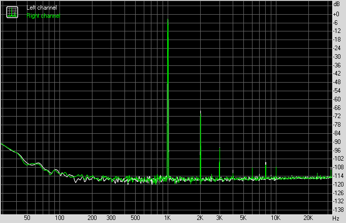

It sounds great - just like the pocket amp but desktop size. If I had lower impedance headhones I am sure there would be a more audible difference. Here is the new FFT wit power supply rail dropped to 16.5v. I just need to work on removing the broad low frequency noise now (inaudibe). Bias at 16.5v is 93mA. Local heatsinks almost big enough now.
Adding a larger CRC and cap bank seems to have fixed everything. Here is an AC mains powered amp with no shunt regs or cap multiplier - just SMPS and DC step up followed by CRCRCRC filtering that has -114dB noise floor with no ripple.

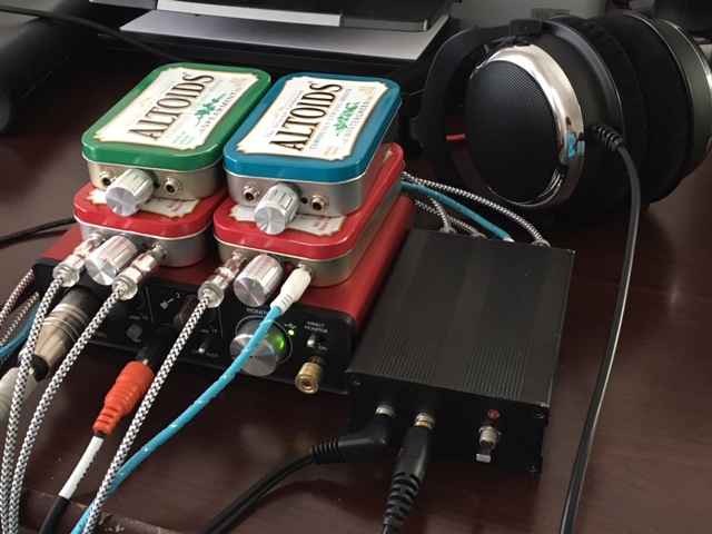

AB Testing for QC
So many amps, so little time. This is how I test new amps to make sure they are up to snuff. An AB switcher box is really helpful to allow instantaneous switching so that if there are any differences - they can be heard easily. In this case I am using the AB box as quality control for a production item to ensure it sounds the same. Three Pocket Class A amps up for testing vs the standard known good reference.

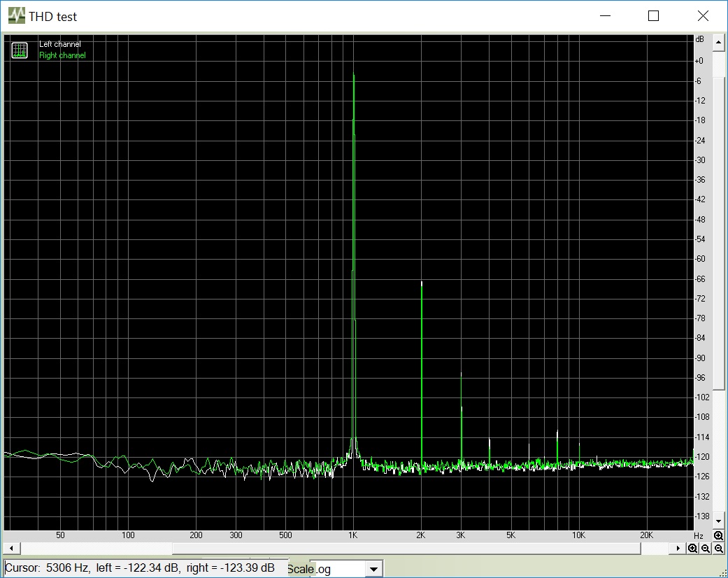

This chart is fascinating to me. Do you have FFTs for each of these amps as well? It would be cool to be able to compare the amps by visualizing their distortion signatures. THD alone doesn't paint a very rich picture. I'd like to see FFTs of the Super CMOY and ASKA's CFP especially, but really I am curious about all of them. It may help others decide which amps they want to build too.
Yes I have the FFT's. I will post as soon as I get a chance. You will see that all of my (and Aksa's) Sae Class A amps here have a similar profile (basically set by the SE Class A topology) of having a predominant (about) 90% H2 at circa -66dB to -72dB and the balance of distortion coming in as H3 (about -20dB lower than H2) and then not much else. The noise floor on these amps is very low and flat also.
They will look sort of like the above:
